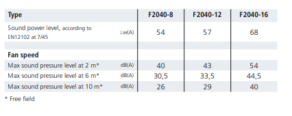

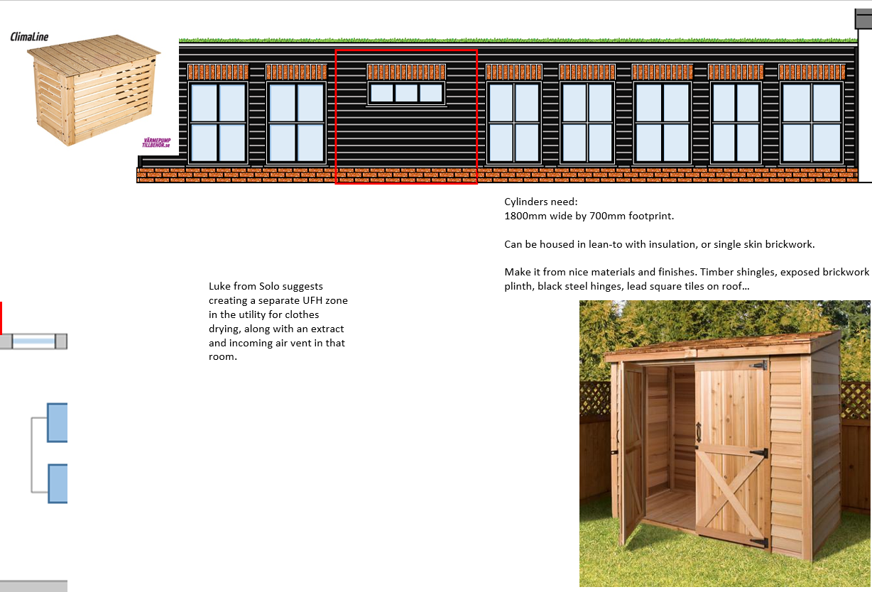

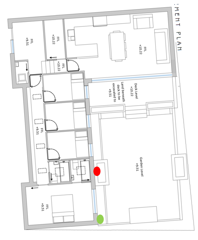

Thanks @Moonshine, much appreciated. Ignore the green and grey blocks, it is one L shaped bungalow with a flat roof. If I opt for position B as you suggest I have a couple of options. The red dot is the obvious place for it, the green is where you suggest: The PD regs for ASHPs stipulate that noise levels must stay at or below 42 decibels (dB) from a metre distance away from any habitable room, including (I presume) the host dwelling. The spec suggests a sound power level of 57db. I am not sure how I can square that spec with the PD regs therefore, unless of course the sound is directed somehow so that despite being near my windows, the actual sound from the ASHP is at or below 42db. Is that how it works in your opinion? Your suggestion of a screening low wall suggests that I can manipulate the direction of sound from the ASHP. Is that so do you think? I am interested in the acoustic enclosures you linked to, thanks. Do you know how they work at all? I wonder if I can make a less industrial looking enclosure to similar effect. I had made these notes some time ago, and would be interested in your views, particularly in whether in fact I would do better to open the doors so the noise can be directed away:

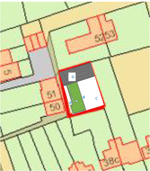

Thanks. At the moment I'm looking at a NIBE 2040-12kw air source heat pump. The spec is: Layout wise, I'm looking at a few options: A. In the alcove. Its within 1m of the boundary but would live inside the timber structure that will occupy that inset section, and provide storage for bikes etc. It could therefore be soundproofed. It would require planning permission there of course. B. On the inside facing wall of the bungalow. C. In the garden, somewhere at least 1m from the boundary. D. On the flat roof. Sounds counter-intuitive, but I wonder if in fact noise would be less amplified there.

I had considered making one using the stuff from recording studios. No idea if that would work mind you. How quiet is yours then? I thought they were typically 45-55 dB?
Anyone tried these? Any good? Expensive? No matter where I put my ASHP it'll be audible to someone, and I'm interested in designing in a sound reducing set up from the outset if it's worth it. I'd be interested in anyone's experience of this technology. Thanks
