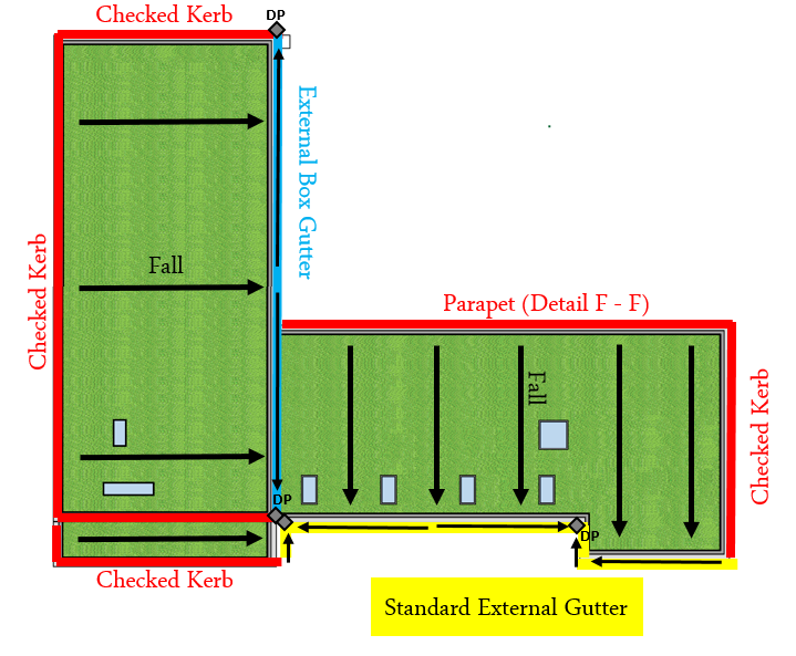

  10. Thanks for everything posted on this so far. Regarding the two great threads that @Ferdinanddug out, my original concern was avoiding exactly the issues that affected the schedule, budget and mental health of @andyscotland! My own roof is 100m2, and so erecting a scaffold structure over the whole lot seems unrealistic, if only in cost terms. I have looked into rubber roofing as suggested. I feel I now have three options: 1. GRP. 2. Liquid rubber roofing. 3. EDPM in sheets. 1. As a DIY option GRP seems fraught with pitfalls, especially in the winter. I have found a series of very clear educational videos and was confident I could follow them, but not necessarily quickly enough to do the job well on dry days between rainy periods, which it seems is what roofers do. Pre-forming the boards as proposed by @SteamyTea is an interesting idea, but requires a reasonably large workshop, which I don't have. One roofer who appears knowledgeable (and expensive) informs me that he rarely uses GRP now, almost exclusively rubber in one form or another. His thinking is that whilst GRP has a nicer look to it, doing it well requires far more care, attention and cost than is commonly allocated, making rubber the better option in comparison. He basically thinks that there are a lot of bad GRP roofs out there where corners have been cut. 2. Liquid rubber roofing seems almost too good to be true. From what I can see, you pre-form the edges and joins as with GRP, then mix up the stuff and paint it on: HOWEVER, a manufacturer I spoke to informed me that the product doesn't like the rain much more than GRP does, and though the rubber is breathable and will eventually allow bubbles etc out, that doesn't help stop problems with bonding. As with GRP, I would be left trying to get the deck on, and the finish too all in the space of one dry period. Possible, but not ideal. 3. Rubber sheet roofing looks good, and whilst this chap appeared concerned about the weather when laying it..... ... it does at least go down very quickly and seems to protect the deck the second you lay it down. I presume I could even leave the sheet sitting loose on the deck as a cover either overnight once I finish the deck, or on the day of the job if rain does suddenly turn up? Any ideas and suggestions gratefully received as always! Thanks

  13. Here is the basic plan, nothing too complex. As @joe90 suggests, I was going to use pre-formed edges etc.
  14. L shaped building with a split level roof, so basically two large separate rectangles each about 50m2. Only other complications are a series of small rooflights.

  16. That's useful, thanks. What size board are you thinking of for that sort of rate of productivity?
