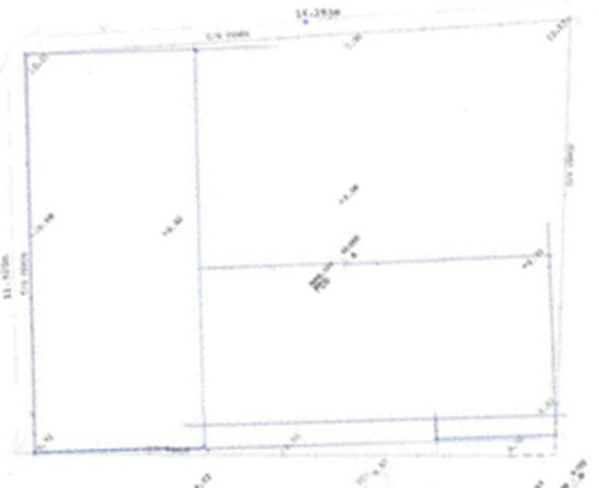

Hi All, Leaving aside the footings themselves (which might be piles, steel screws or concrete trenches), I need to construct two 5m x13m raft slabs as shown in this sketch: From the top down it is: 250mm poured concrete slab with A393 mesh top and bottom, and rebar to SEs design. 85mm clayboard, which will collapse leaving 75mm void. 20mm blinding sand used just to ensure a level base to lay the clayboard on. I will be need shuttering / formwork to create the edges as shown. I have fallen out of love with local groundworks firms who, based on their inability to even quote for work when they say they will, I am not thrilled about employing for anything that matters. Like this. Question is, can an amateur like me create the above? I'm already excavating the area. How difficult is.... Creating level formwork to the edges. What would I use? Timber? Hired road planes? Getting the sand base level? Installing the clayboard? Placing the mesh and rebar in? Accepting the concrete when it arrives? Cheers

@Big Jimbo - No problem fella, cheers. Out of interest, and to round off this thread which has been so helpful to me, these are the relative foundation costs based on the (very limited) quotes I've been able to get: 1. Auger Piles: 38k without muckaway costs. 2. Pre-drilled Driven Piles: 30.5k. 3. Ground Screws / Steel Piles: 15.5k - 20.5k depending on soil test results. (Soil test is only £375 with one ground screw firm, or free from another as they are doing a job down the road anyway). 4. Creative (slightly fiddly) Trench Foundations with cross-ways groundbeams: 7-8k, including digger hire, muckaway costs and concrete. Might be more like 10k if I need to get a larger digger hiab-ed in to my site to excavate the bits of trench that are 2.2m deep. All prices are for foundations only, so they don't include excavating the site down to required level, soakaway, pipes and of course the slab itself. The temptation is to go for the cheapest of course, though a consequence of the trench method is that I'd end up with a ground beam set 10cm into my floorplan (like a big skirting board) to avoid the tree, and given the many benefits of the screws (as you say, great eco-credentials, but also quick, easy, tree-friendly and no threat to the nearby 120 year old cottages which, my neighbour and I know from experience having extended them, have very little by way of footings), they look the way to go. The ground screw firms feel certain they can appease the warranty provider and building control. It is new tech, but mine is far from the first house to use them, so I don't foresee too many issues (famous last words!). I'll start a new topic elsewhere about forming the slab, but as far as the footings go, the options are as above. Cheers all for the discussion. -
