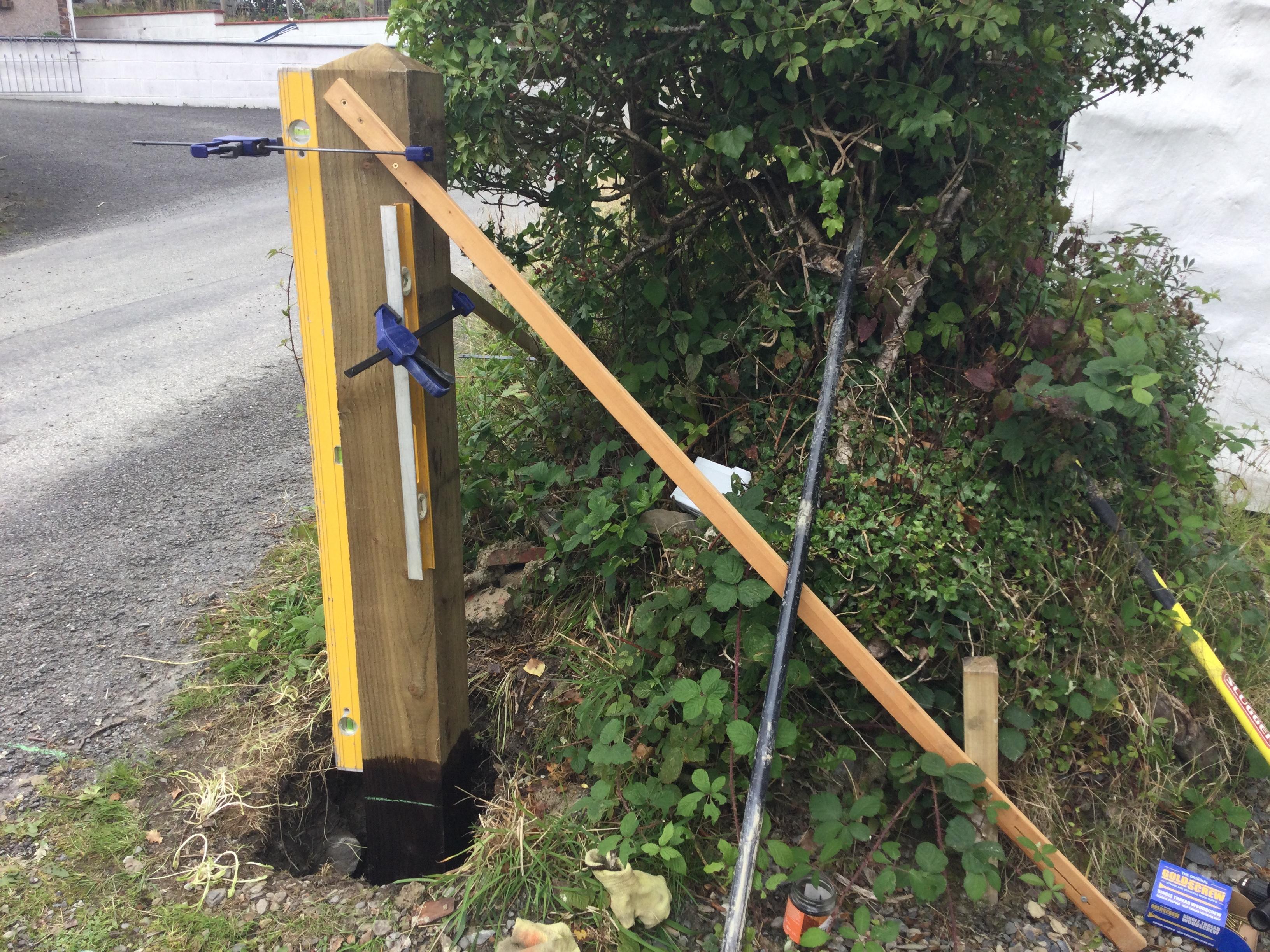

  1. Above photo lower hinge & bracket wrong way round then, I get it now. But still can't understand the top hinge & bracket. Could someone help with my positioning of the post side pins? How far into post they should go? Is this correct? The shaft of it will stick out the rearside of the post.. but Id have a gate sat with minimal gap which I guess is better than a big gap. Is this the idea here? thanks zoot
  2. Im stuck before I even start! I cannot see how the top post side pin rod thing can be adjusted. It doesn't seem to tally with my chaps explanation in the place I just bought them, as he drew a continuous threaded rod here I could visualise could be adjusted (ie I visualised a similar thing to the lower hinge two sections, which can be seen clearly how they would adjust). Omg.
  3. Hi markc, helpful thanks that makes sense. From clips, it's lump hammering in of the hardware into the posts which seems to be the most 'pressure' Im going to exert rather than the drilled holes. The hook whatnots for eg. The top one especially. I'll go & see of these adjustable hinge ' sets' are long bolts tho instead of a whack-in hook thing, if so it takes out this concern. Or if the adjustable bit is the long bolt & this just the upper hinge hardware.. this would help. Would this work: I get top post in (gotta go back to place 1st to determine how much the hinges need for a gap between post & gate.. plus factor in a cm or so swell leeway) then get a pre-drilled post 2 in, lastly drill the holes into post 1 to match level. ? You see SO much prep needed, for me. Clip online chap does a driveway gate job in 6 hrs flat. Ffs! thx zh

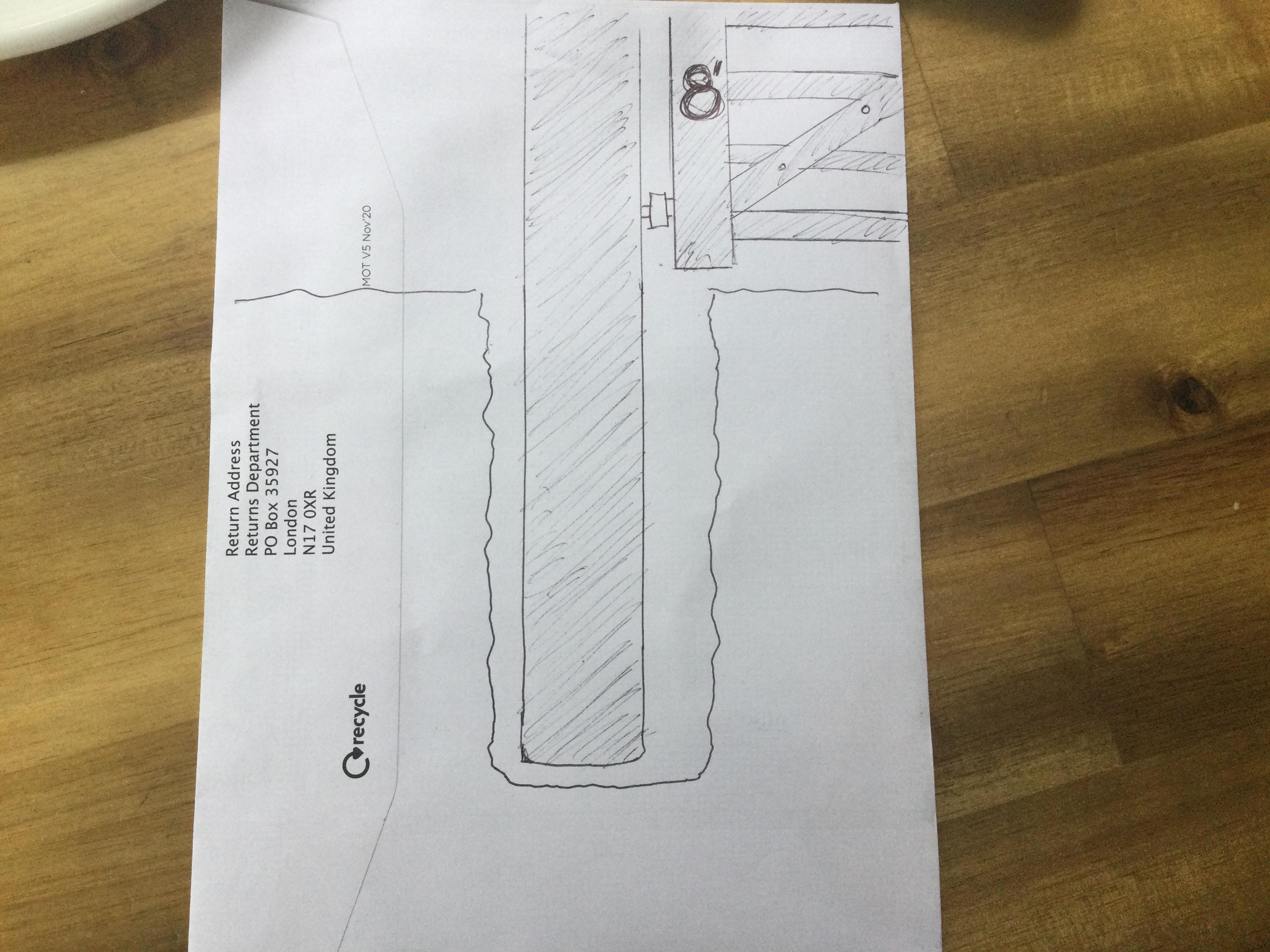

  4. Actually its a full foot H difference L to R.. not 8". So, the RH post can only be set in the ground 2 ft. Maybe 2' 3" max. Is this a problem? The ground dips annoyingly at just this RH post (vertical markers here are @ 12' apart, plus 2" each side for hinges: IE these my inside post edges.. if I orientate posts like my drawing that is, which seems the way to maximise my entrance 'gap'). @joe90 yes I think Ive decided gates like my drawing, so 90* max is fine for both. Will worry about road afterthoughts. Horizontal tape marks on string give idea of how on the c*ck it will be. Zh
  5. @joe90 or @markc does it matter which side of posts the hinges go? (Ie like my drawing, or on inner post faces maybe?). Is one way 'better' or 'correct' in my situation (that is gates only opening inwards). Or is it just down to where I want my posts to go, one way (my drawing way) of course meaning they're further apart.. but might then be clashing with hedges. I need to get a plan on this, before I start digging hole 1.. or post 2 might be incurring too much into the drive opening which I have to tightly reverse into each time you see = hitting a post is always a possibility even at 12 ft gates' width as Im going in backwards! (& I'm quite backwards in general too. And I have no rear view mirror). zh
  6. Hi Onoff, I know this is the ideal way, but I dont have the luxury/ I just cant wait 3 weeks, maybe 6 weeks in current fiasco for the small gate. I have to crack on, ( & I can in meantime measure the 8ft one at the place so this is as good as having it here). My idea was to just get the 1st post in.. this will take me 2 days min. Then figure out, if possible, if I can get post 2 in too this week: As gates are only opening inwards, Ive got to determine where the hinges go/ which side of post. If sat like my diagram, it means the posts are further apart, than if the hinges are on the 'inside face' of the posts. Im not sure which idea is 'correct'. thanks. Zoot

  11. @joe90 or @markc Hi chaps, I wonder if you could voice an opinion. I was just about to fly into town to get my posts, crack on start digging... but this connundrum occured to me, so I'm stuck not knowing how to proceed. IE do I need completely different posts? Or is my RHS one ok set in so 'shallow'? thanks zoot.
  12. Diagram. Its the RHS post looking at it here, I need to start from.. because this gate is the most critical to position right up flat to the perpendicular hedge behind it. Thanks, zh

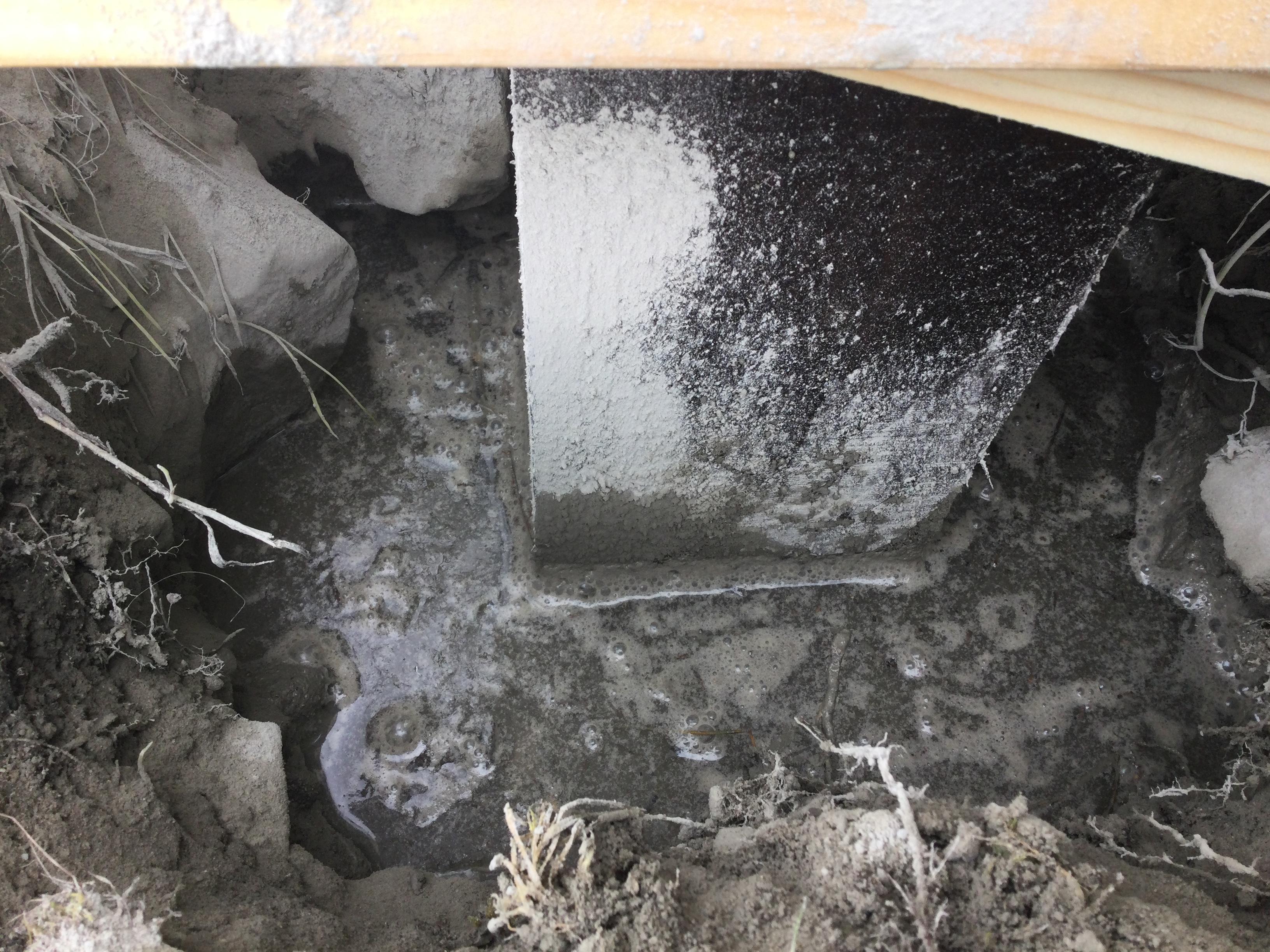

  14. I think Im gonna go postcrete... dont need any added graft after digging these holes. Is that the sensible idea?
  15. Great.. Thank goodness i dont have to go 8 x8! Ok so will buy my 2 posts tmrw. Progress! Mind you then I got a helluva job hand digging these holes.. likely slate chunks & roots galore. Thx zh
