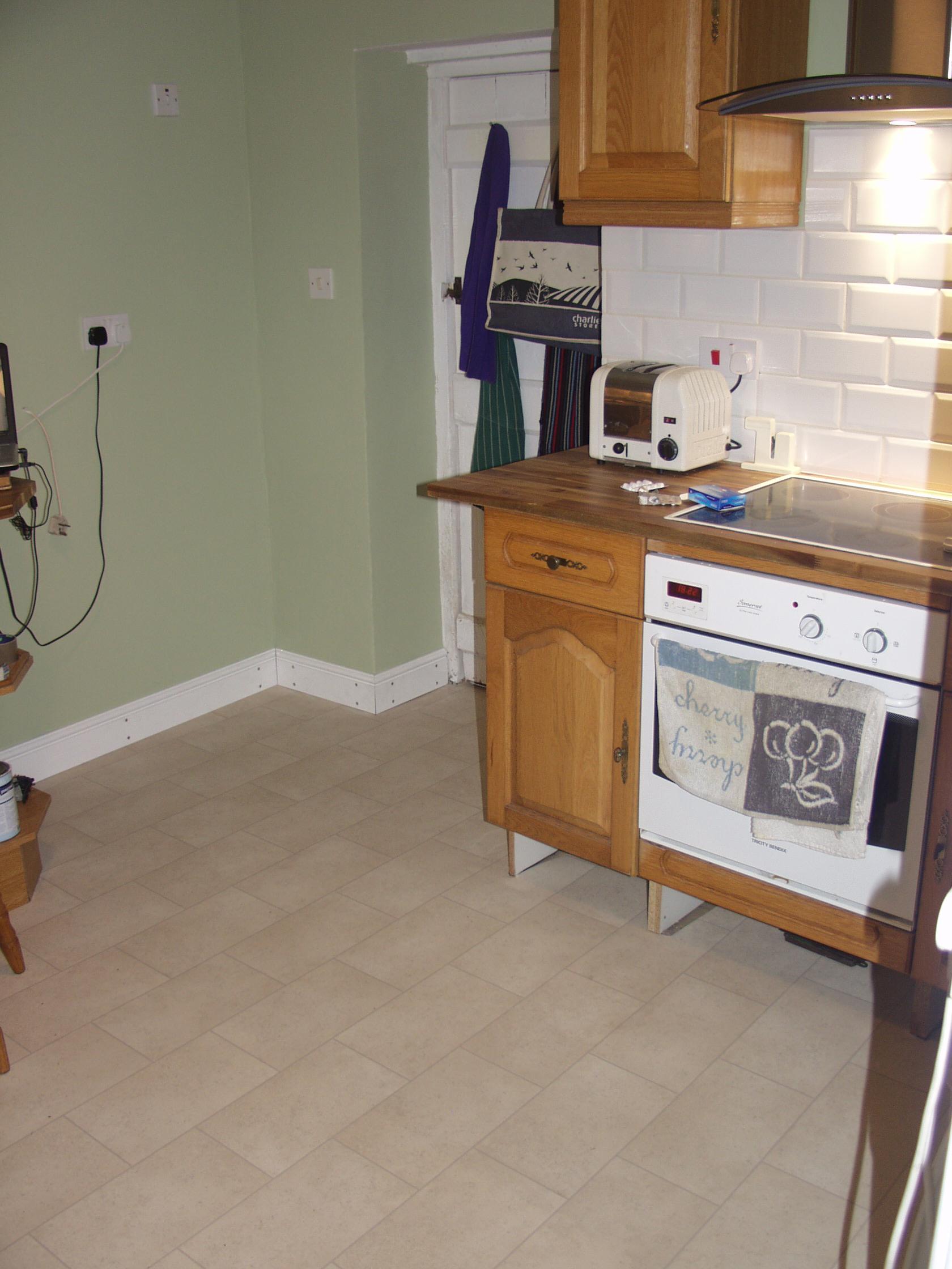

  18. This is the basic house, foreground the 80's dreadful kitchen, behind the 4-thick-walled 'shell' main room (ontop the 80's disaster 1st floor addition).

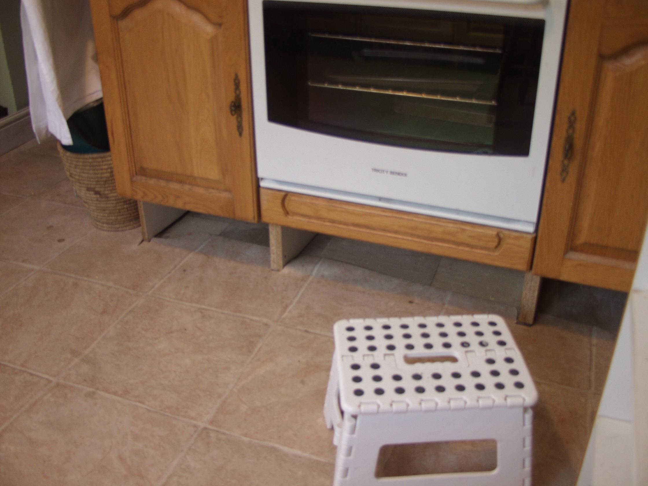

  20. @Onoff wow you've even done this very job! & your results- really 1st class (pic3). Assuming your idea's as mine, to essentially put in 100mm of PIR underfoot.. any info/ pics between pics above 2 & 3? I thought it might be a jackhammer affair. Ok one imperative consideration/ difference with mine, is some vertical beams bases of which of course sit upon (or upon what exactly?) the floor as is: IE if I take these away.. I can't bear to think, but Laurel & Hardy springs to mind.

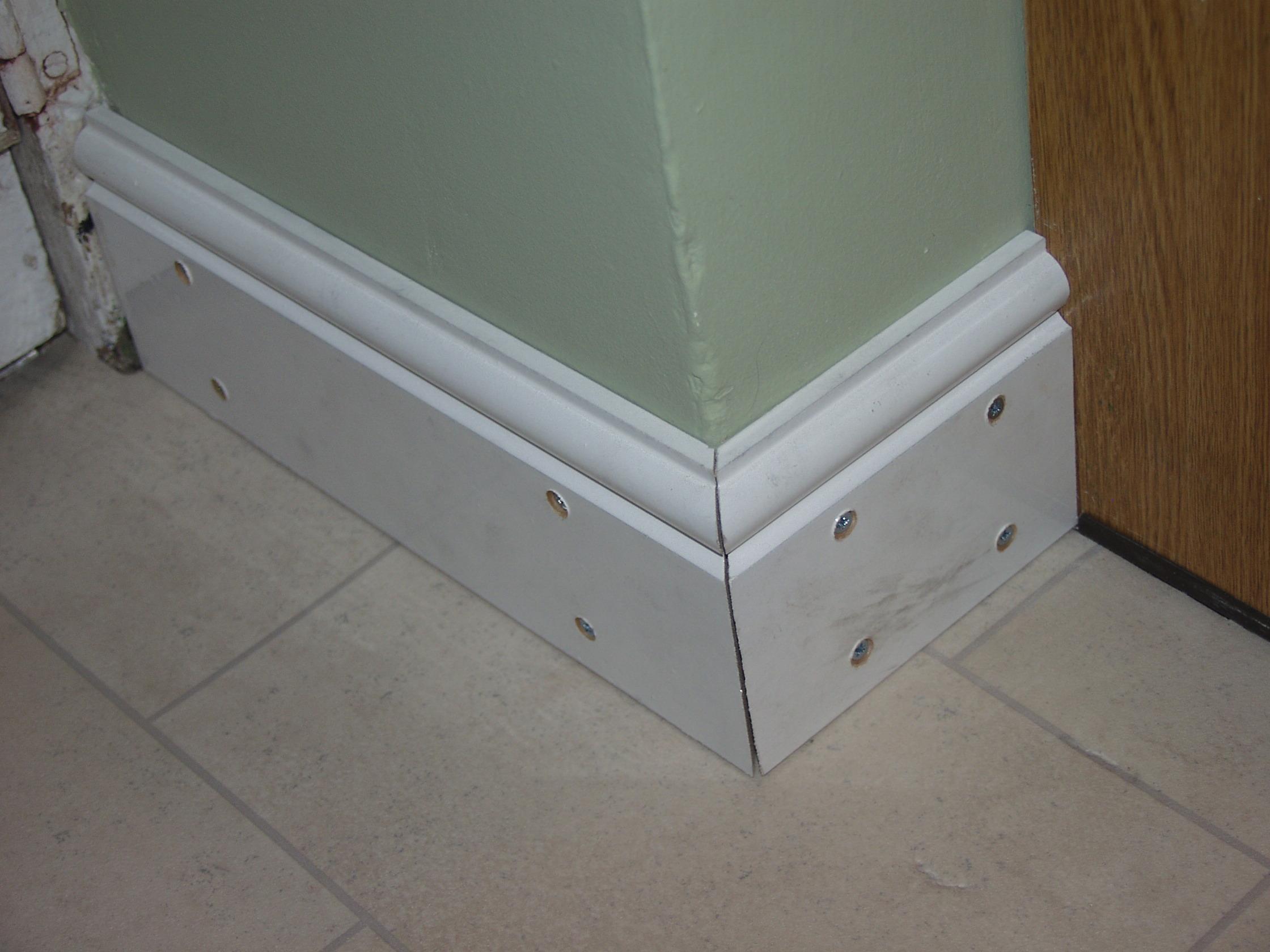

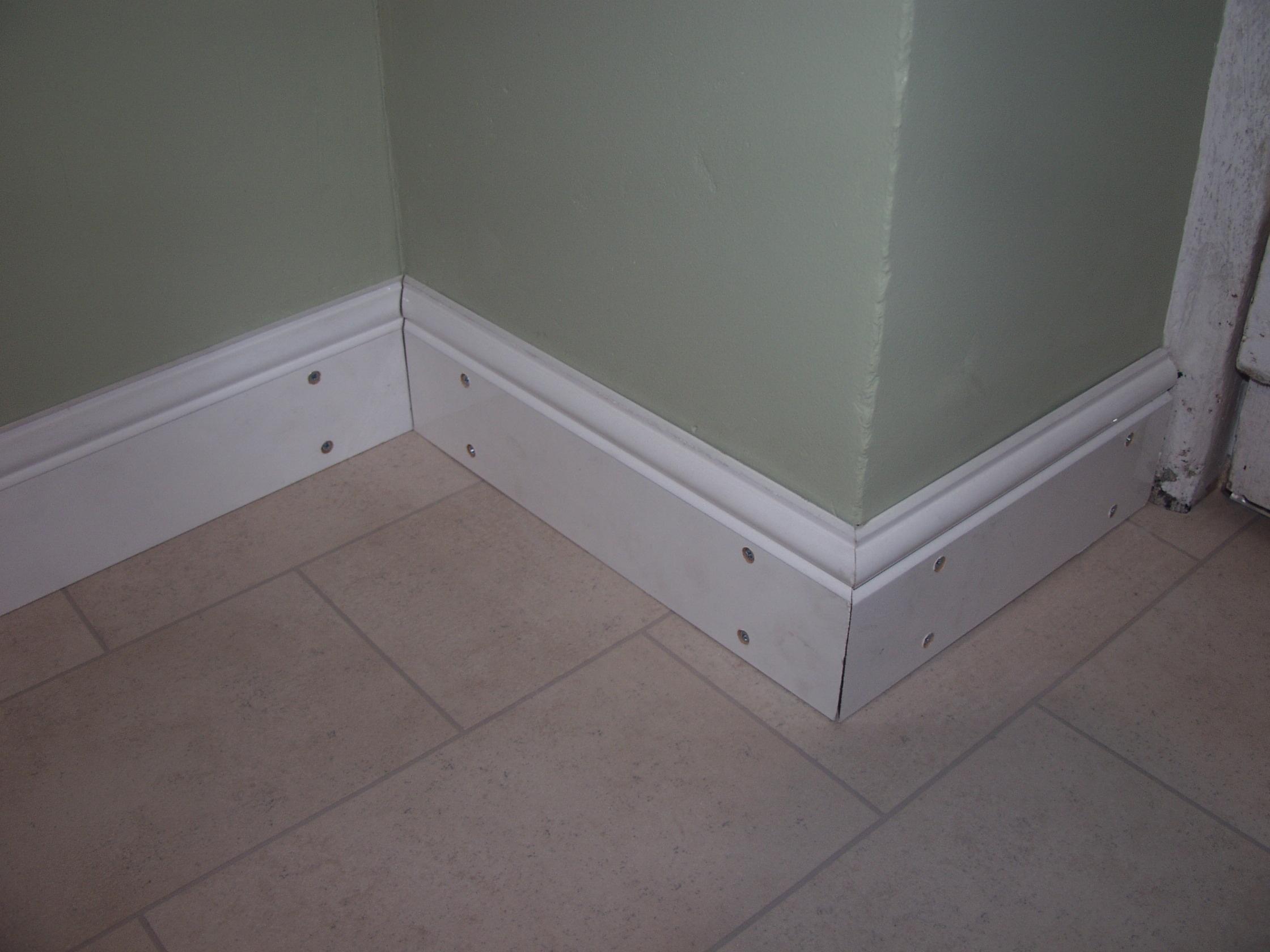

  23. Chaps- happy new year! kitchen 90% done: lino.. will be pro job I've decided: those door frame in-outs/ 1 mistake & I'd mess up. Then plinths/ lastly skirting. The improvement of living cooker side is massive. Sink/ tops & tap's WAY better than expected too- the best bits. Room unfortunately seems just as cold as before, but, it was worth trying.. & great trial for upstairs job (spring). As cold's back top of agenda, I'm doing prep/ a new thread re. my main room floor. Mods- could it be moved to a more popular section I wonder? I seem to not be getting any replies, here.. https://forum.buildhub.org.uk/topic/8149-cold-stone-cottage-orig-floor-insulate/ Thanks, zoot
