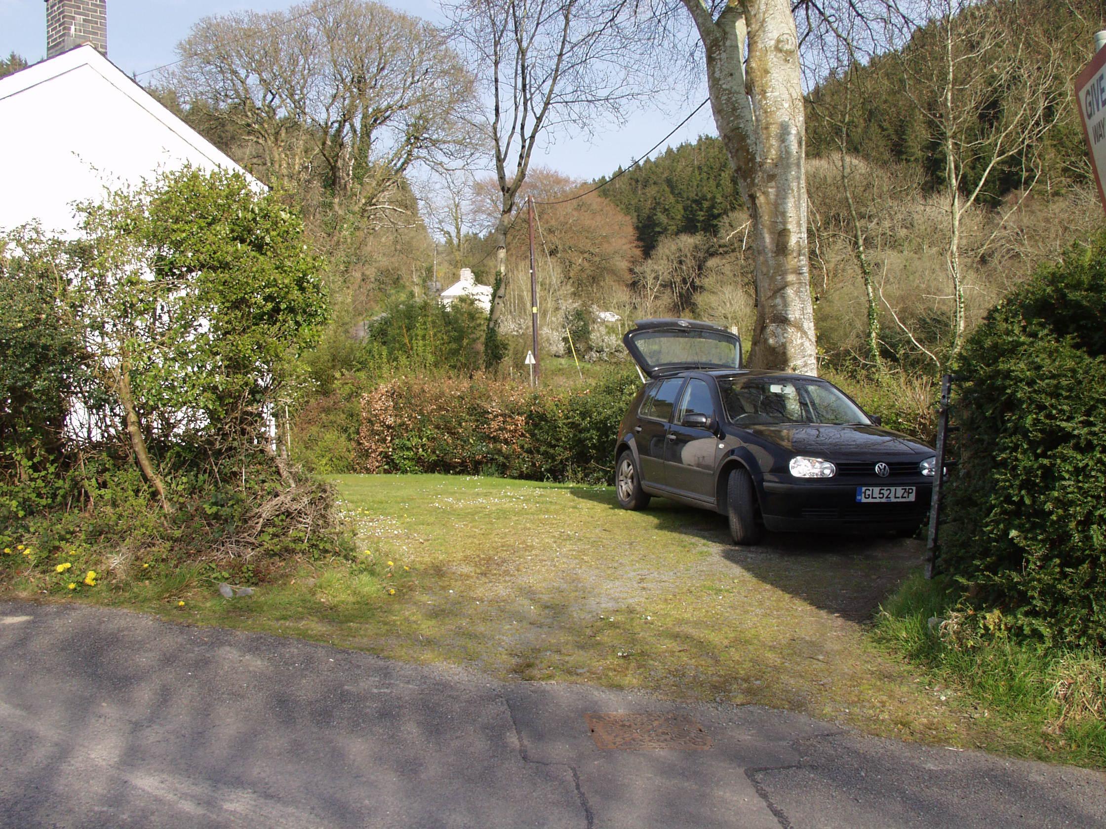

Ok this sort of thing, but 60/40 (I can only just get car in, & gates closed in this config). these square posts look good too. https://www.huwsgray.co.uk/shop/sawn-tanalised-5-bar-field-gate.html So can you sum up what I need, wordwise, so I can do a thread? "tannanised field driveway gates job- to do".. ain't gonna cut the mustard.
Hi Ferdinand- just googling 'farm pedestrian gates '. pics sort of the idea, but not quite on board with wording. Budget- Ive yet to even see what a gate of the sort I'm after actually might cost. I still need the words IE driveway gates? wood entrance gates? farm pedestrian gates?
Right onto my next job! solid double 60/40 driveway wooden gates. Uk usually pine, or fancier oak, onto round 'king' posts I assume concreted in. I've looked on YT but can't find any clips of these ubiquitous gates, oddly. I think my wording wrong? anyone know what wording I mean, so I can do a thread? cheers zoot schmooter.
