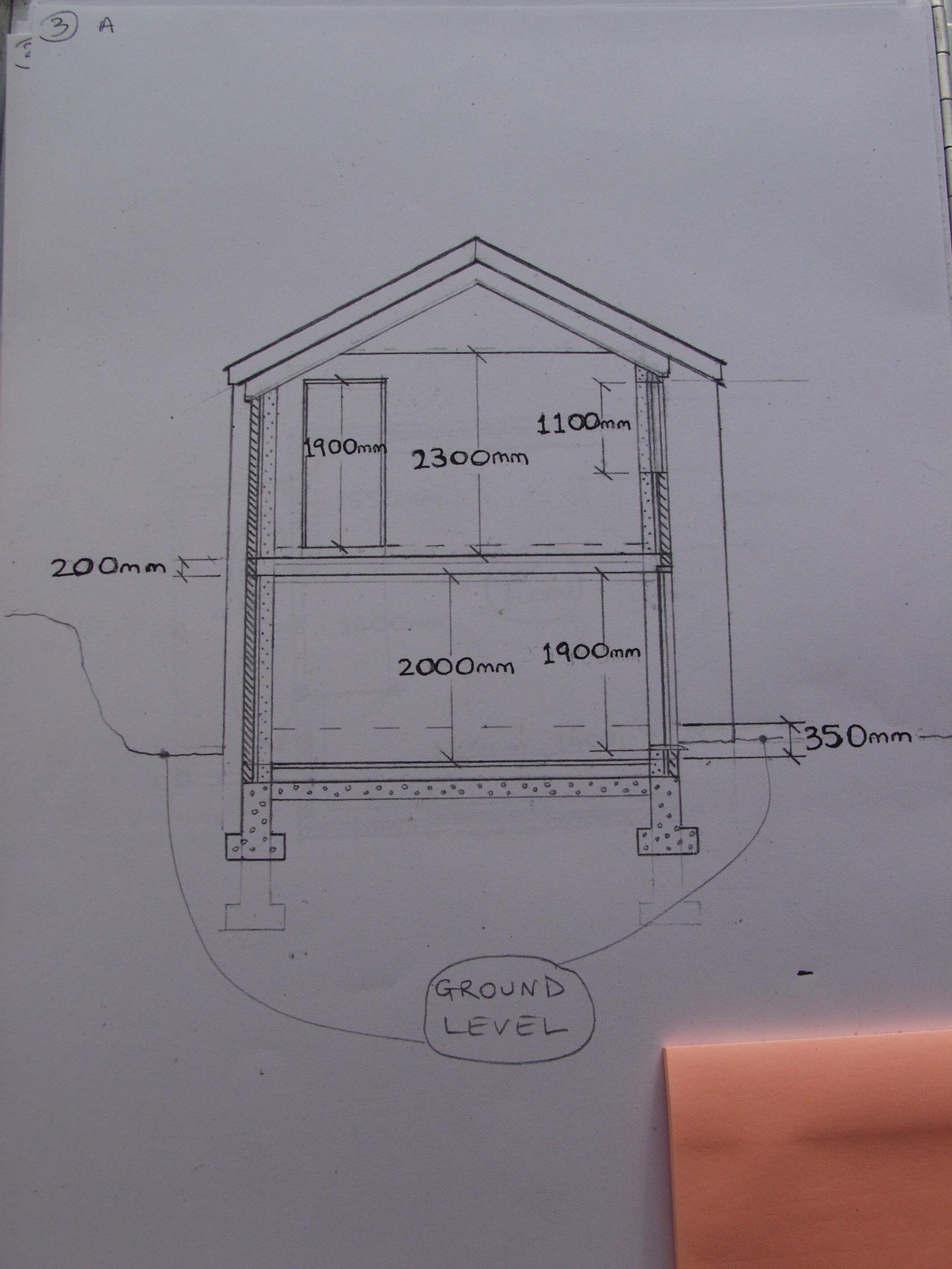

  5. Well appreciate that post BigJ. all as you say.. but for one final fly in the fkn ointment. I measured the wrong orientation of the top floor walls. Not 2.4m.. but 2.1m (silver stud lines across not up). Goddamit. So we had the good idea of going into top room & measuring every hyper-critical cm regarding the knock-thru door/ frame/ &.. the crux.. the new ceiling H next door. With a 1.85m frame (low 1.8m door).. we calculated a clearance to the ceiling @ 1.9m (measured from existing bedroom floor up).. of 3cm!!! so that's 1.9m + the drop-in of 45cm = 2.35m which I absolutely demanded MUST be the absolute min the new ceiling is up from new floor. This is taking into account pushing the whole shebang 150mm -the min allowed for B.Regs- shy of existing eaves. 3cm clearance!! you see why I have been so stressed??!! So my concerns were bang on the money.. my dims spot on, & he was surprised & as alarmed as me once all this worked out. For chrissakes 3cm!! all due to the collared ceiling frame cross truss beam being made approx 250mm lower than I ever anticipated. I was told this would be higher, but that out the window. He had no idea at all we'd be this close until I went thru it all with a toothpick-fussy. 3cm is WAY to tight for any tolerance. So stress remains until knock-thru & full picture/ relative ceiling H's are measured is fully revealed. Lord alive I can't deal with it. Again.
  6. I've got one better in fact- physical sections in front of me I am 100% reassured of (& as the vertical outer silver membrane 'stud' lines confirm, he showed me, so no way can be otherway) are 2.4m/ measured. Plus he said one or two 'packing' shim 8x2's flat too.. if he can.. to get right up to tippy top max eaves H. Phew. Seriously this was the reassurance I needed. I am pretty laid back (normally) so I think he just went his own way fully confident. Me, the flip-side stress/ not to his knowledge until today I think. Screed & FFL.. we agreed 50mm insulation plus 12mm of Onoff's screed (terrific thank you- your best link yet!) which he's fine about. So 2.1m room H.. ok not the 2.35m he promised (.. I just forget it now) but 10cm gained from my orig plan. But, we're still on a knife-edge regarding the existing ceiling H (bedroom) & new top room ceiling H, & the worry remains as to the door frame(s) joining: laughs & smiles tho. All amusement to him. Lord alive coffee painkillers, & pacing like a cougar so I am. They're putting top room walls in within a few hrs too.. I can hardly dare look. cheers Declan.

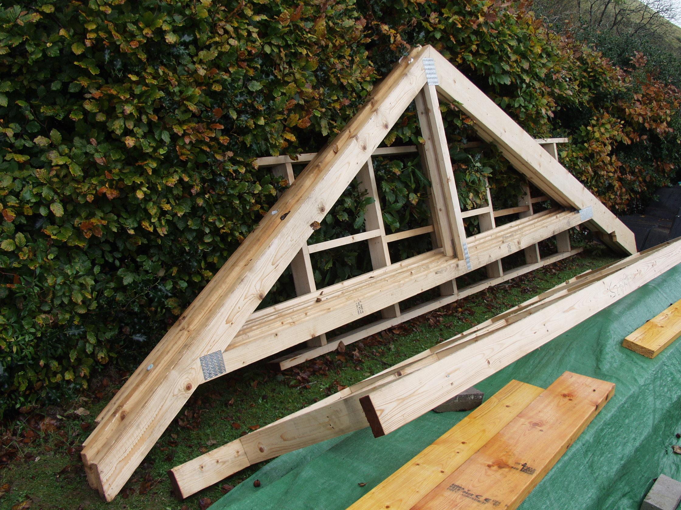

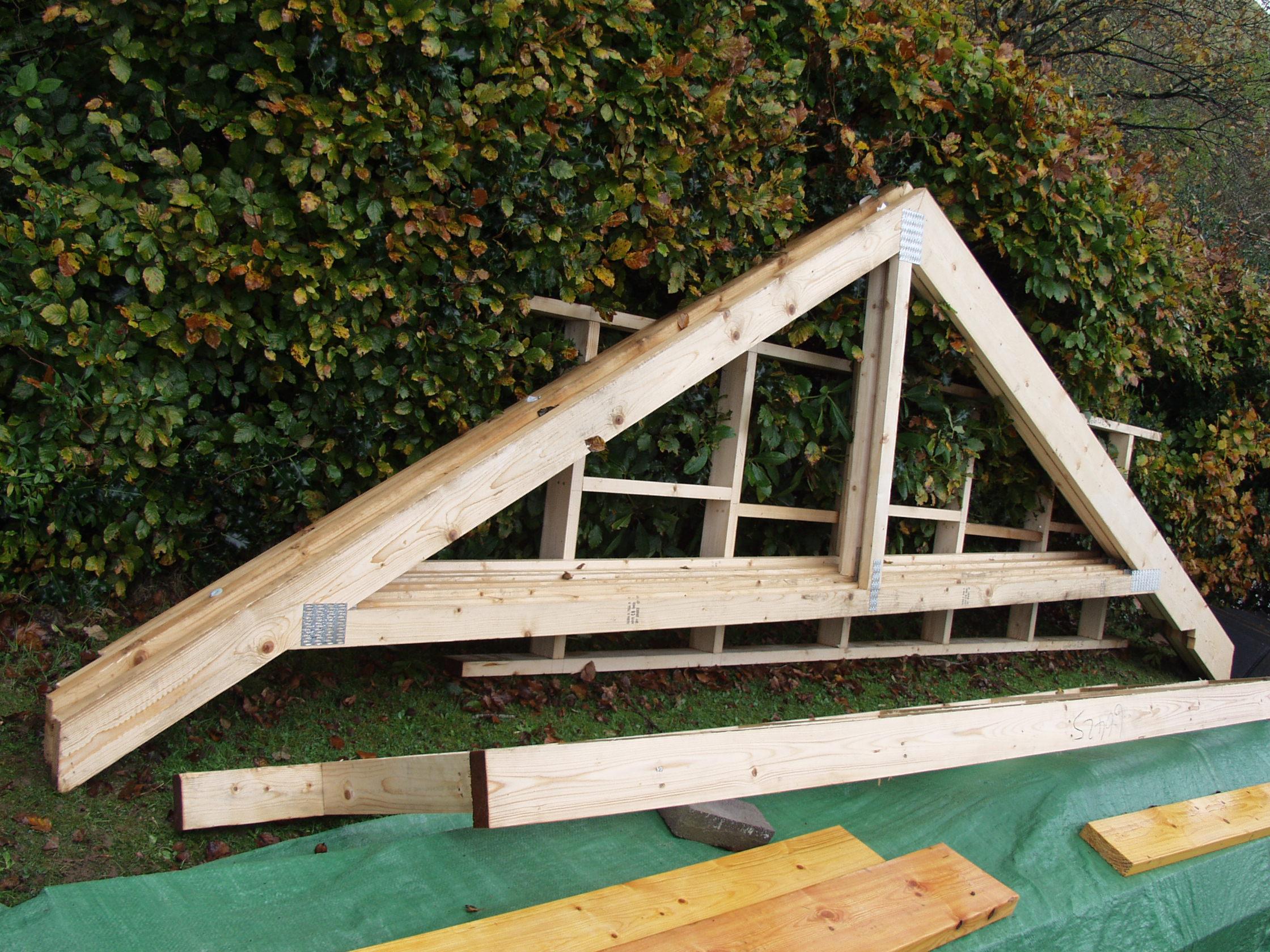

  10. Appreciate the advice.. but how could it be so simple, with all the TF sections cut & just a few shims to help? its a huge job to take off fllor truss things/ add the 300mm risers here, then remake all the top floor walls. Half a day? morelike half a month, seriously 2 weeks minimum just to get the new sections remade.. besides he'd never ever agree. Never. He'll say its as per the plan. Its is, but for the +350mm c*ck up sodding everything up. I just don't understand how a builder can do such a mistake knowing full well how devastating it would be for the build, & just walk away.

  12. So put the pair of 8x2 on, lying flat? that's +100mm. Put on their sides? I can't see how they'd fix but if so, that's 200mm. I cannot establish what you see is the idea, the 'plan' with regard to the top room H. So I don't know if at the mo my roof is 350mm short of where the plan states (this is the most logical conclusion- & tallies with the plan I saw today, basically my plan done electronically.. not taking into account the +350mm of course). If I ask what top room H.. I likely get a lie to hoodwink me by as much as 350mm like the lower room. So I have to try & work out by myself, from the pieces in front of me. This is very tricky with rectangles (I don't know which way meant to be orientated). Ive been trying for ages tonight but I cannot do it. If I do get the height of one main wall section, I then have a collared ceiling so no idea how much extra H this gives me (Ive tried but I don't know how these A frames attatch). I don't think very much at all tbh, maybe 150mm: I tried to get him to push the A croos bar as high as possible "yes will do".. then "yes we got them nice n high".. but this is another lie, they're not high at all just industry std/ I bet he didnt even speak to the TFCo on pushing them up one iota/ no intention, just spiel when I ask.
  13. Ok that gives me some cause for hope. But then you see if this done, both the lower sections & the upper sections would all need to be remade/ rejigged at the factory, & the plan shows only what he's made (why he's done it I believe- plan gives him a get-out clause even if he promised he'dadd the 350mm onto my lower room).. but of course it doesn't take into account the +350mm groundwork mistake c*cking up every damn flaming H dimension following on. It seems like I'm stuffed whichever way I turn.
  14. One other thing I need to explore, one small thing in my favour possibly.. is IF he were to build it so the knock-thru door is indeed too low to use properly & therefore does not comply with BRegs (even skimming the ceiling/ set as far twds new ceiling as possible) & its all agreed that we build it via a Build Notice on the assumption he knows the relevant BReg rules, builds it to such BR rules, & competantly etc (as is the case) & the BCO agrees its not possible to make a knock-thru door because the because the new ceiling H is too low.. & cannot sign it off as a result, is he liable to address/ recify this? if so it certainly won't be as the plan (bc the whole thing would be 350mm lower including top room, roof, ceiling et al) whether or not its lines have been drawn electronically. I have only asked him to make the knock-thru tho.. not the door that would follow. Id find it hard to think the BCO would let a builder make a ceiling, then a hole adjacent to it that could not accomodate a door of building regs min requirements.
  15. Can anyone tell me how physically feasable it is to take off nail-gunned-on Timber Frame ceiling truss beam things? they have alu brackets all along in ~~~ shape, softwood.

  17. RedOct.. its the continuation on I had dreaded, but promised would not happen. Its all very well saying 'the plan shows 2m.. you've got 2m.. so what's the fuss?' but as you know, there has been a massive error by the builders on the groundwork being made 350mm extra depth. RO- I wouldn't possibly know how to 'get rid of him/ pay up, get s'one else in'.. I would need personal help/ speaking to someone & extreme care to take this course. Its almost n/a to be honest. Its a Q of working with him only. And yes now I have to step up.. tomorrow I have to. Before, when I Q'd this mistake I was promised the extra would be added to the lower room H. I now know this was likely a ruse, that he knew the mistake but had no intention of rectifying it at all. The only thing in my favour here, is if the roof is indeed made 350mm lower.. then I have plans to show 'not as/ wrong'.. but his bet is that once the tiles on, Id not dare to speak up. Why get stressed? are you kidding?
  18. 1) It is on my plan. This is the only plan that has been agreed on. The one I saw today (the TF Co one evidently they're using to know which section joins to which etc) I only saw briefly, but looked as per mine. This of course completely ignores this wretched +350mm D mistake causing all the problems.. in which case, if I assume this plan same as mine (as why would it take into account an ammendment by way of an additional 350mm D that's not on the orig plans?).. then regardless of the drawings.. the new roof will innevitably be 350mm short of the plan. I suppose once we're at this point, up there he thought, I'll just fein oddness & 'oh I think we're a bit short' etc or more likely just say 'that's fine/ all normal': & if needed, use my plan with only what he told me to put on it, by way of his escape-excuse. 2) I have no idea, I asked this very Q a few posts before.. but if its a Q to my builder assuming there might be room to manoevre with him on it, then a big NO.. why.. because it scuppers his dead-set plan (to cover his no2's mistake, & the extra cost of it he incurs). And NO because it costs him extra if he were to agree to do it... tho it seems I have no choice but fight to the hilt on this very crux point unless I want a disaster extention. 3) no, the upstairs are odd one side to the other.
  19. I saw them today. They do not show the additional 350mm he promised me. It shows my original plan room H's. 2m and 2.3m with 200mm floor between. Fine & dandy if the damn groundwork wasn't dug +350mm deep. I quizzed him on this, I said I just saw the plan.. "oh no he said, it'll be 2.2m we have shims we've been given so we can alter to suit" (8x2's on side). 4x shims are indeed in.. but added to the wall sections I measured & told myself "pls pls no" the other night stacked in a pile, @ 1.88m .. it all equals 2m once insulation + final layer. At best. Possibly 1.95m or 1.90m. Another convenient red-herring he threw me & I snapped up, was "oh best to have a window in there it'll be quite a dungeon as it is, we can put that in no problem just ask".. IE making me consider this to appease the fact the room's only 2m H not 2.35m H he never intended, but lied to me it would be. Clever I think now, total builder expertise vs a nice guy on his own who'se easy money. A mistake? opps.. but hey hang on, its only this guy, I think we'll just plough on & spin yarns to keep him at bay until its too late to turn back. Ie, right this very now/ this evening.
  20. Not paid up front, thank god bitpipe. My drawings say 2m room H. But the groundwork was set +350mm down (a mistake, by them). I was then told "all fine, it'll be added to the lower room H.. so 2.35m I asked?.. yes.. you promise me? yes don't worry". Ok I said, tho confused & knowing I'm agreeing to a compromise: it would've been ok as Id be gaining 0.35m room H I thought.. but it was a lie to let them carry on, probably because either *he'd had the room's TF sections ordered at this point, or, he had no inclination to change from my orig plan by spending the extra he should have on the additional 0.35m adding to the walls' sections to rectify the mistake, & thought I'd fall for abc minor excuses, fibs, lying me down from 2.35m to 2.2m today.. to 2m I measure this evening after they'd gone. I'm convinced this* is the case.. in which case the whole thing WILL be 350mm short & a major situation occurs as I can't get a door in. I cannot undertsand it. I cannot understand how he expects me to pay if this is the outcome.. apart from.. cornering me on the fact my plan "didn't show adequate clarity" etc etc bllx.. tho it seemed some on here agreed precisley with this/ these cowboys, that that is the very reason for the damn mistake, me not them. This adds insult to injury I can tell you. I cannot understand how we can be on such good terms, even sitting in church together, get on very well.. & with a vg reputation in general, & good work done here before, for him to hoodwink me like this.. if I am being hoodwinked.
