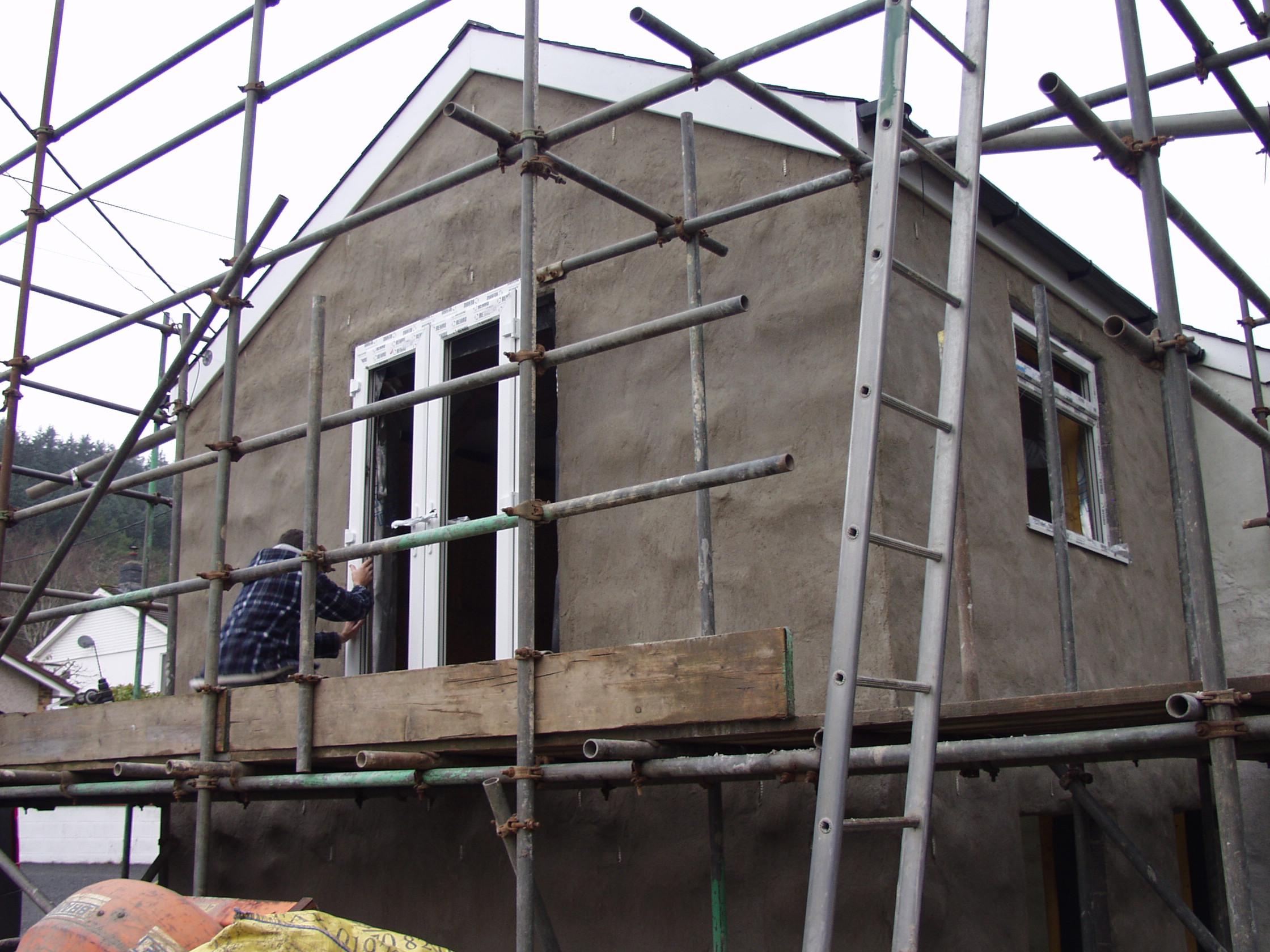

@Declan52 could I get your opinion on what I might do with this window, re. minimising the opening W? I got in a pickle before saying opening 2150mm. Its not that wide, its 1150mm. The last pic above is the window. Its position & width determined by/ to coincide with vertical TFrame studs behind. I was told 'you dont have to have this wide, you can have it narrower'.. but little did I know this meant timber packing either side, or just one side as I'd prefer (symmetry reasons).. I just naturally thought 'block/ brick' pretty simple. But I can't do this apparantly & it has to be timber. So we're going to minimise W to 920mm, packing the LHS. I expect the fastest way possible, wood then, but this will mean a hollow area (sound escaping).. so I want to explore ways to solidify it up prior to mesh/ plaster over. Or anyone any ideas? thanks, zoot.

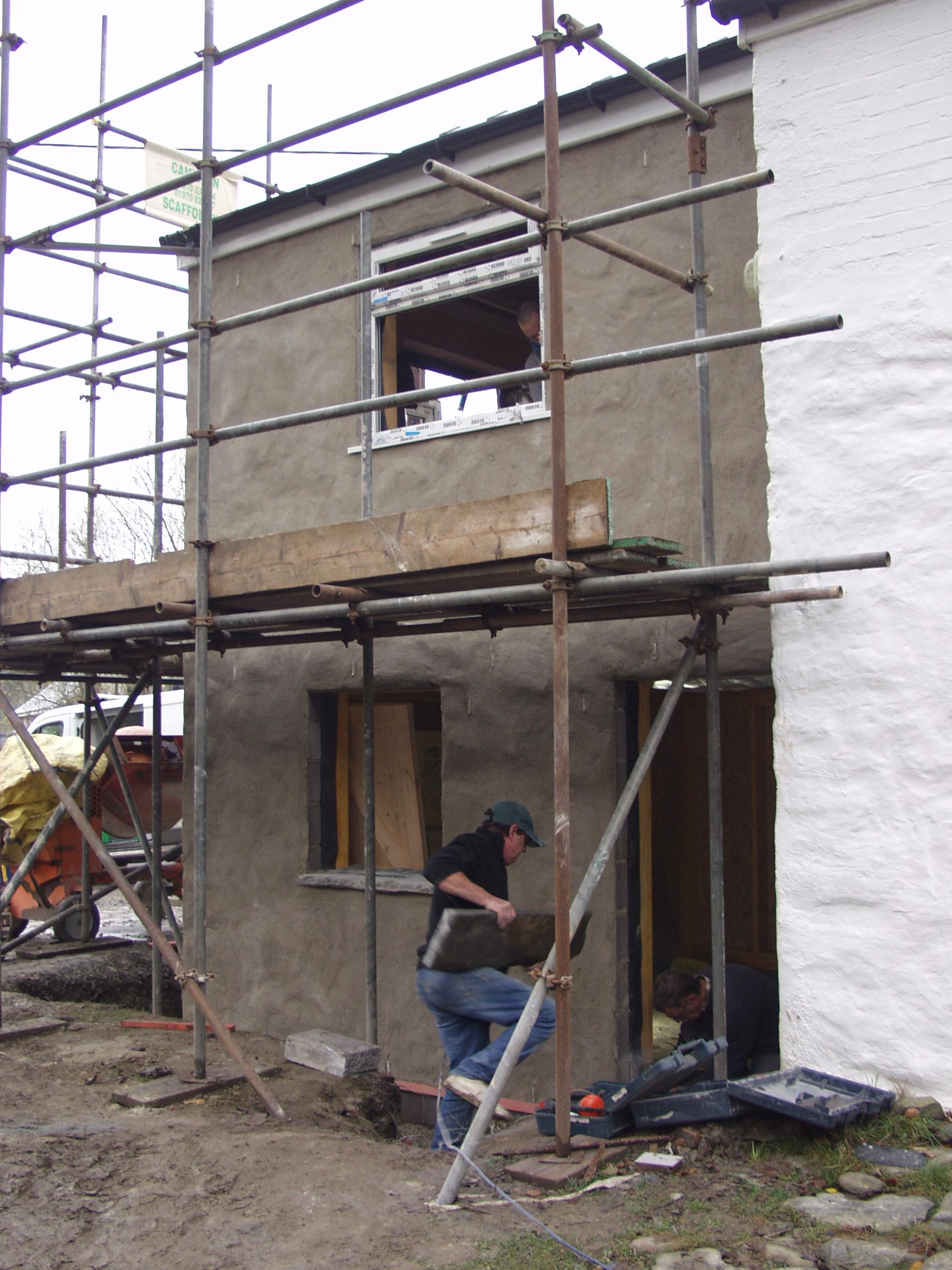

Ok but I will call the BCO. The mortar is just not setting here too (it is in a dark shadow below the 1st floor scaff boards) & lintel is twisted out fwd. Cosmetically once the window frame's in it will be seen won't it? I mean there's nothing to go ontop of it, is there usually? @PeterW the 1st pic, if you look at the bricks.. there's a sag in the middle/ I've put a level on & the gaps L and R are 3/8" to 3/4". There's a piece of ~5" slate in the mortar, on the RHS of opening (just above the lower white placcy thing) its at a bit of an angle up. If you can ID this then the lower side of it.. is on a plane of the bow's maximum = so it is pronounced/ I'm not being ott fussy here.
Temp camera fix/ no idea how. 1. window lintel bow (the 1150mm W window which will be 'packed out LHS only with timber to 920mm.. whether I can solid-up this open timber area I still don't know, I got my figure wrong at 2150mm before which c*cked that question up) 2. Door next to it, entry to lower room

I cannot find these damn lintels exactly, but have found "https://www.less2build.com/catnic-lintel-ctf5-timber-frame--1200mm-50mm-cavity?language=en¤cy=GBP&gclid=EAIaIQobChMIyrOc5dTz5QIVybHtCh2b1gc0EAQYAiABEgICPfD_BwE which says.. " All timber frame models from any manufacturer must be secured with restraint clips (supplied) and a batten (not supplied) to prevent lateral deflection (twist) during the building stage to achieve the loading figures shown. " So I have this to put to my BCO. Ok if he tells builder to redo: is this feasable/ if so, how big a job would this be?
If I knew it was an IG (company?) lintel, I could put this to the BCO -if I put it to the builder, the end of good terms/ he'll pop- but it doesn't look the same. Its a farm gate galvanised-look light grey lintel, but definitely this "Timber Frame type" shape.
Now this is just the info I need.. & concurrs with my feelings on it. But there is no way on earth I can put it to him to redo this- he will shut up shop, the work will stop, & I have no bargaining room on my floor (his original itemised groundwork quote, which he repated the same £figure for on the final quote but only in terms of 'groundwork' leaving off the itemised details.. it was clear the details already listed before, & no need to repeat.. that was the clear as day implication), & he'll go back on this that & the other, like the contoured render we agreed on.. he'll just not do/ it'll be flat/ just as I don't want. The only thing I can do is phone my BCO about it. This I'll do once I can scrape a photo together. All the power lies with these builders however you play it. They can just stop & not continue until you relent. You have to get it continued; they don't, they just go onto the other job. They can wait for payment for this job.. but you can't wait to get the build finished, especially @ the start of winter.

Ok, that's helpful MJN.. but is it bowed in the middle because of a weight of 5sqM of block above it? How can an 'extra HD' lintel be only mm's thick-?

@PeterW a 'Timber Frame' lintel.. aha ok. as its solely doing duties to the outer block layer Id never have known this is what it was called. This back angle up/ out, then up 90* again to the 'bed' is morelike to shape I saw. So, these type -had- to be used then, & a concrete type was never an option? But surely it should simply be thicker then.
Anyway I can't find the type that's been used, Peter's eg above is indeed closest. And as I said I'm happy to be proved wrong on the cost.. it seems maybe a concrete lintel -is- less.. but I can't be certain/ can't find my exact type. So why on earth would one of these have been used instead?? Ive never known anything so barking mad if the concrete type cheaper.
They're sort of like this, but do not have the additional back area which lookslike a strengthening bar area.
