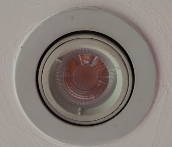

Hi, in my conservatory I have 12 of these light fittings (it's part of the original build and has a proper tapered roof and walls). In the winter it gets quite cold and I can feel the airflow under each of these lights if I put my hand there. I think you can get covers that you place around the fitting from the other side (like a face down plant pot) but I can't get to that side, and I guess there are different fittings that have a fireproof surround but it would take 12 of these and I assume I'd have to get someone to fit them so that would cost a fair bit. I just wonder if I'm missing something. I guess I could use some silicone and cut it out if a bulb needs replacing but I'd worry about not being able to swist the fitting. I also wondered about some kind of sticky circular covering for the outer gap where most of the airflow is but I can't see anything online. So I think I just deal with it or get 12 new fittings and get them fitted?

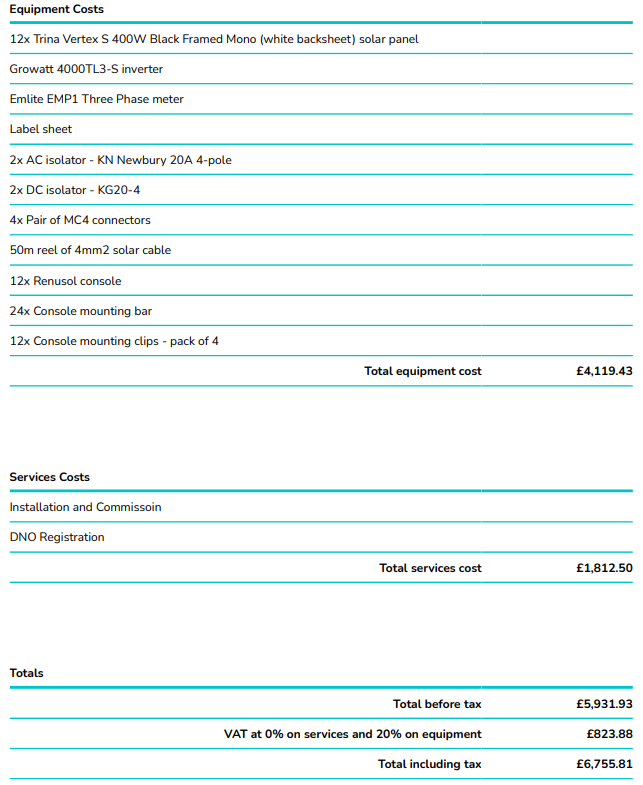

Thanks, it may help to see their website or something even if they are too far away and probably charging a lot more now. I would have thought that the panels + inverter + bits + two huge batteries would cost more than the quote but clearly not! The whole battery cost is a mystery to me as the list of costs I've seen seem too high (eg Which magazine have a list of batteries and approx price). -

Thanks, the HMRC wording was poor imo in several places. They updated the quote for a battery, which was £9.6k if I take out the vat. This is 12 x 400w panels + 5.4kw battery + the inverter and all other bits. It seems way way more than your quote given the two larger batteries and more panels. -

They just got back to me re my question about VAT and say this: "The VAT-Zero rule applies to the solar PV installations, and not on the equipment. https://www.gov.uk/government/publications/changes-to-the-vat-treatment-of-the-installation-of-energy-saving-materials-in-in-great-britain " This doesn't seem correct to me? -

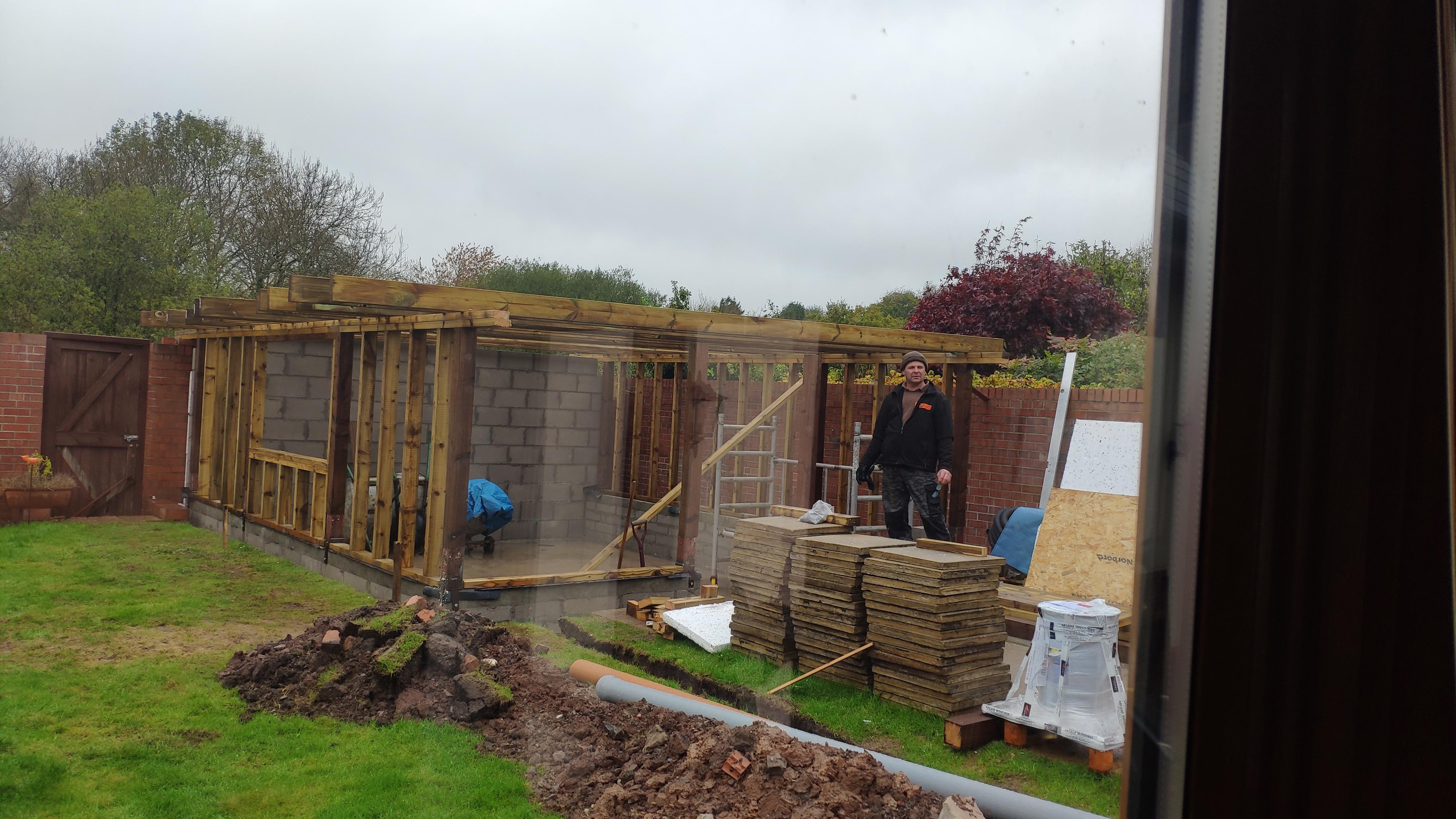

Thanks, I did sift around and what I saw made it seem OK for the build but they wouldn't reckon on all that stuff on top I guess. I just know all the stuff was bought from Selco! I really hope that they can add any weight near the edges only. If the mounting brackets are connected then I can't see why not, but I may be missing something. -

Nice. The width for me is 4.6m interally so I guess the joists (if I'm using the correct word) are around 5m apart. I've got no issue with the weight if it's above the edges but I'm the sort of person who gets nervous hanging a picture on a plasterboard wall so having lots of weight in the middle worries me a bit. I'd hope that if they are connected rows then you can load of the ends though so the walls take most of the weight. -

I know that the rafters inmy case are 7 x 2 Kiln Dried, spaced every 40cm, which seems strong but I really wish it wasn't just ballast. My roof is fibreglass, so has this thin paint coating on top and I've got no idea whether something can stick to it without screwing through it. The panels are pretty heavy as it is. -

Thanks - I've asked about battery options but I'm still confused about the VAT. Just Googling it now it seems like the change in March covered materials and not just the actual install costs. -
It's a tough time to get quotes it seems, but I finally have one. I must admit, I did think that there was no VAT on equipment if it was part of an install but I guess not. I'm a bit dubious about how this connects to the roof, esp baring in mind that this was just sent after I sent a couple of pictures (ie they were never on site). The one guy to visit (quotation pending) said that they would use a ballast method, but this seems like it's something different. Anyway, any comments would be appreciated!
