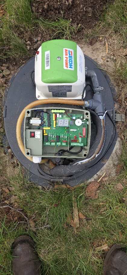

  1. That round white thing seems to be a pressure switch but it's not connected. Presumably it detects a blockage and switches off the pump. I'm trying to remember exactly what RA Dalton said about having the pump going all the time but other than they found it gave better results I can't recall. I think they have it set up so there is effectively air going to the sludge return and the aeration at the same time.
  2. Thanks for this unfortunately I have the older discontinued control panel and can't find any manual online.
  3. Thanks that's good to know. I don't think the Bioficient has the moving parts, just the blower.
  4. Thanks Nick, I used to have RA Dalton service it but seemed a bit steep at £300+ a year to have someone basically change the pump filter and diaphragm. The first time they came out they put the blower on constant, they said they had found this gave the best performance. Do you think I could just fit an outside socket with a timer under the cover, plug the blower as a permanent fix? I don't really see what else the control panel is doing if it's on all the time anyway. I don't think it has alarms or anything.
  5. Hello, I could really use some help with my Klargester Bioficient 1. During a recent snowstorm the cover over the control panel blew off. When I went to refit it, I noticed that the air pump was not running. I’m not sure if this is related or just a coincidence, it may actually have been off for a few days before I noticed. The system has not tripped the consumer unit and power is still reaching the control box. However, the display is blank. If I press the reset button, the display briefly flashes the number “23” a few times, then goes blank again with just a small red dot showing at the bottom of the display. Things I have already checked: Fuses appear to be fine The unit is still receiving power I replaced the Secoh JDK 80 pump with another pump, but it still doesn’t run and the error remains I had a look in the chamber and there is nothing obvious like it's backed up or anything. Does anyone know what error code 23 indicates or have any suggestions on what else I should check? Also, how long can the system run without the blower before it starts causing problems with the treatment process? Any advice would be greatly appreciated.
