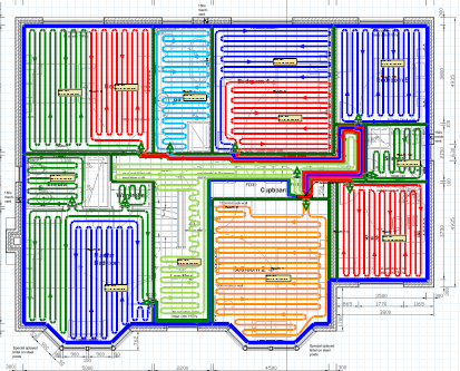

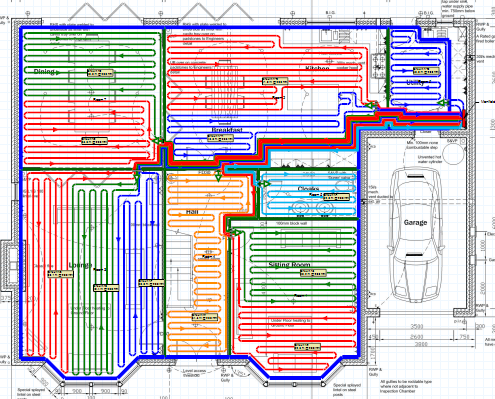

  1. An update... I met couple of qualified electricians to discuss wiring the house. Both have not installed or wired solar panels before. Both electricians are not keen on installing the solar system. Also, I asked them about wiring UFH and both insisted that plumbers do UFH wiring. Is this true? Thanks

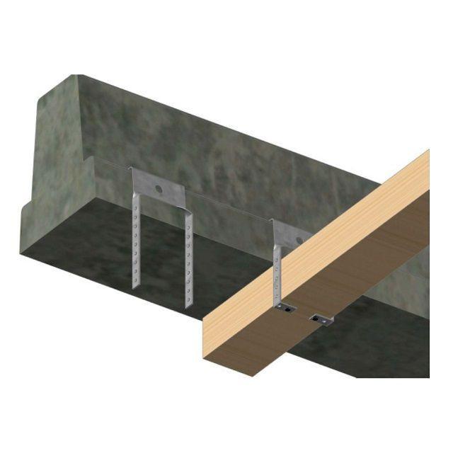

  10. Thanks @Temp I thought the ceiling clips are placed as you place the blocks. Four ceiling clips per square meter. However, my builder hasn't done that. He says that they have to be placed after all the blocks are placed, from underneath. Do you recall whether you placed the ceiling clips after all the blocks (entire floor) were placed, from underneath? thanks
  11. Thanks. I will look into MF framing. We already have some clips, attached, provided by beam and block company. But I'm not sure if they're the best option.

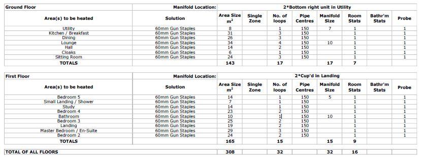

  13. Hi We are building a new house with block and beam floors We are going with water underfloor heating with liquid screed on top on both ground and first floor. Do we plaster the ceilings/walls first and then under floor heating and liquid screed? Thanks
  14. Hii We just layed beam and block first floor. Just wondering what would be best method to hang the plasterboards to the ceiling? We do have ceiling clips to screw wood to and then to screw plasterboard to the wood. However, the ceiling clips seem flimsy. Is there an alternative method to hang the plasterboards to the ceiling? Thanks
