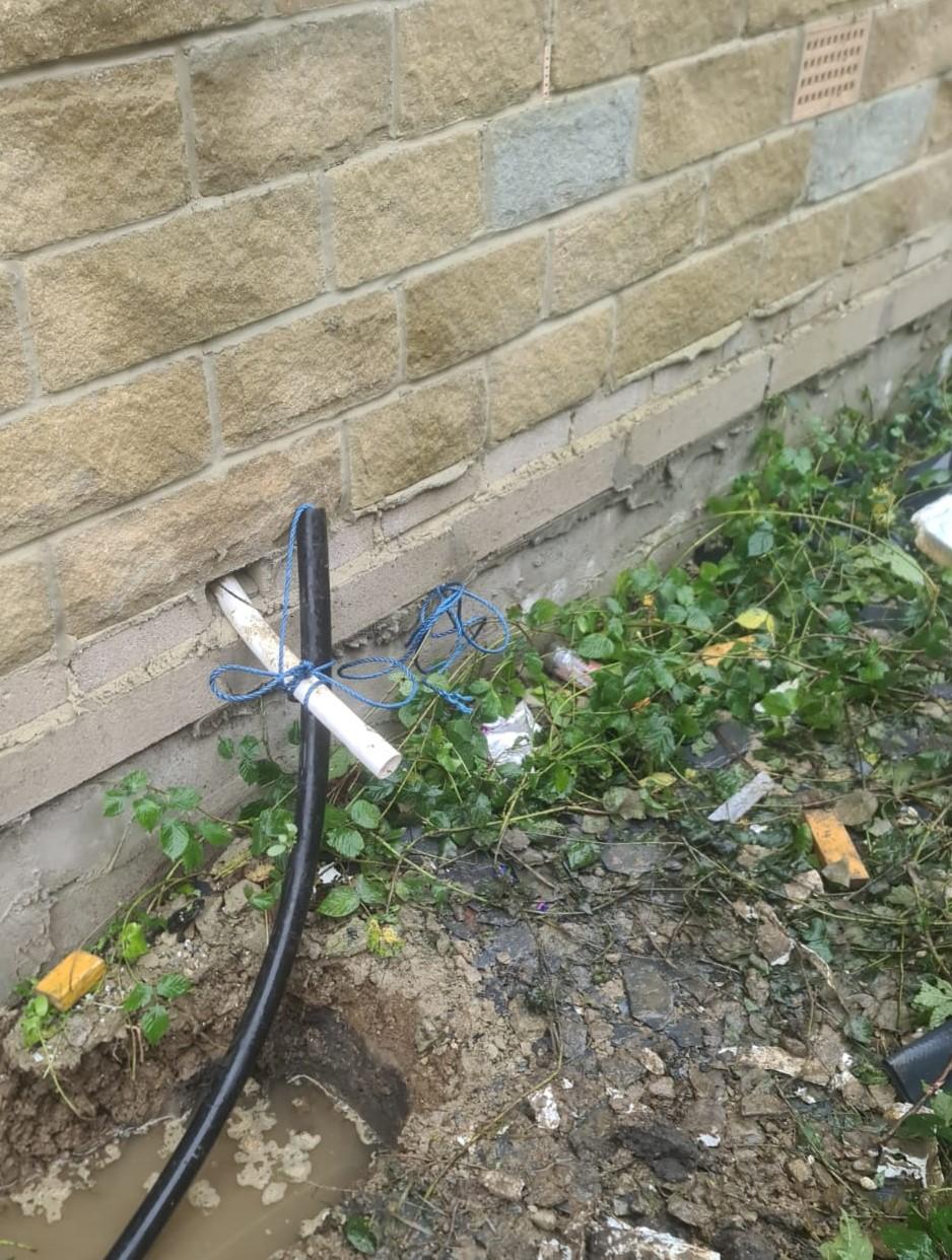

Thank you. My builder also went through the foundation block with lintel over the top. The MDPE is in void under beam and block floor and was covered with concrete/sand mixture. I can't remember what if any ducting he used. I suppose it's still acceptable even though it should had taken the MDPE to the utility room (right hand side of the attached photo) as per architect plans. The reason we're re-locating the MDPE is that it's short, it doesn't reach the footpath. Furthermore, Yorkshire Water want MDPE about 5 meters further away near the gas and electricity trench (see attached photo). I'm not sure that now it's practical to put a 110mm drainage pipe with lintel on top through the foundation blocks. I was hoping for an insulated hockey stick, like that used for electricity cable (attached photo) as probably the best option.
Hi We have an open trench for gas and electricity, which we also be using for mains water supply MDPE. The trench is well below 750mm finished ground level and beam and block floor. To get the MDPE inside, would it be better to drill through the cavity wall into the void below the block and beam floor or above the floor? What type of insulated ducting do I need to use and with what bend to get the MDPE inside into the garage? Thanks
