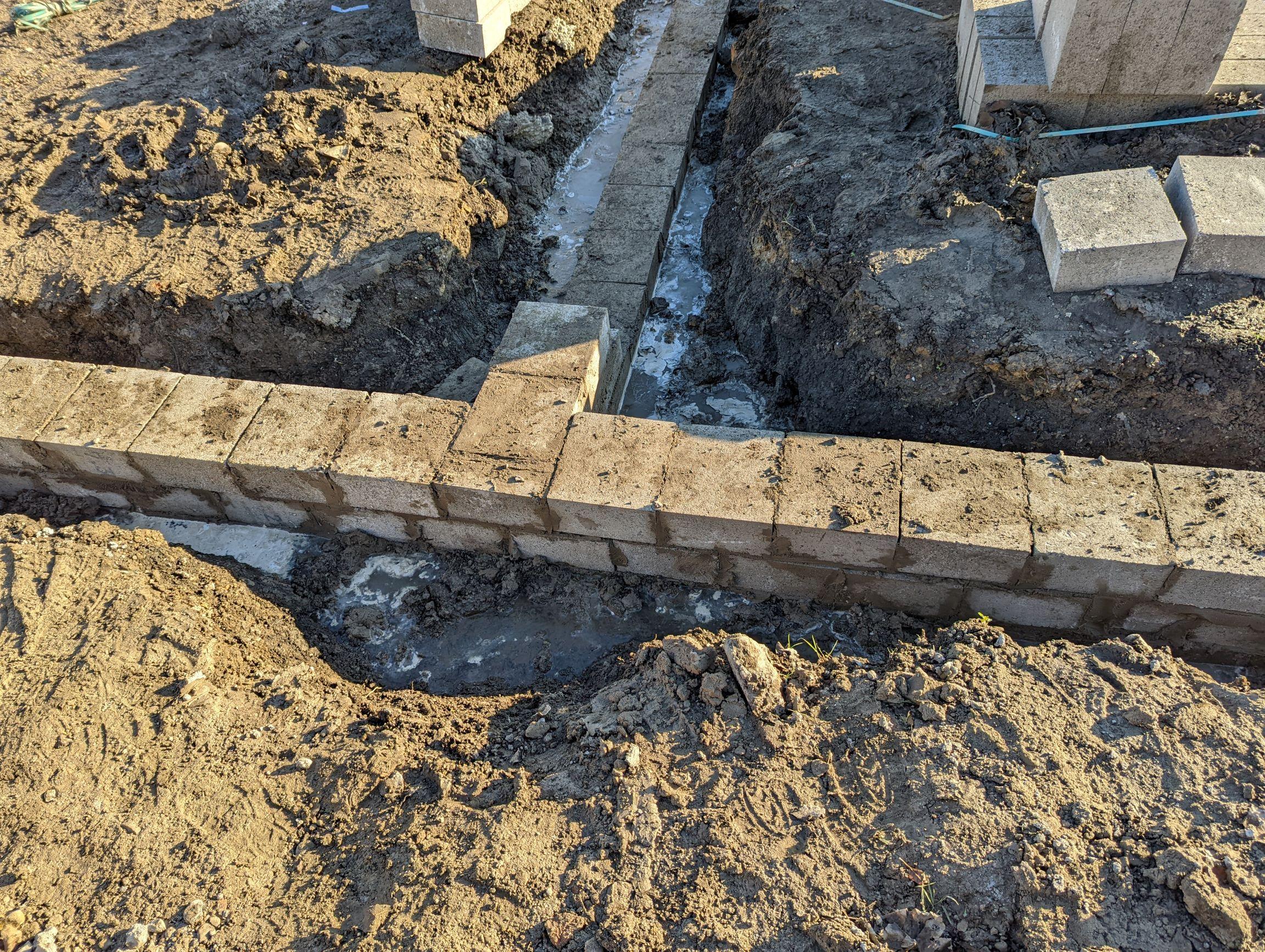

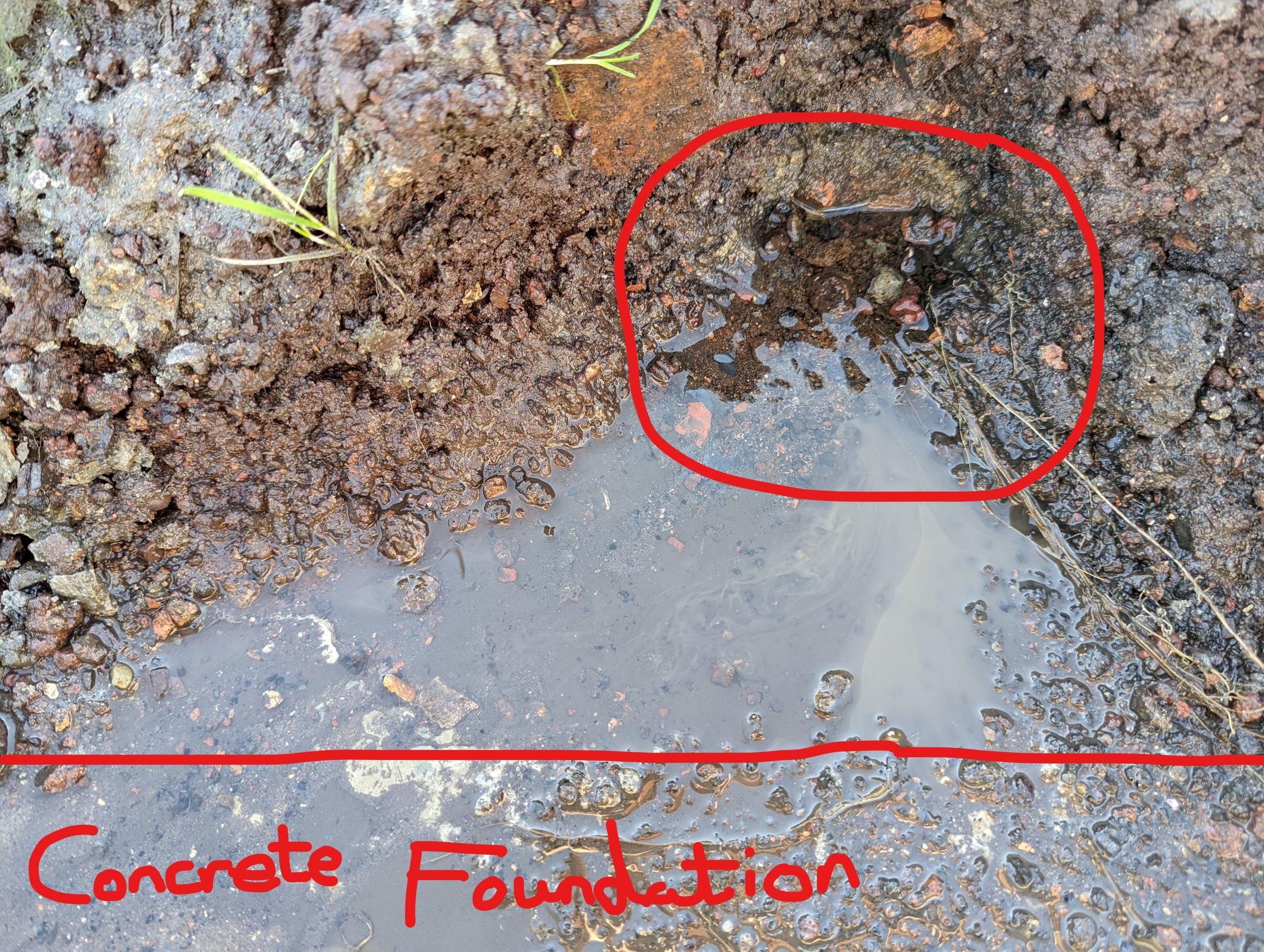

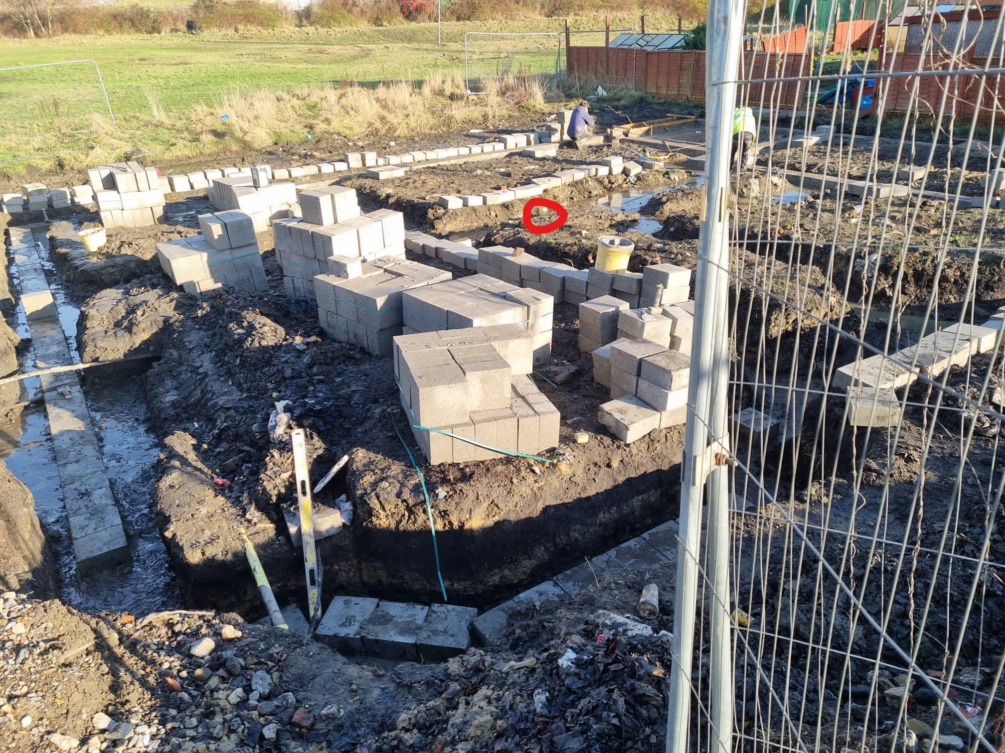

  1. Thanks all, I thought I'll give an update on this issue that we experienced. I had building control officer to inspect the water seeping from ground but he said it's nothing of concern. He thought the water was gushing from the ground. I told him that even though the water is trickling out we had to pump it out twice and sometimes three times a day and showed him photos/videos. He said he's been on another site and the water was gushing out and they put a French drain in. He advised to leave it as is or put a French drain in. So I planned to put the French drain in. I also called out Yorkshire water but they couldn't find anything. Last week, before we could start the work (strangely, the contractors digger broke down) we noticed the water seeping from the ground has stopped but there was still some standing water. Today, there's no standing water in the area/room at all. The soil is almost completely dry. We have had some rain since last week. No work has been done to stop the water yet. There is some standing water in other rooms but its clearly rain water. I still plan to put the French drains in. Thanks all
  2. Unfortunately, the site slopes quite a lot from the road towards the back of the house. We purposely raised the FGFL because the driveway was too steep, from front wall to road. We probably don't have much choice but to backfill. We're not using Aerated trench blocks. These are just concrete blocks . Yes, mobility ramps are planning condition. Hopefully, putting a French drain around the outside of the house will capture the rain water and redirect it. Thus, stop charging the water table beneath the house (thanks YouTube content creators). Therefore, no water to come up from the ground. There was no ground water since excavating the footings in October. We had heavy rain a week ago and some snow which I think has charged the water table. Hopefully, putting the French drain will resolve the issue.
  3. Thank you. I reckon the water seepage location is about half a meter below block and beam floor. French drains is a good idea (only idea so far ). The water seepage is in the middle of the house so running French drains outside of the house would have to go trough trench blocks. Could this create issues later on? Thanks
  4. Good advise but 3 months late

  7. Hi We are just in the process of building a house and are currently working on substructure. I have found the location of the water seepage. It's right in the centre of the house. It's small amount of seepage but it builds up and we have to pump it out every couple of hours. We have not had rain for a few days. The site slopes from the road towards the back of the house. There are no drains on higher end (front of the house). The bay window trenches, on the higher end of the slope, are dry. Any advise how this water seepage could be stopped? Thanks iMCaan

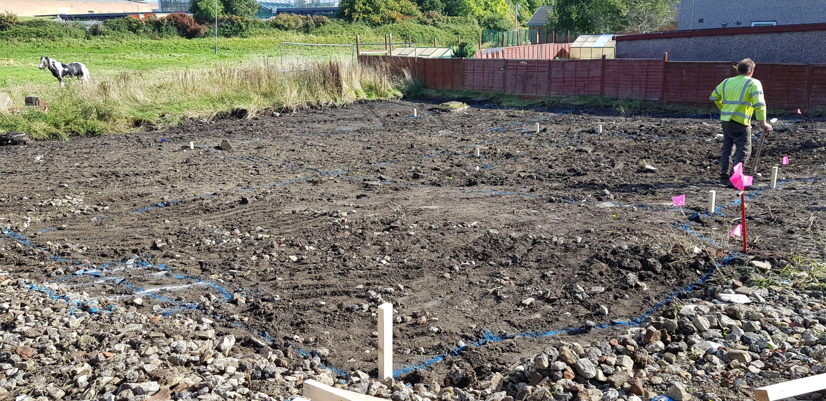

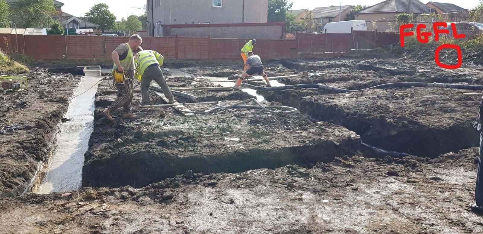

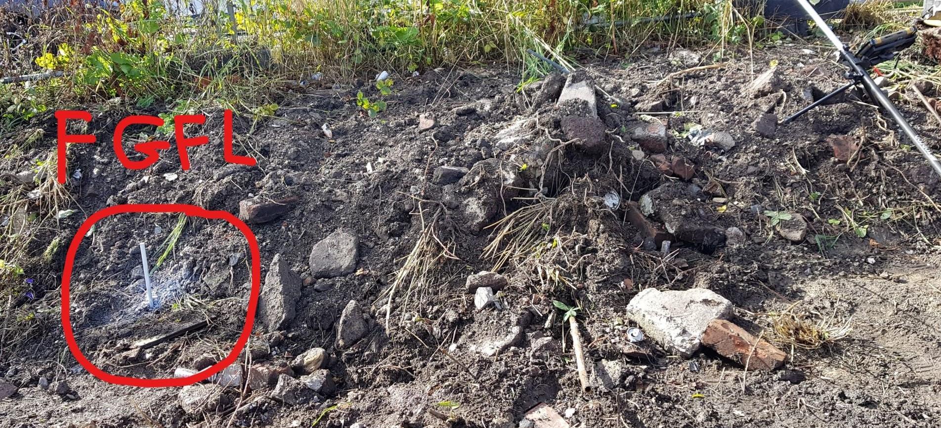

  12. Site marking out and finished ground floor level rod/marker.
  13. The site engineer did all the markings and placed pins (on top of foundation) at each corner for the bricklayers. He also, placed a metal rod in the ground with finished GF level. The bricklayers are working from these levels. We're going to have even number of courses of blocks. The site slopes from front to back so will backfill to raise ground level.

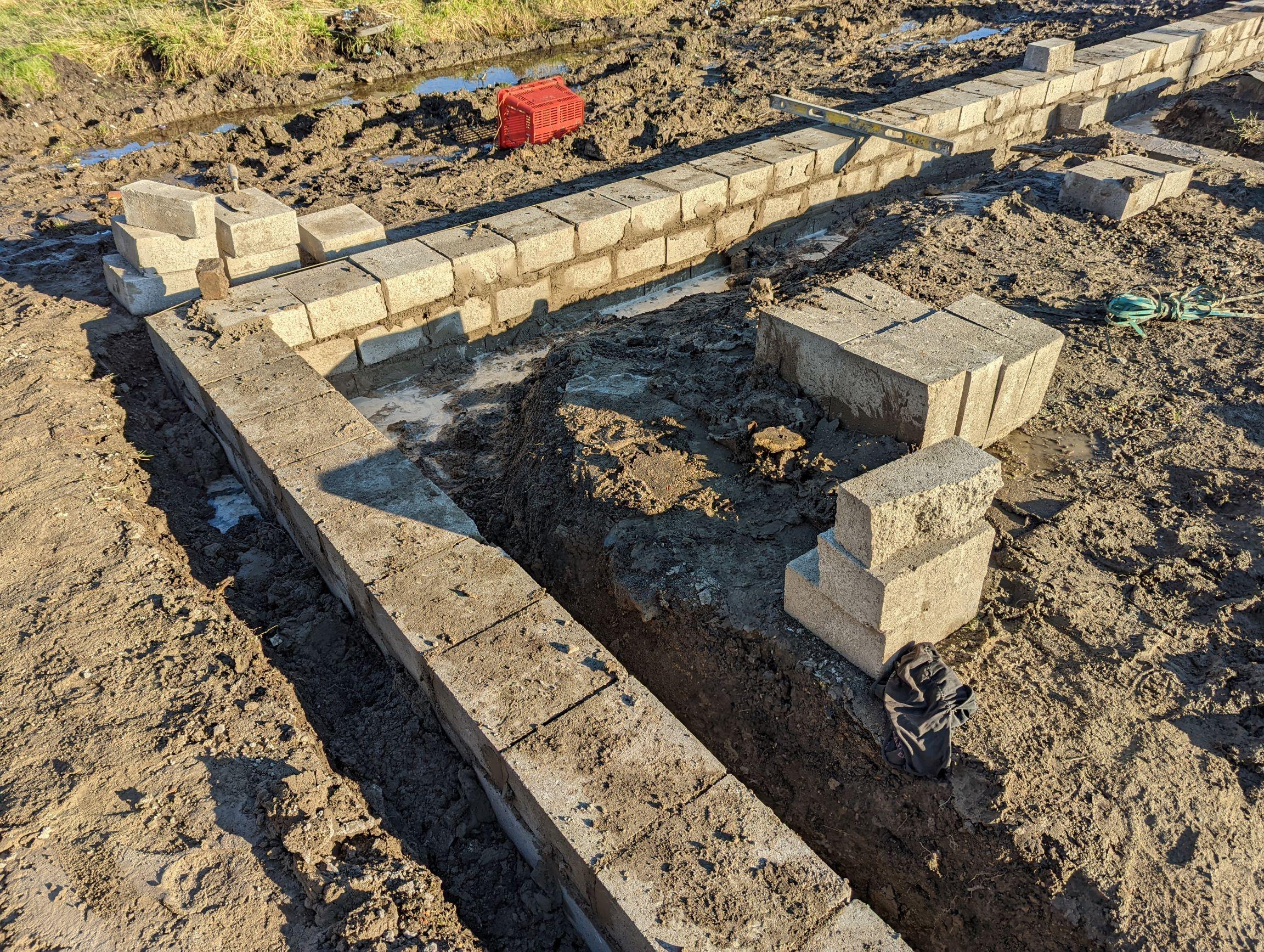

  14. Thanks They are using a laser level. The bricklayer I dealt with, who's not been on site yet due to covid, initially said he was going to do the corners first. When I told him that they have layed first course all around, he said this is common to get out of mud and water. Since, I have seen a YouTube video of a large development where they did blocks all around. Their site was similar to ours, flooded and muddy. The blocklayer can clearly be heard saying that they have to lay first course all around to get out of water. Is there a way to check the substructure quality? Perhaps an inspection company or to call out the building control officer? Thanks

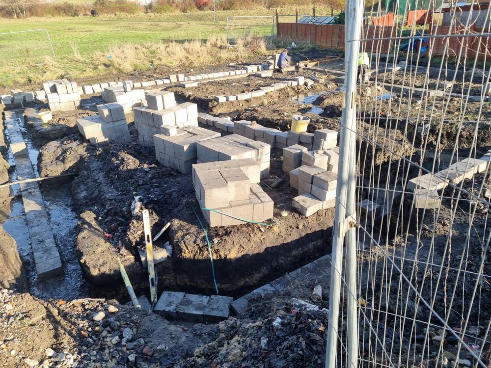

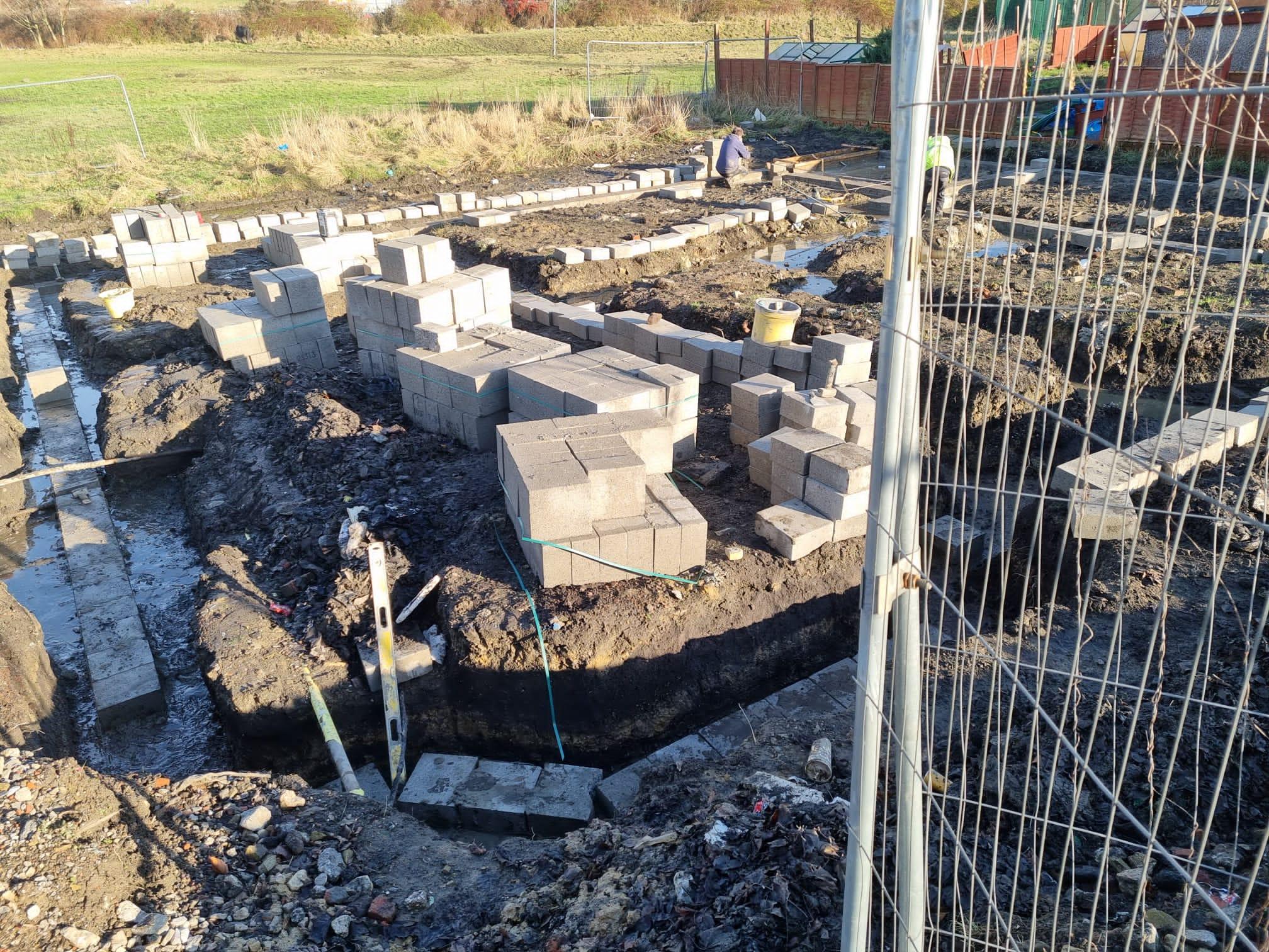

  16. Hi I have three experienced lads working on a substructure of a new detached house on a day rate. They have been working for three days now but it appears to me that they're slow, very slow, laying trench blocks 300x250x140mm. Three days now and they have only manage to lay just one course. Does this seem right? What is the average number of trench concrete blocks 300x250x140mm that one (experienced) bricklayer can lay? Ready-mix substructure mortar is supplied. Thanks

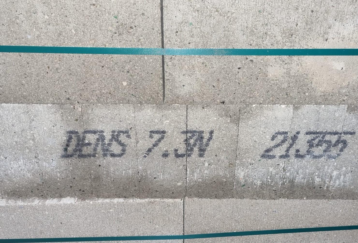

  19. Thank you nod. Thank you Gus potter for a very detailed reply. I don't have a SE. I thought 10N blocks would be better up to first floor. Just for a piece of mind, Above first floor would be 7.3N blocks.
  20. Hi all I ordered 10N concrete blocks. However, it's stated 7.3N on the delivered concrete blocks. I contacted the building merchant and their supplier states, "our 100mm 7n concrete paintgrade are manufactured to 10.5n strength". I'm going with ground and first floor block and beam floor. Would 7.3n concrete blocks be sufficient to take weight of the block and beam floors? Any advise highly appreciated. iMCaan
