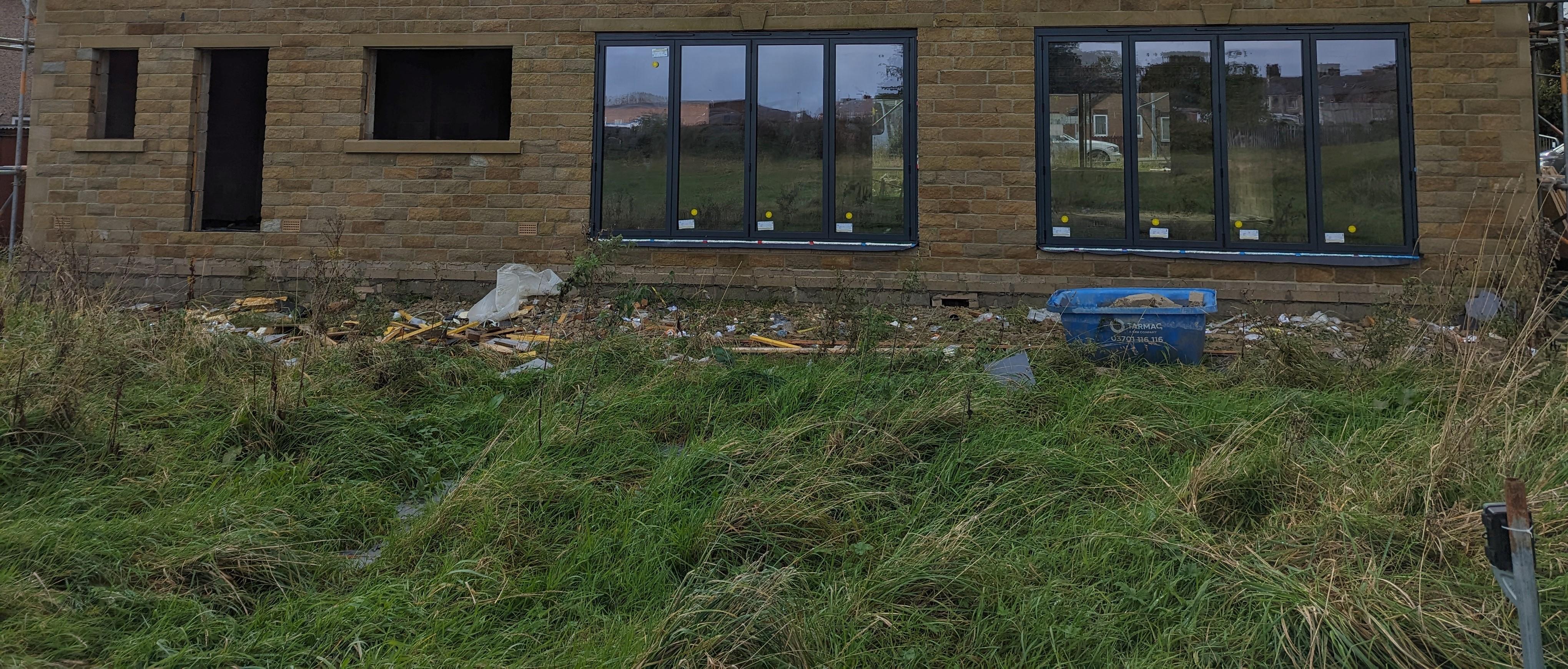

  8. Thanks @Mr Blobby The sewer runs through the back garden towards the garage. The lounge side soil pipe would just about be the furthest away from the sewer. It won't completely be hidden. At the back of the house is a field which will be developed sooner or later. I was considering taking the lounge side soil pipe outside and dropping it at the back corner (dining area) next to the rain gutter downpipe. Twists and turns but it'll be higher up. Obviously, keeping both rain and foul water pipes completely separate. We will be installing an inspection chamber. Do all soil pipes need venting or just one? Can the vent pipe be smaller in diameter than soil pipe which I believe is 110mm? The lounge side is a gable end. There's no window above the FF on-suite bathroom. How high does the vent pipe needs to be from the on-suite window?
  9. Thank you all, this is very useful information. AAVs are not on the plans @Mr Blobby. We've not yet extended the pipes to bathrooms to the FF. Does a window and a mechanical vent do an equivalent job as a AAVs? If not, then I'll probably will have AAVs on the pipes if I decide to keep them internally. I don't mean to brag but our dominant (which was the objection in the original planning application) stone house with bay windows stands out on the street with brick houses. Therefore, I can't see people taking much notice of the pipes. Furthermore, the pipes will be obscured by trees in the garden and adjoining house. Thanks for YouTube videos, will check them out. I was looking at the drain air testing product on Screwfix but didn't get it because of poor reviews. I'll check out Horobin.

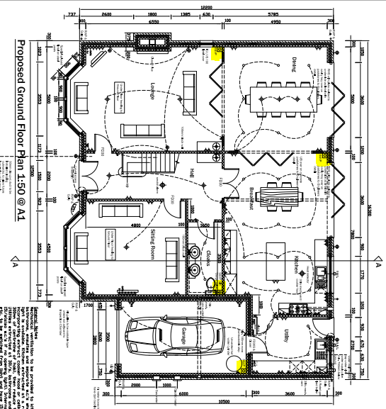

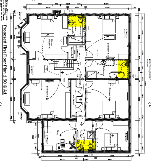

  13. Thank you for the comments. The most concerning are the ones in the living room and in the kitchen. The third is in the garage. All three are in the corners. All three would need boarding up. I suppose my main concern are leakage and the noise from while the waste/water gushes down the vertical soil pipe? The other concern is a leakage, which would cause a stinking damage.

  15. Hi My builder has followed the architect's drawings and fitted four big brown soil pipes internally. I can understand one of these is required for the cloakroom on the ground floor but the other three are solely for the first floor bathrooms. I understand I can hide them with a timber frame and plasterboard. However, I can't see any benefits of them being inside. Therefore, I prefer put them externally straight out of the bathrooms on FF. Does anyone see any issues with running the soil pipes externally? At the moment the soil pipes are just sticking out about a 600mm from block and beam GF (both GF and FF are block and beam). We have not yet installed the UFH. Would it be better to cut down the soil pipes flush with block and beam floor and cap them off? Your comments are highly appreciated.
