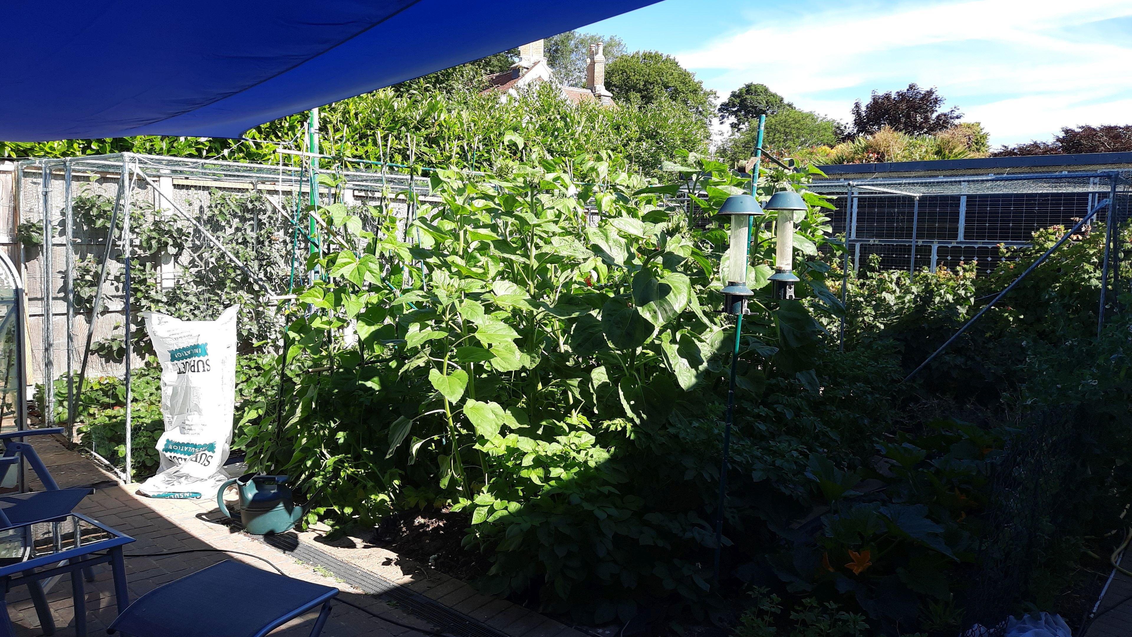

How much rainwater are you going to use in your garden?  Well that's a good question and trying to work that out is basically a waste of your time because when its raining you won't need to water the garden. Is it going to rain when you need it is the impossible question to answer. so we used a pessimistic view.

  2. and Garden 200 litres a day for a 6 week drought = about 4200 litres or 4.2 cubic meters. (This was based on 200 drippers supplying plants (no lawns) 0.5 litres a day each)

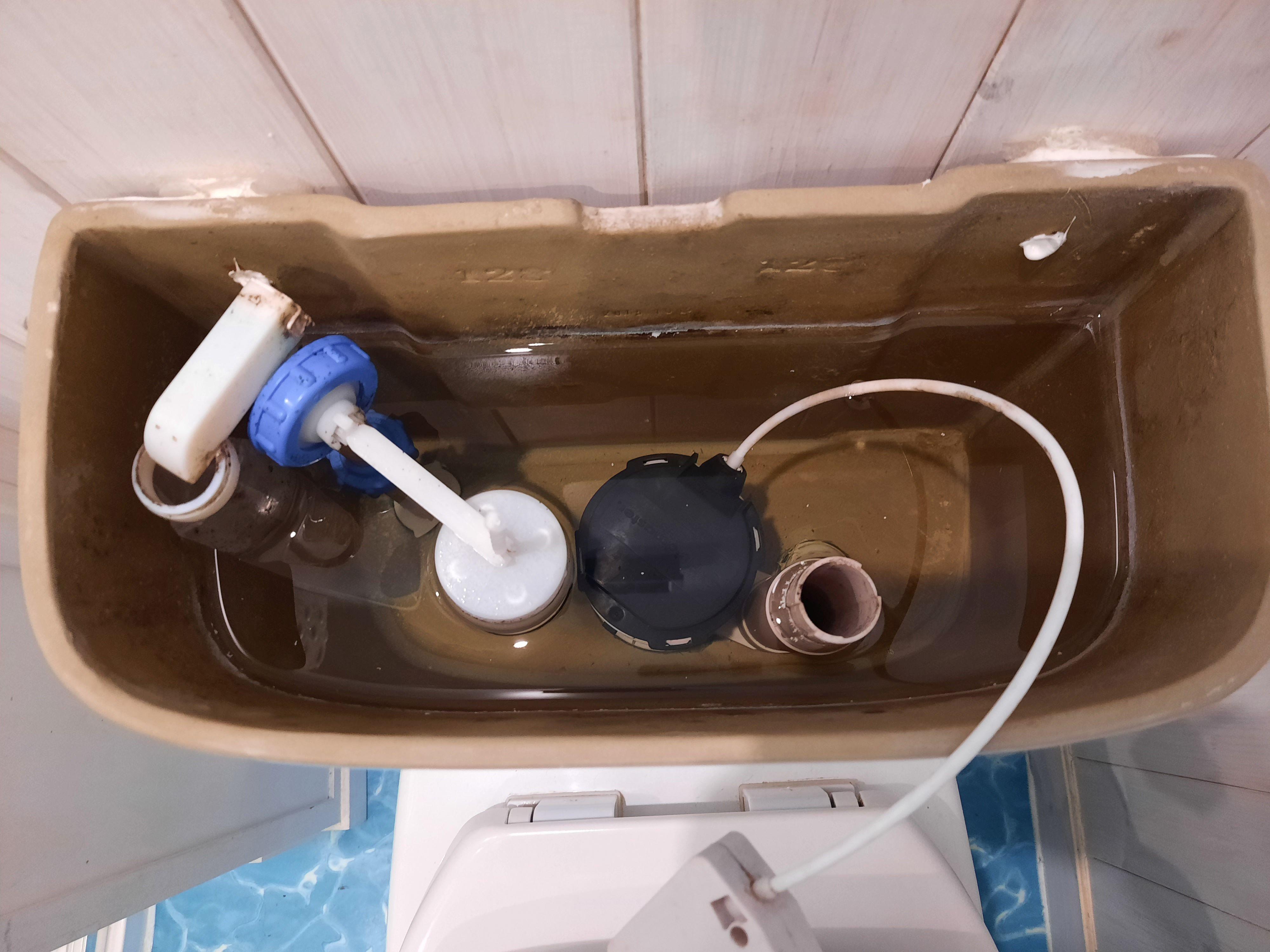

So this is what our loo water looks like after 4 years:
No smell, no clogging up valves no discolouration.
and the garden:
Yes we run out of rain water, and have a backup from the mains.
