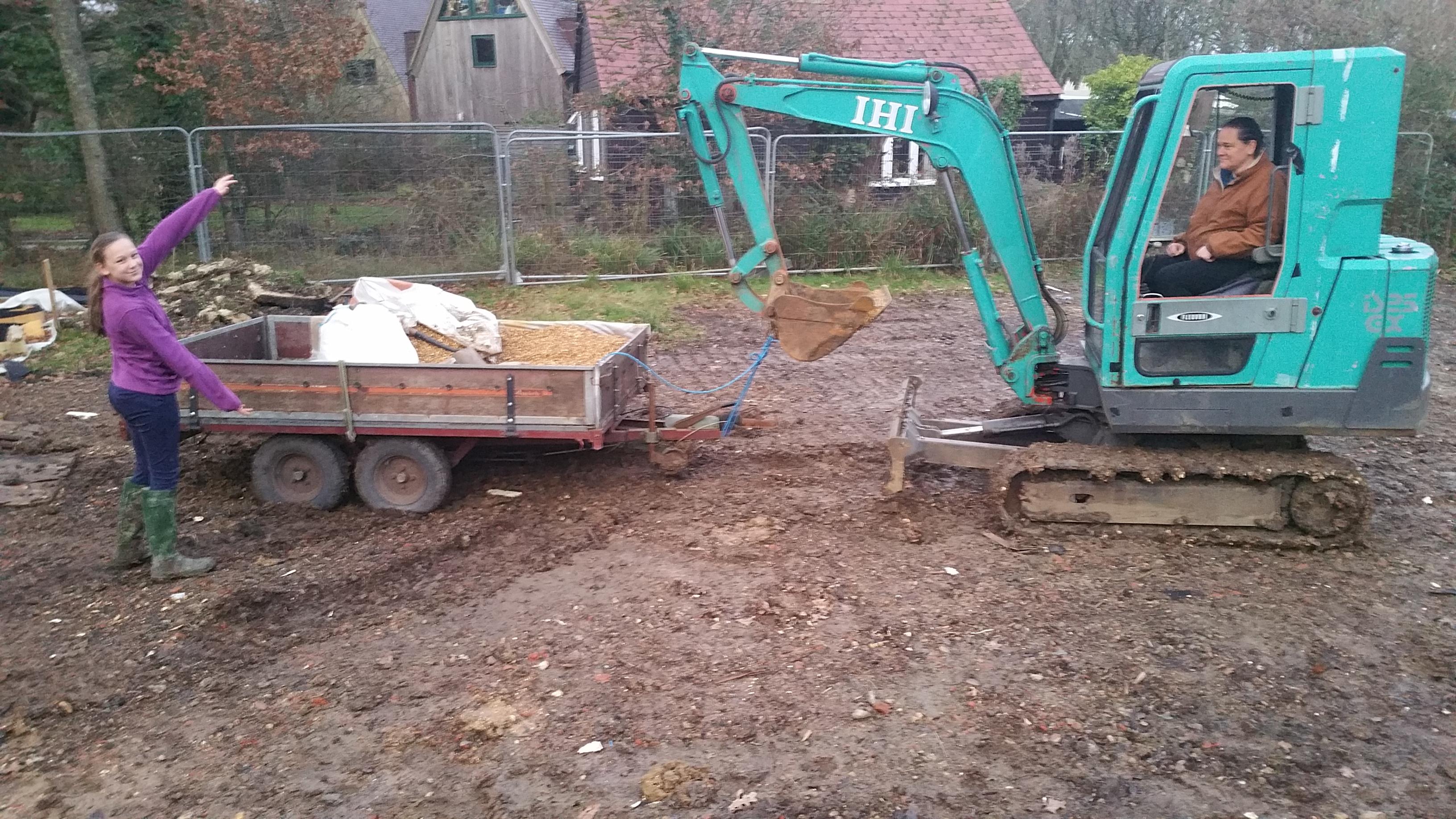

So a few phone calls later and I had my stone order accelerated and had found a very speedy digger driver for a day and a half. I'm still learning the art of grading with a digger and I haven't got time to mess about. Besides, who is going to walk around with the surveying stick saying "a bit more off here!" if I don't?
Job one was to complete a piece of French drain along the front third of the southern edge of the property. Due to the lack of dumper truck, we improvised a stone carrier.

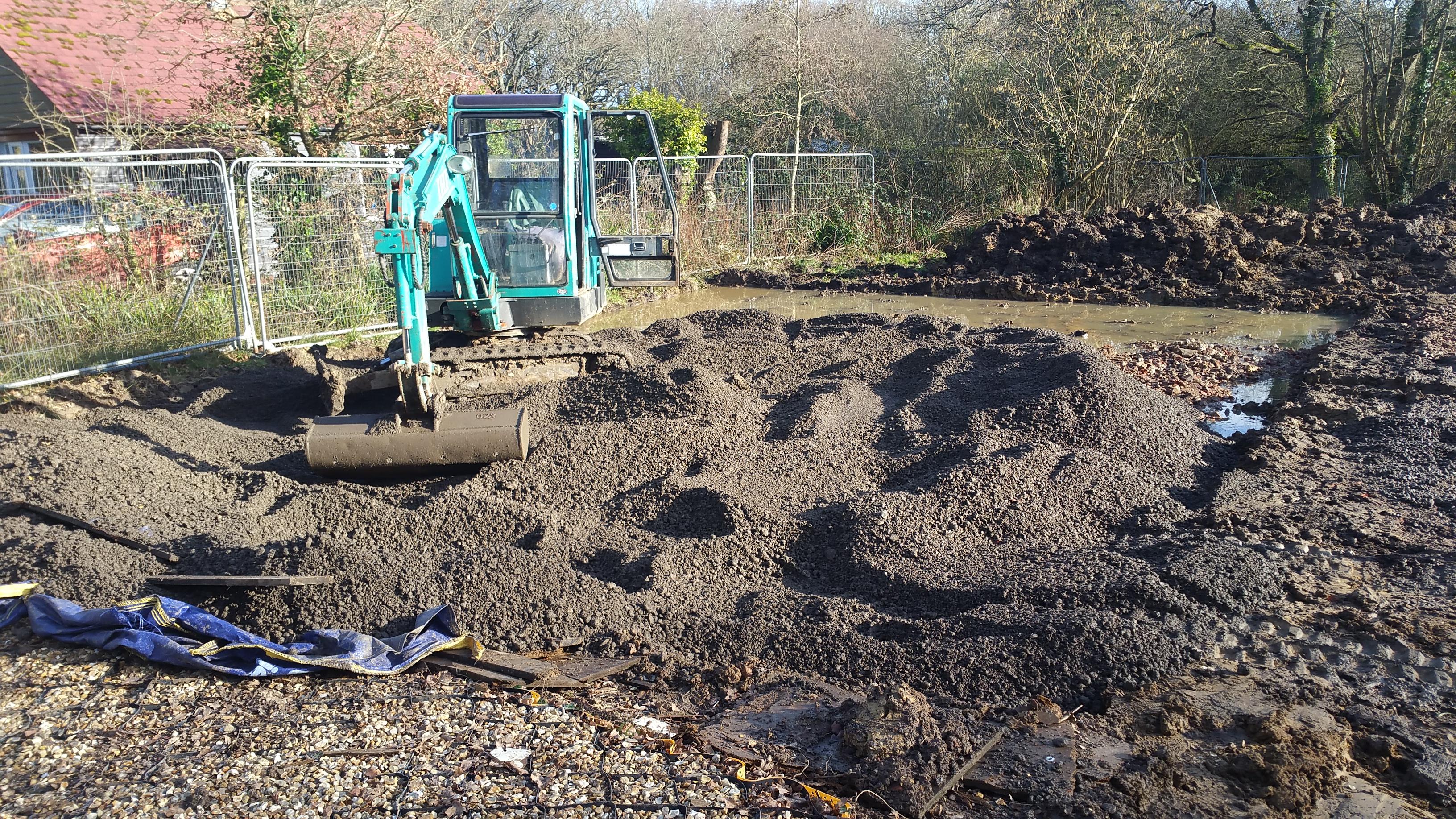

We skip a few steps now because I didn't have a camera for most of the grading work. The crushed tarmac arrived for most of Wednesday morning and I spread it about until it got dark. I didn't get all of it finished but there was enough flat ground to get a good start on the first few piles. This is after the first 20 tonnes arrived. There should be no surprise that it rained the previous night so I had to deploy a pump to empty the garage footprint lest it turn to a swimming pool.

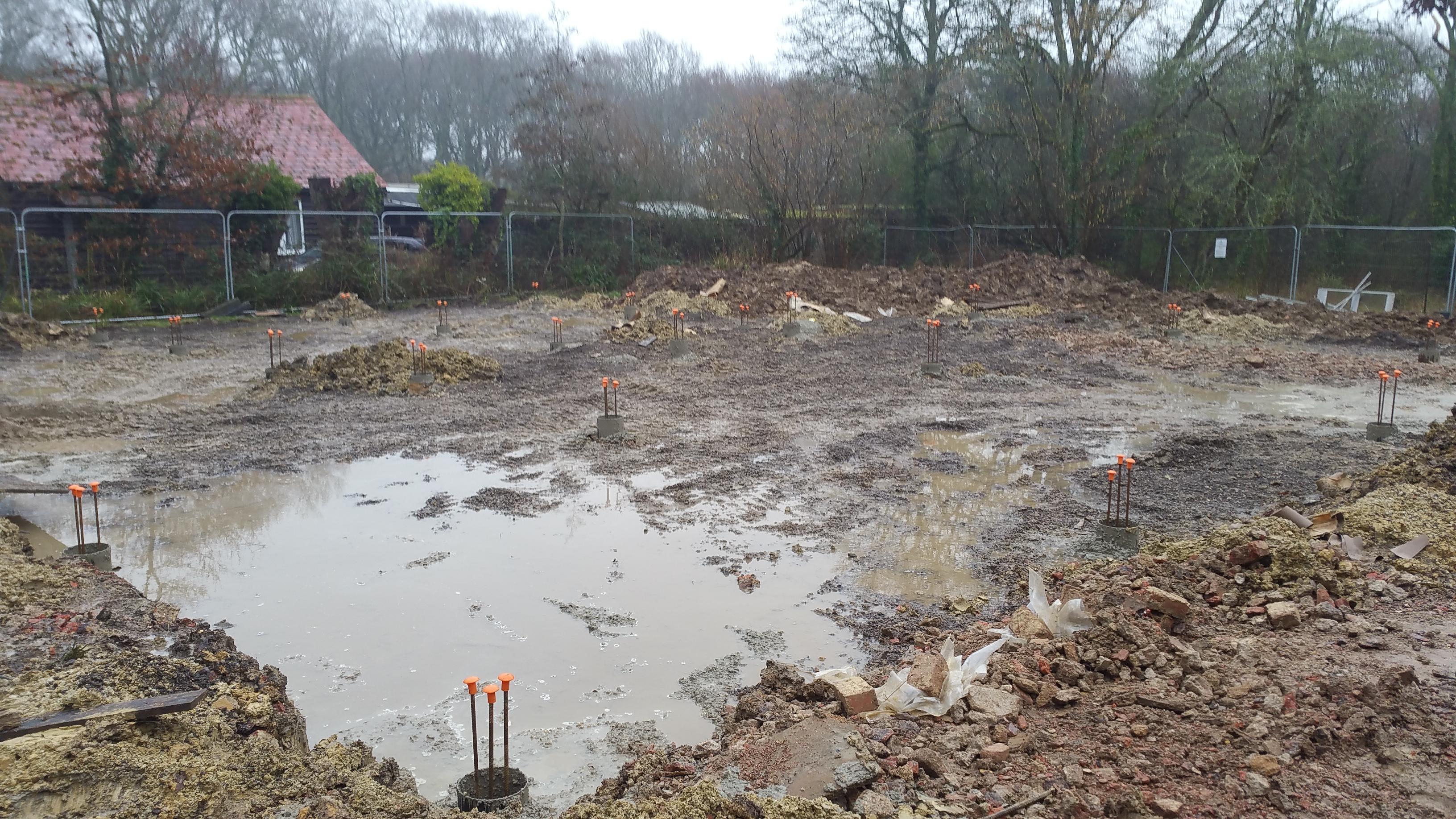

I spent the morning of Thursday marking out the site with a couple of decent tapes and a laser level. It should be good to 10mm or so all things considered. This is (hopefully) adequate for groundworks. The ring beam will cover the multitude of sins, I am reliably informed by the machine operators!

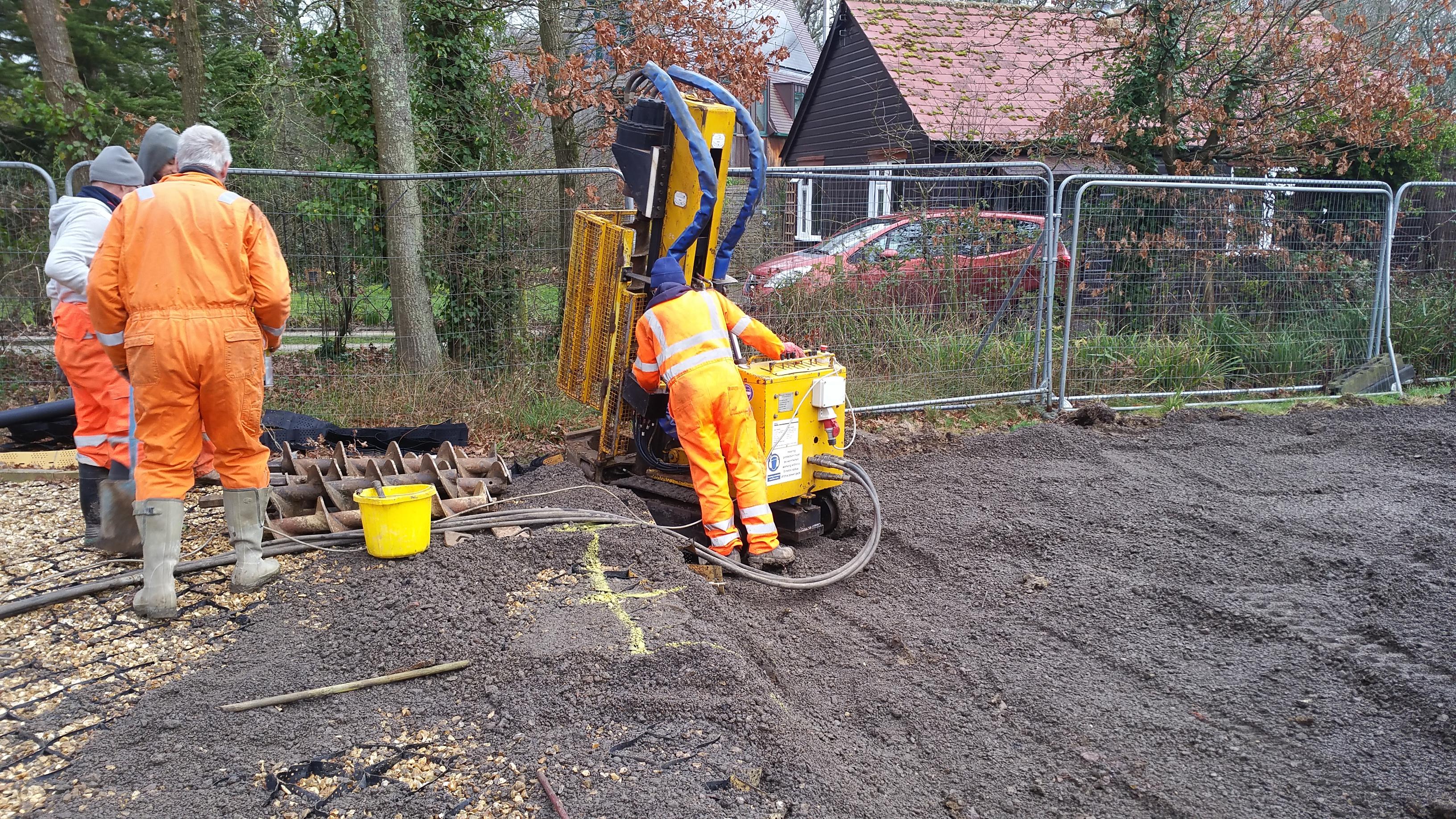

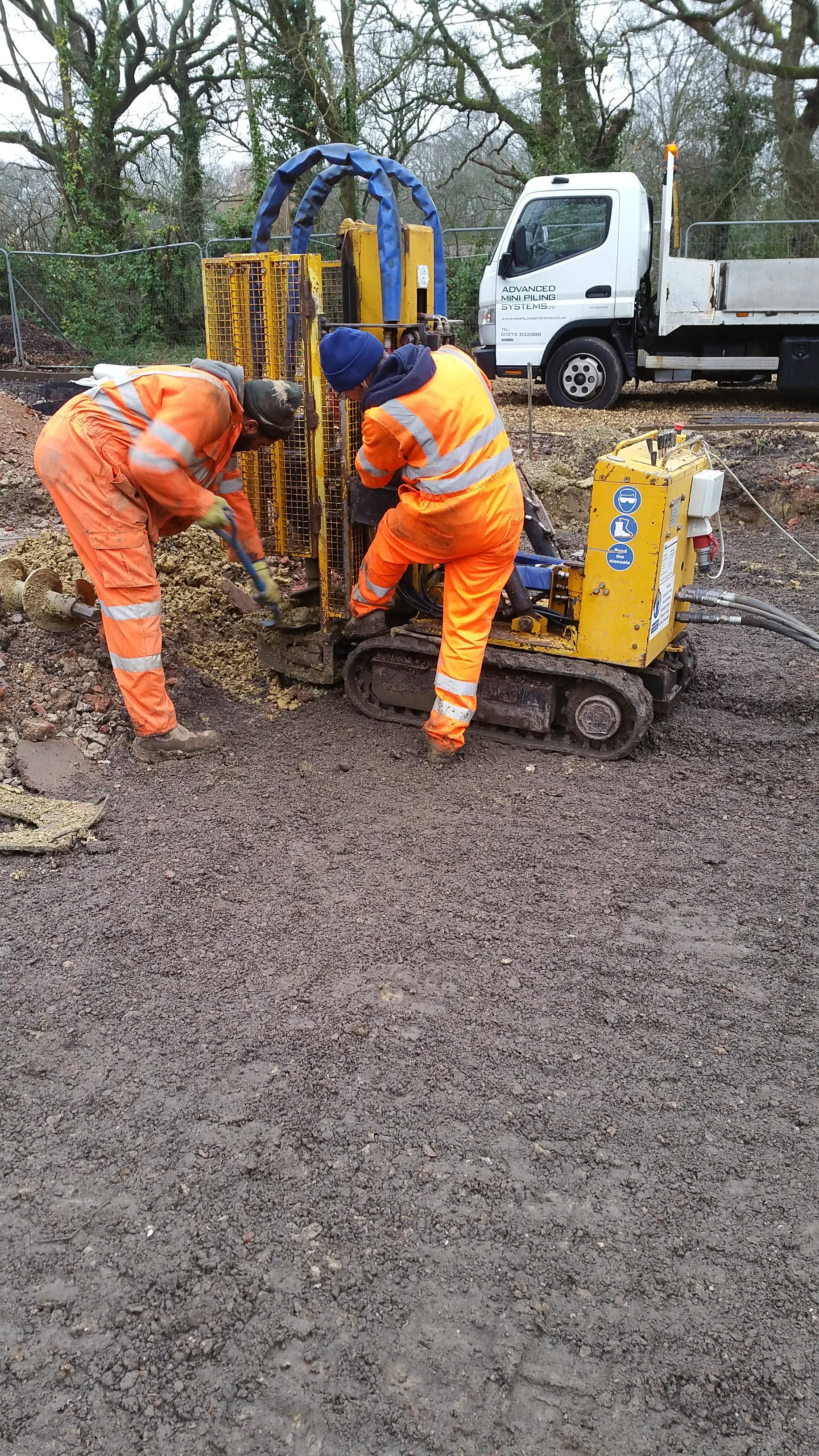

The first pile hole being drilled. A momentus occasion - we are finally under way with the build. The plan with the piles is to auger down to 3 metres, through the reasonably clean clay to where it starts to contain a lot of chalk particles and an awful lot of water . The anti-heave sleeves will then be fitted (the most expensive toilet roll middles I've ever seen) and an end driven steel pile will be installed to approximately 8 metres.

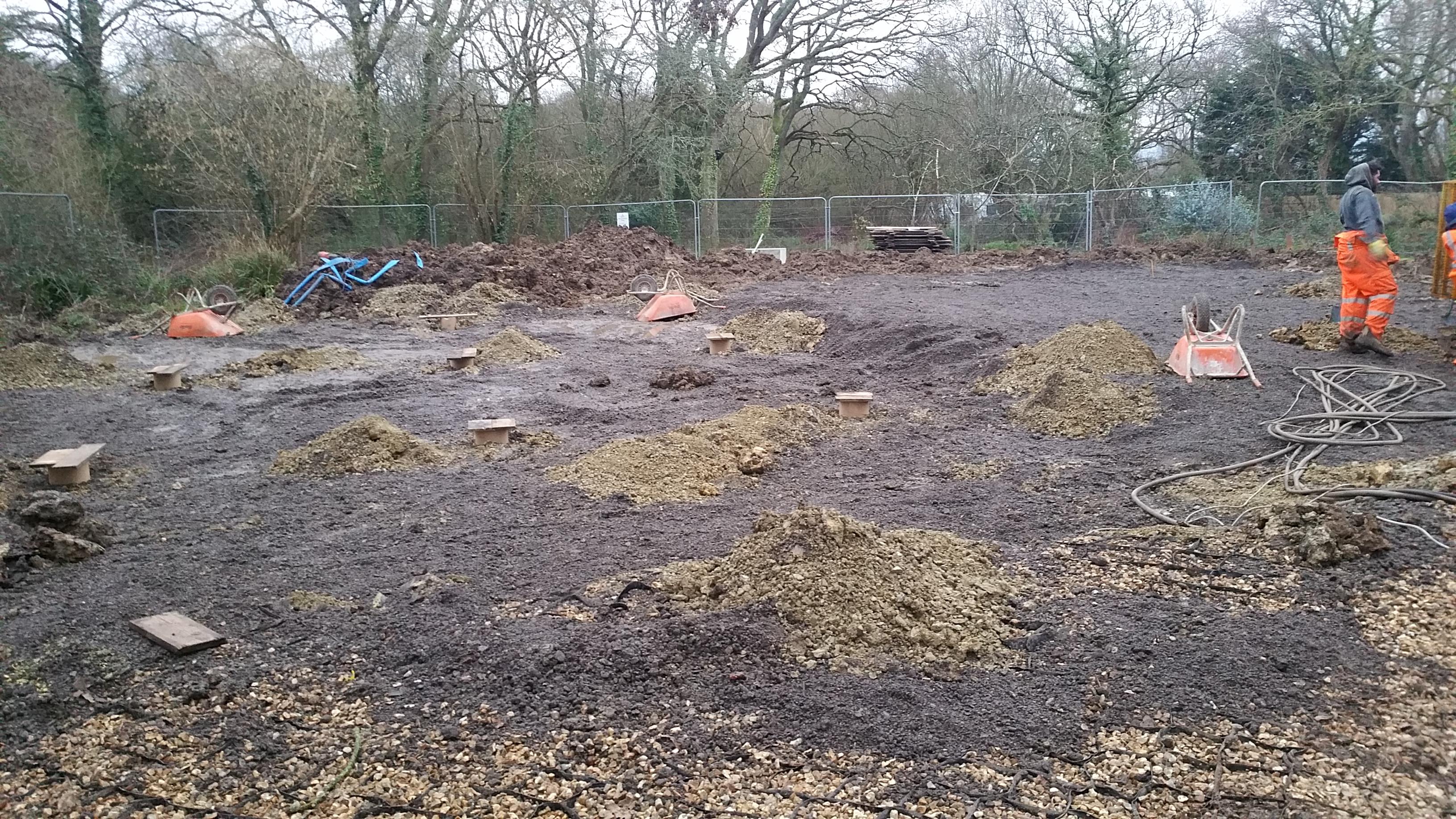

More drilling and shovelling. The team can work at quite a pace!
Even an attack of super moles doesn't put the team off their game. Most of the sleeves are now installed.

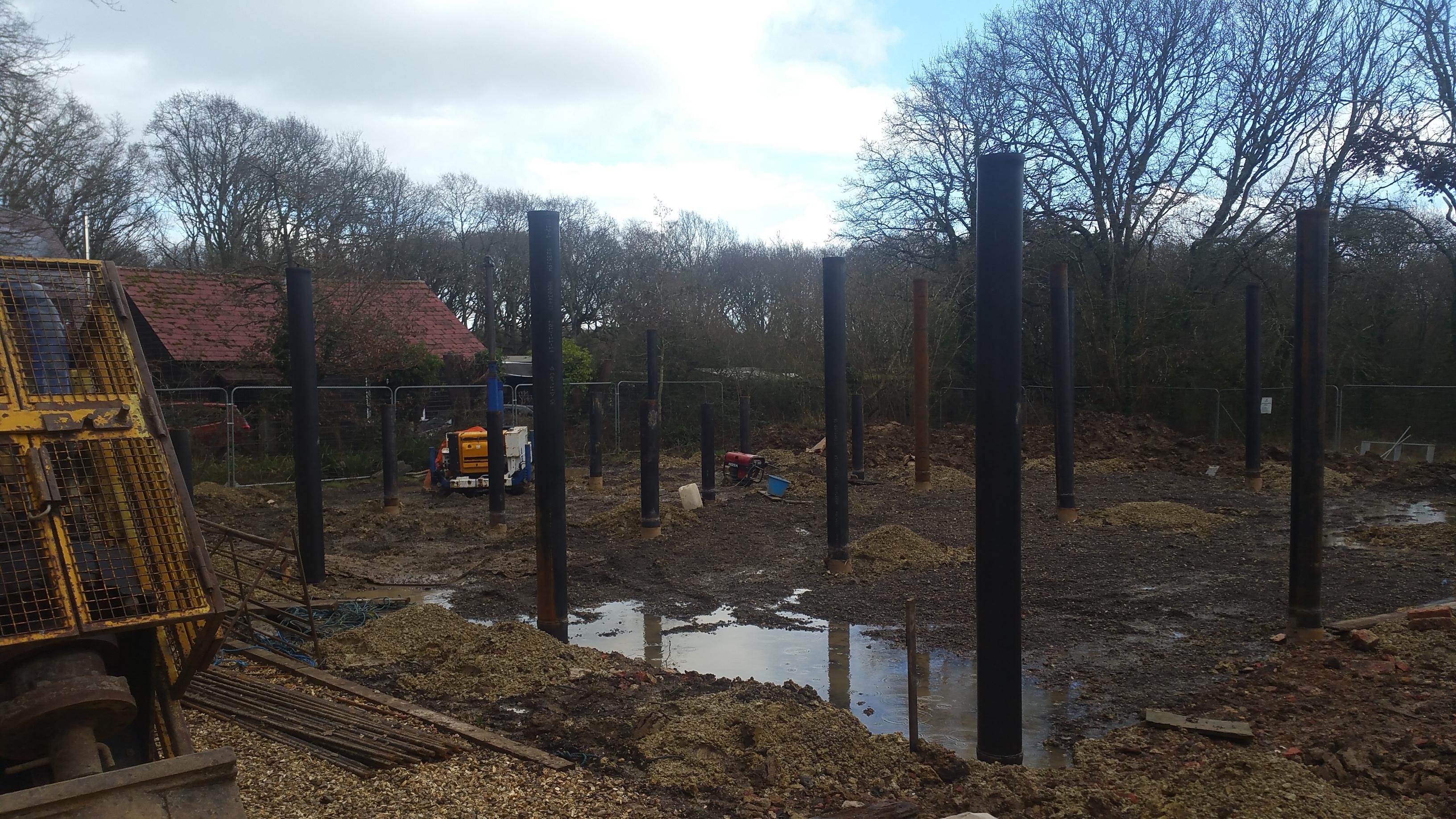

Little did you all know, I am secretly building a multi-story car park. The piles are ready to be hit with the large hammer on a string. Sometimes brute force is the best way.
All piles installed and concreted. Oh and it rained again for a change.

That’s a large span from pile to pile. What size is the ring beam.
dnb
Posted
The ring beam is 600x450mm of steel re-enforced concrete. The spans are in the main a generous 3 metres each.
I trust the structural engineer's calculations. What could possibly go wrong? ?
