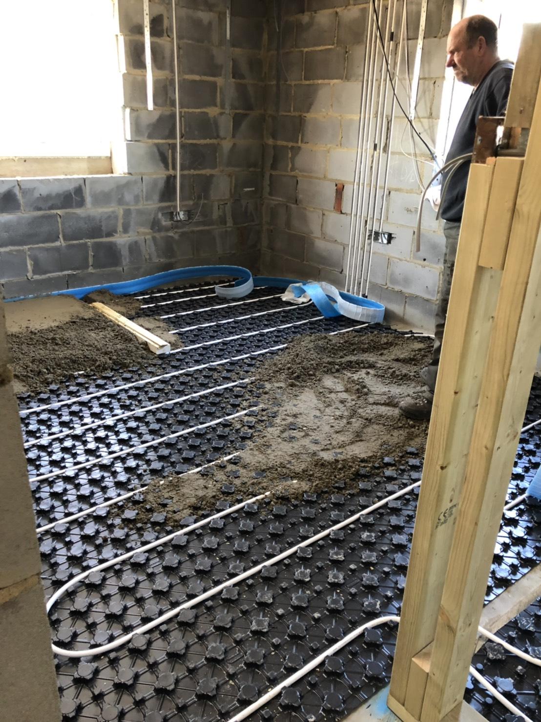

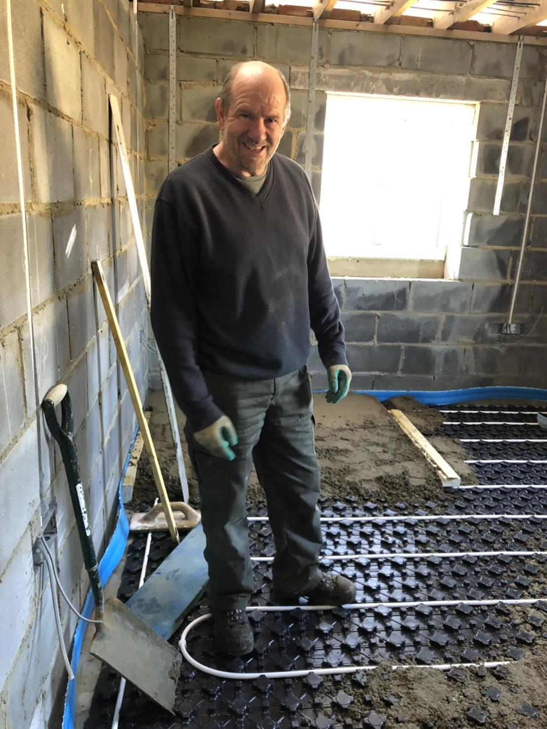

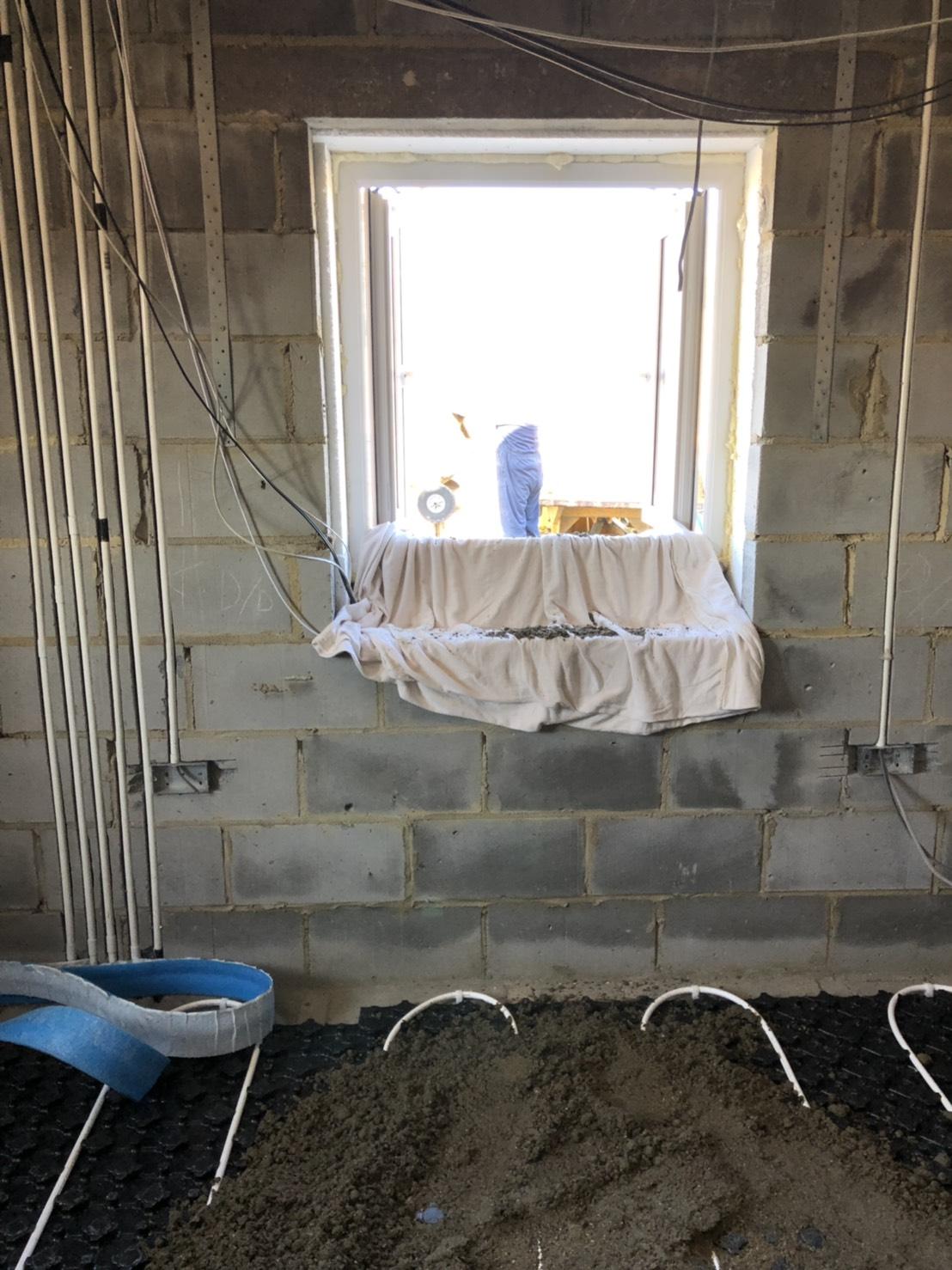

Onoff 6180 Posted February 19, 2019 Picture 1 & 4.....what are the (5?) conduits running down left of the 2G socket? As in not in the safe zone.....how will anyone know not to drill? Link to comment
ProDave 8403 Posted February 19, 2019 2 minutes ago, Onoff said: Picture 1 & 4.....what are the (5?) conduits running down left of the 2G socket? As in not in the safe zone.....how will anyone know not to drill? Nice spot. If you have to do that, put them in a corner which will be in a safe zone. Link to comment

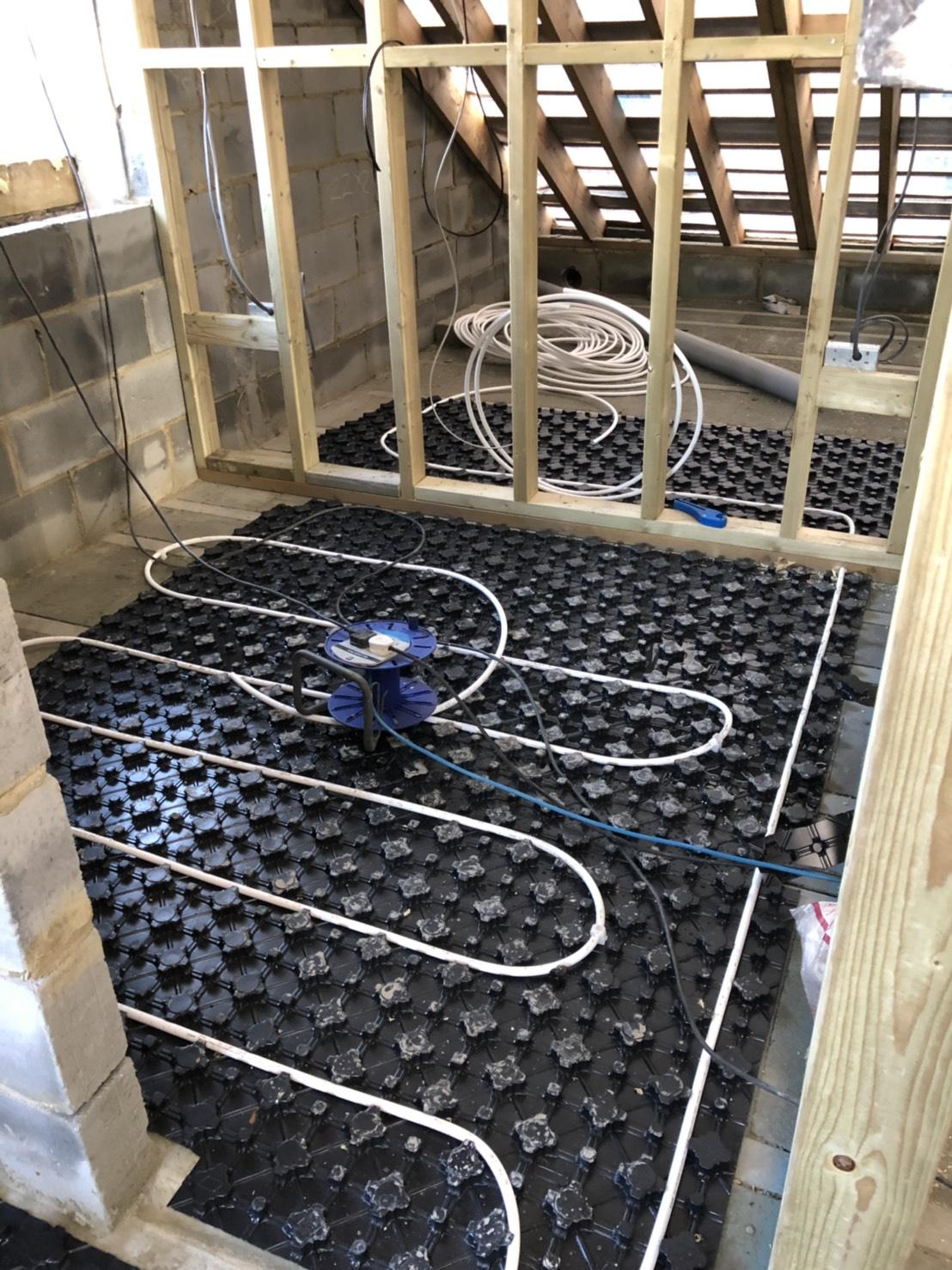

PeterW 5449 Posted February 19, 2019 Centres on those pipes seem about 350mm - seems very wide ..?? What insulation is under the floor ..? Link to comment
Onoff 6180 Posted February 19, 2019 3 hours ago, ProDave said: Nice spot. If you have to do that, put them in a corner which will be in a safe zone. 150mm either way from internal corner.....aka the "shelf bracket zone" to Joe Public! ? Maybe if they taught safe zones in school? Link to comment
Ed Davies 484 Posted February 19, 2019 (edited) They would be in a safe zone if they go to a row of network or AV sockets just above the floor. Do the rules about heights of sockets apply to those? Edit to add: at least in Scotland they'd have to be at least 400 mm off the floor (“…and outlets for other services such as telephone or television…”). Edited February 19, 2019 by Ed Davies Link to comment
Ed Davies 484 Posted February 19, 2019 1 hour ago, PeterW said: Centres on those pipes seem about 350mm - seems very wide ..?? What insulation is under the floor ..? From the start of the OP, my emphasis: Quote Under floor heating going in up stairs Link to comment
Onoff 6180 Posted February 19, 2019 1 minute ago, Ed Davies said: They would be in a safe zone if they go to a row of network or AV sockets just above the floor. Do the rules about heights of sockets apply to those? Socket and switch heights are from Part M "Services & Controls". Page 9: https://www.gov.uk/government/publications/access-to-and-use-of-buildings-approved-document-m BCO might pick up if you deviate. A socket is a socket whether 230V or AV / network and should be accessible. If you do run in a line then you'll need to separate the LV lines and "network" stuff with insulated conduit or trunking. Link to comment
PeterW 5449 Posted February 19, 2019 8 minutes ago, Ed Davies said: From the start of the OP, my emphasis: Agree however that’s beam and block so the whole of the floor structure is being heated ..?? Hence my question as otherwise the heat is lost into the cavity etc Link to comment

sussexlogs 134 Posted February 20, 2019 (edited) On 19/02/2019 at 16:49, ProDave said: Nice spot. If you have to do that, put them in a corner which will be in a safe zone. 18g steel over the top will be safe and it is cat 5. Tv. Phone Edited February 20, 2019 by sussexlogs Link to comment
sussexlogs 134 Posted February 20, 2019 21 hours ago, PeterW said: Centres on those pipes seem about 350mm - seems very wide ..?? What insulation is under the floor ..? The bedroom no need to be hot.and no insulation Link to comment
sussexlogs 134 Posted February 20, 2019 20 hours ago, PeterW said: Agree however that’s beam and block so the whole of the floor structure is being heated ..?? Hence my question as otherwise the heat is lost into the cavity etc Cavity is 175mm full fill so no heat lost Link to comment
