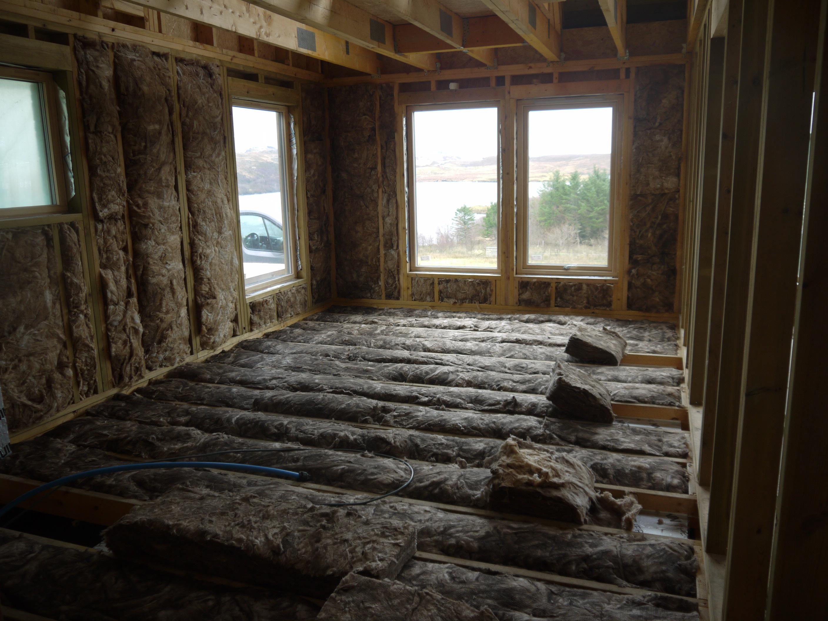

As the winter weather has prevented us from moving forward with the rendering and other exterior work we have been working on finishing off insulating the suspended timber floor.
We had a short wait for the plumber to install some drainage below joist level, once this was done it allowed us to finish off fitting the insulation boards. We then used expanding foam along the edges of the boards to ensure no gaps.
The next job was fitting the frametherm as the second layer between the joists. I'm using frametherm 35 between the studs but I wanted to use a 90mm layer of frametherm 32 on top of the quinn therm boards.
It's a bit more expensive for the frametherm 32 but the quality compared to the frametherm 35 is very noticeable.  I have found the quinn therm and frametherm work well together.
It took a while for the order to come to site and we had a bit of a race against time to get this fitted before our joiners came back on site to fit the chipboard, which is the next job on the list.

Yep agree with @Tennentslager, it really does look cosy and warm. Cracking shot of the outside too. I may have missed it but what heating system are you going for? Presumably UFH is not an option with a suspended floor or is it ? [excuse my ignorance on these matters! ?]

@Tennentslager I thought it looked like an old carpet from 70s, hopefully it will be warm. It was very itchy and scratchy to handle.
@Redoctober UFH is an option for a suspended timber floor. I think @ProDave has done this on his I believe you use a dry screed mix on top of the subfloor, don't know whether the system differs.

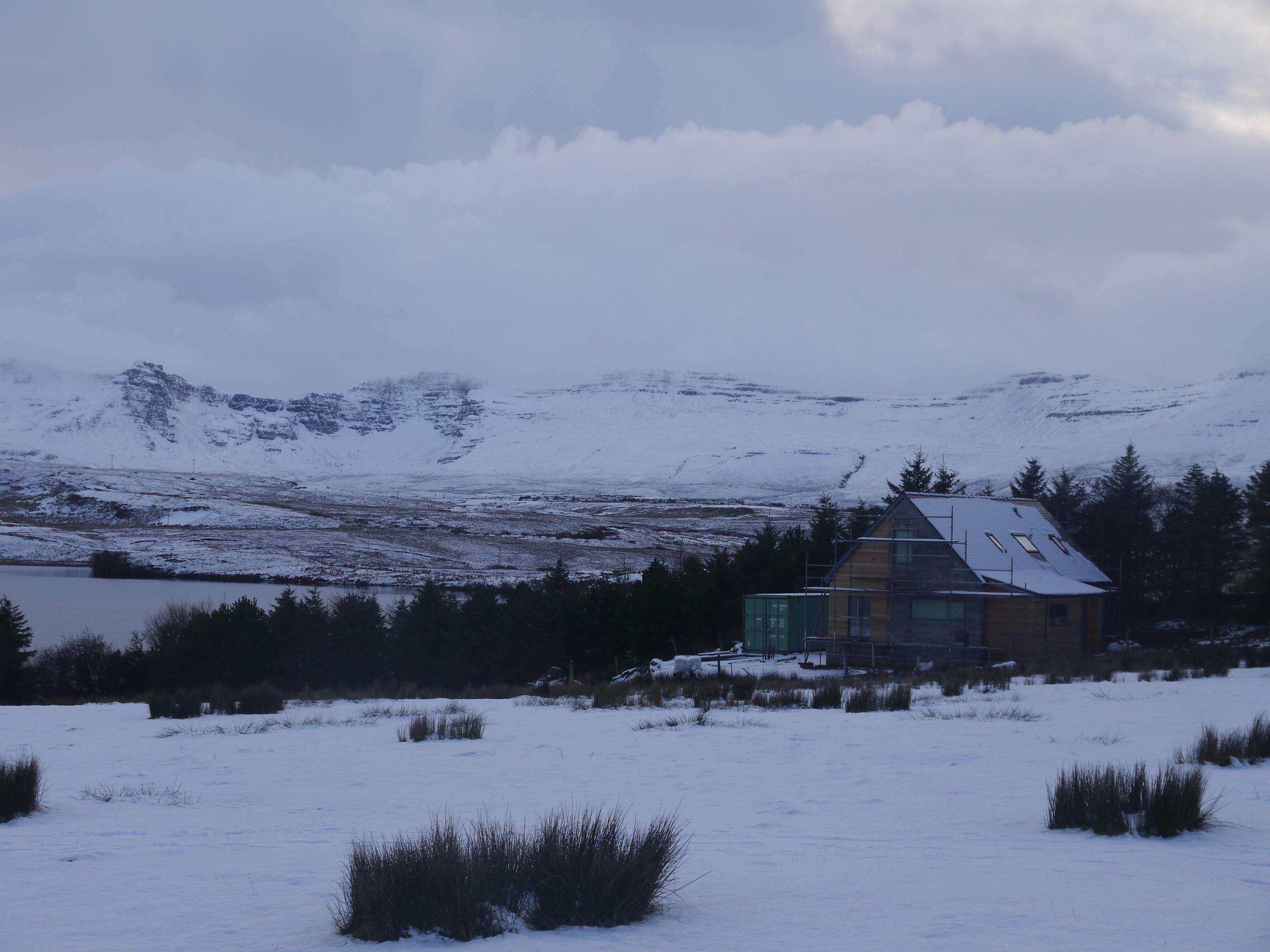

At the moment our heating is going to be electric and our stove. I want to utilise the firewood on our croft and hopefully next year make a peat stack. The house is classed as a crofter's cottage, so looking to use the croft to heat the house where possible.
I want to use the electric radiators really just as a quick boost early in the morning. Hopefully the amount of south facing will provide sufficient solar gains for most of the day.
Although it can be windy here, generally the temperatures are fairly mild through the winter and the recent snow was fairly rare. The house is well sheltered from the prevailing wind coming off those mountains behind the gable end and from those cold north winds behind the house.
Here is a couple more that my wife took when I was working overtime in the office ?
