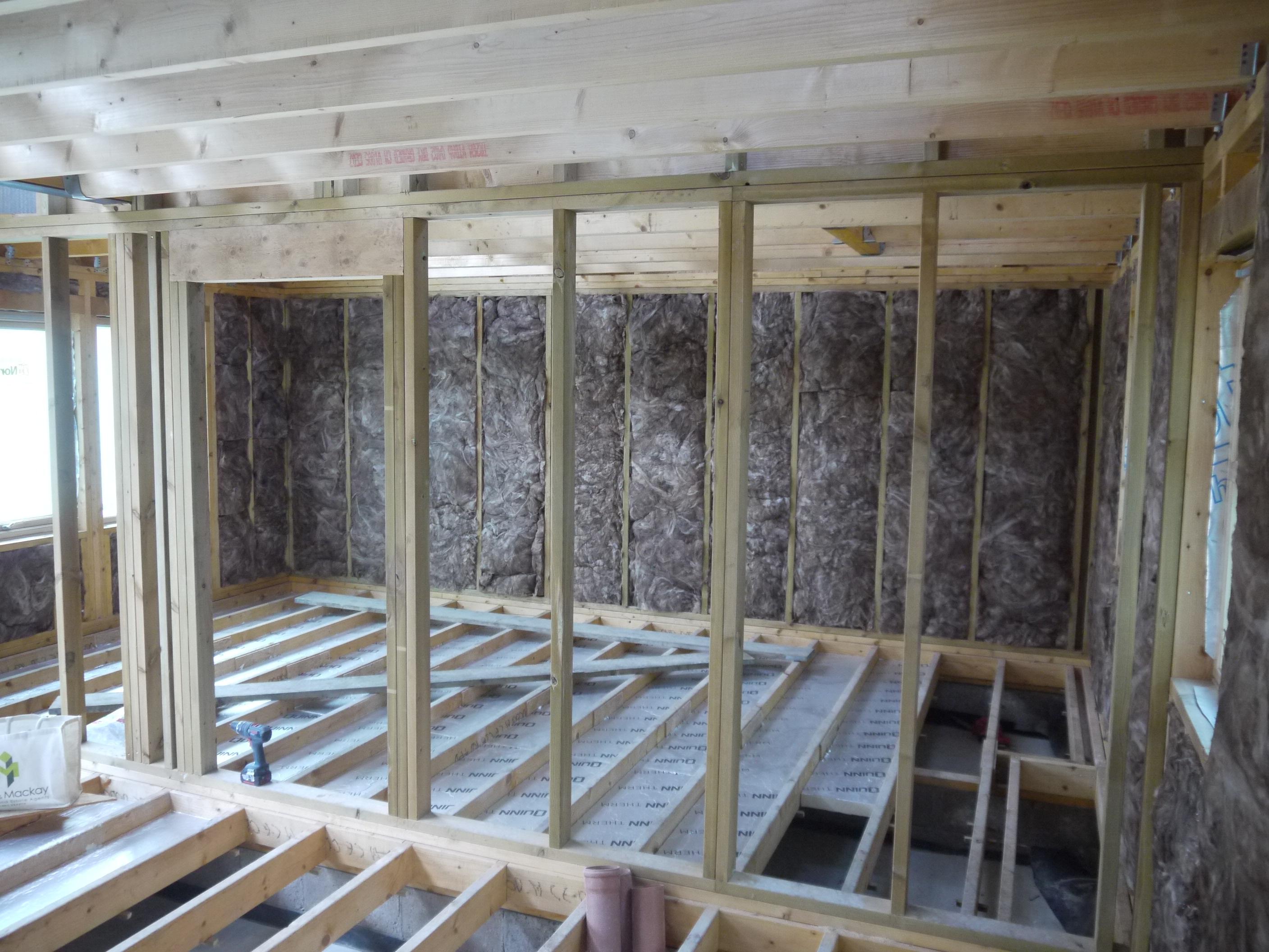

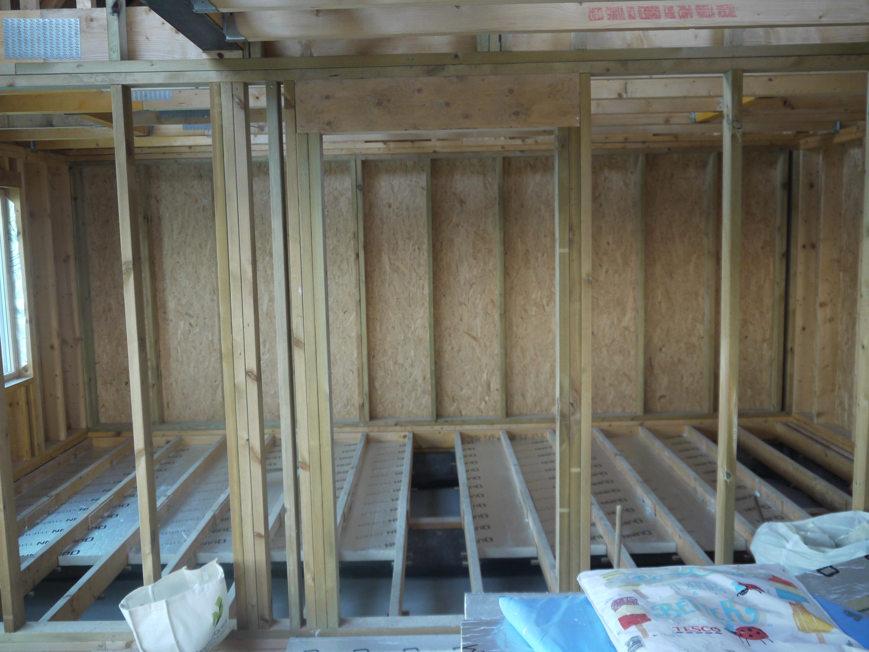

Starting to insulate the suspended timberfloor was the first job to do.

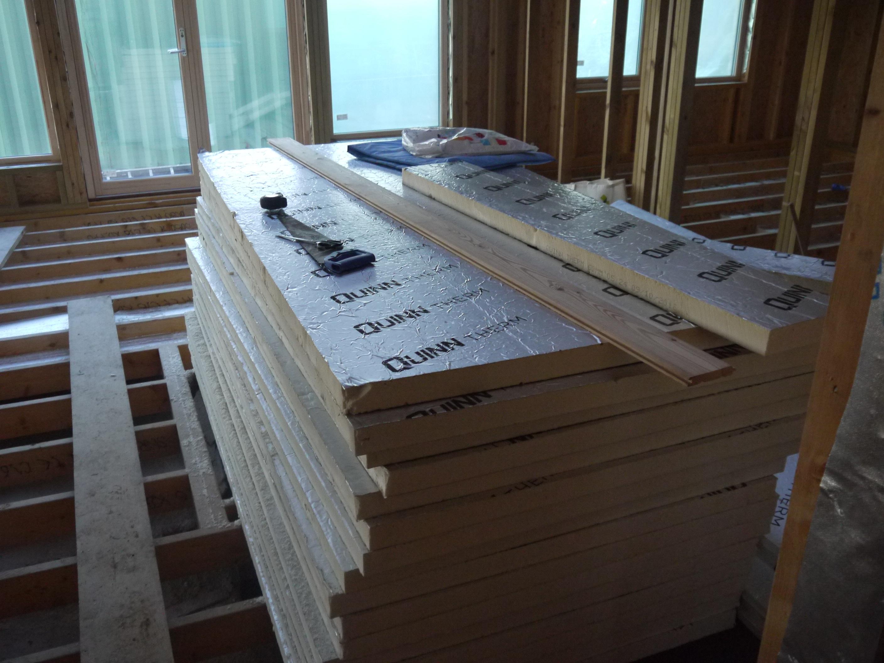

We attached some little bits of timber to the underside of the joists, which will keep the insulation boards in place. Our primary insulation for the groundfloor is Quintherm 65mm (another two layers of insulation will be added later). Once ordered these were then cut to size using a piece of wood to score a mark and then cut with a handsaw.
We left a bit of gap either side which will be filled with expanding foam to ensure a tight fit.

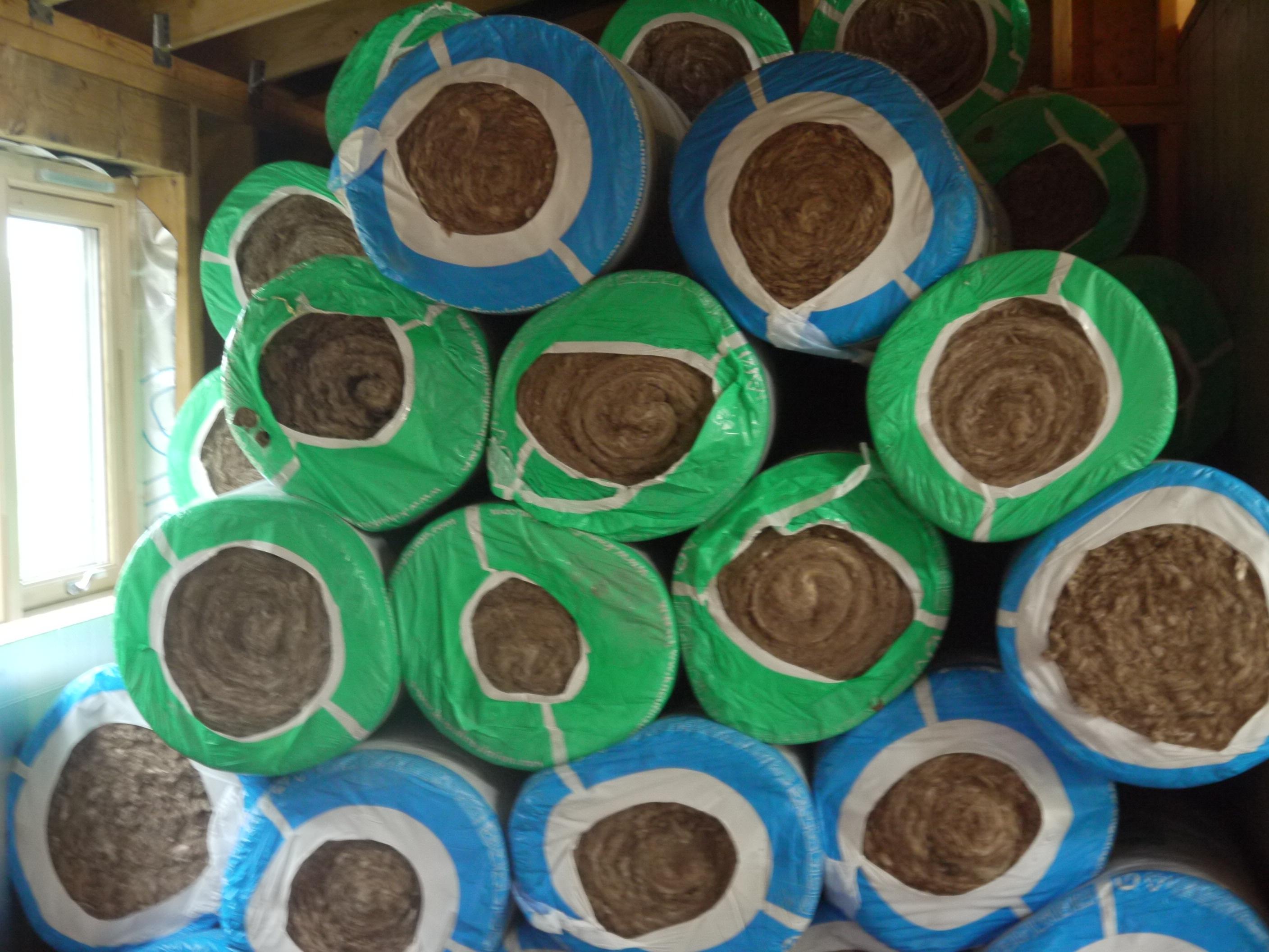

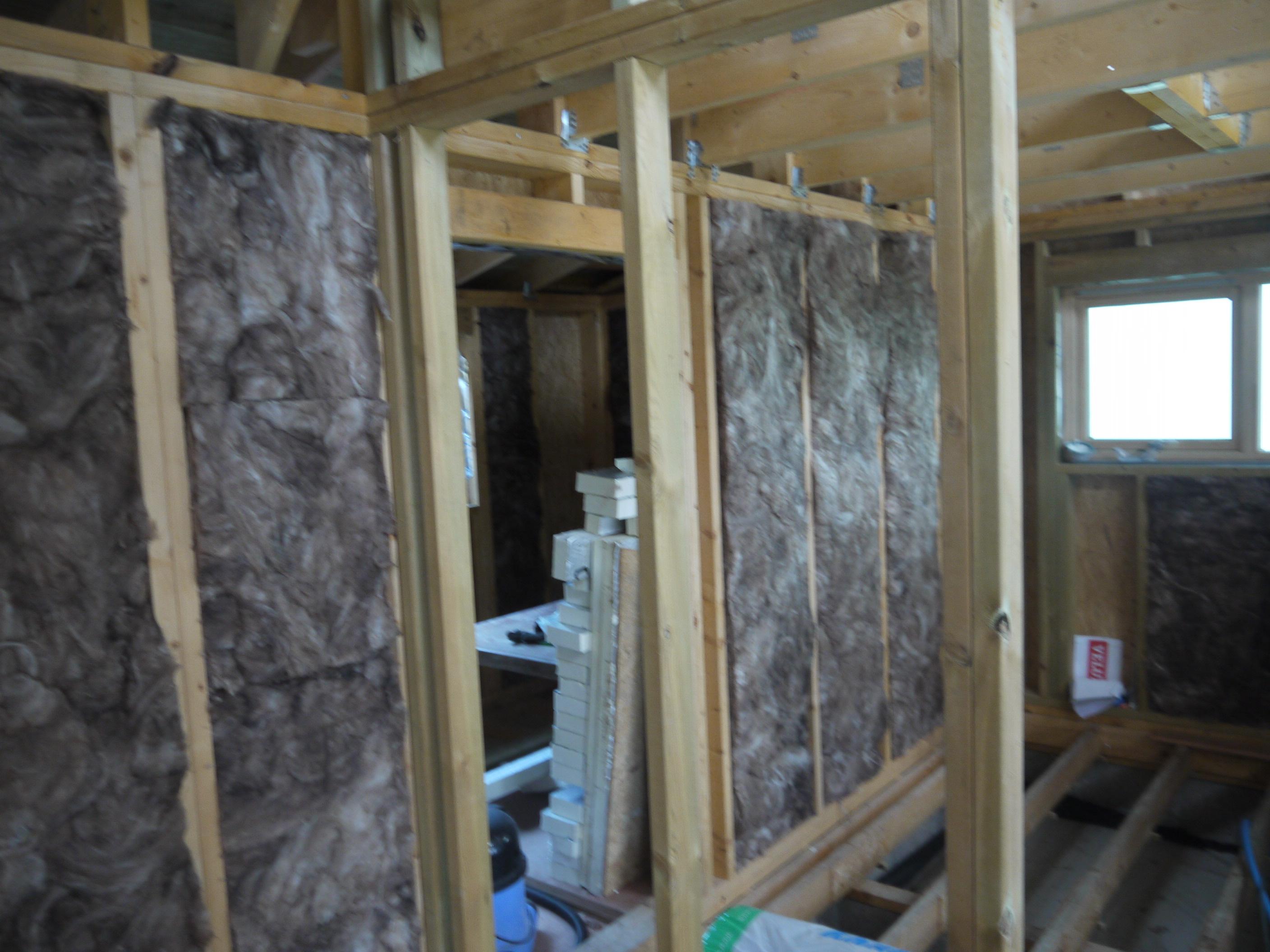

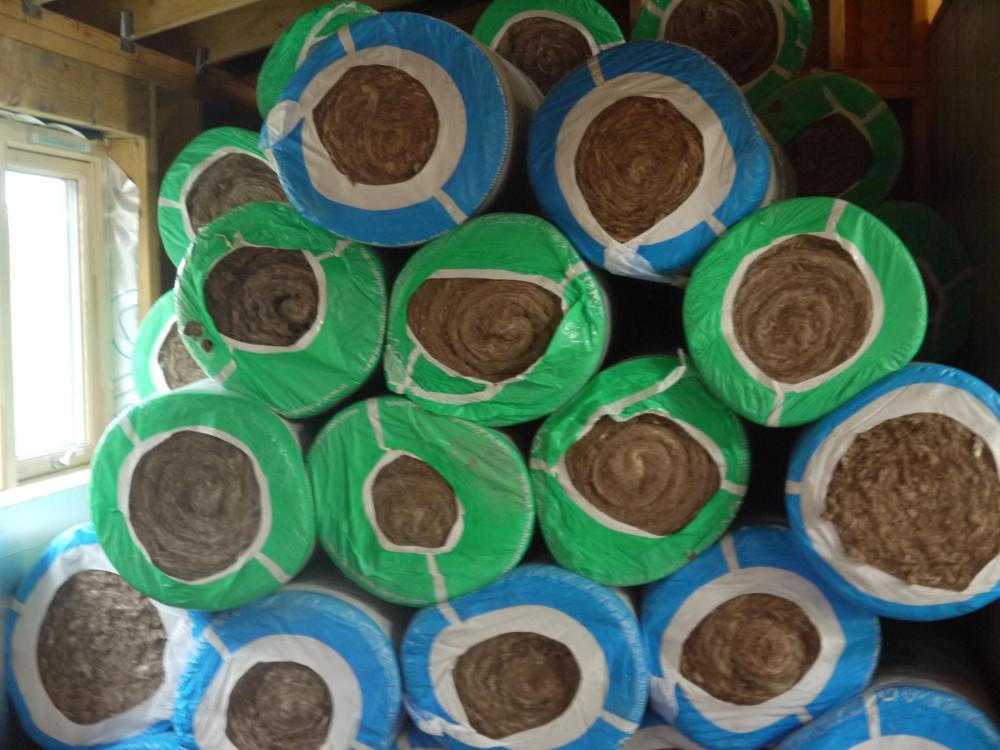

The other insulation ordered at this stage was the Frametherm wool which is the primary insulation layer between the studs. But some will also be used to top up the gap left in the joists.
The width is already in the correct size so it was just a cut for the required length and then you can pop into the studwork. Compared to the Quinntherm this is more quicker to fit.
P1160007.thumb.JPG.954e5907025739d099297430124d92f8.JPGP1160008.thumb.JPG.50a57c46d67a8c913e3f0be1d3dfd88f.JPG

I enjoy reading your blog entries as it reminds me so much of what we embarked upon during the spring and summer last year. The shot of those rolls of insulation certainly brought it all back ? If memory serves me well, it was the blue rolls for walls and the green ones for the loft spaces. Pleased t hear you are where you wanted to be at this stage of the project. It seems you are on top of things so good luck for 2019.?
