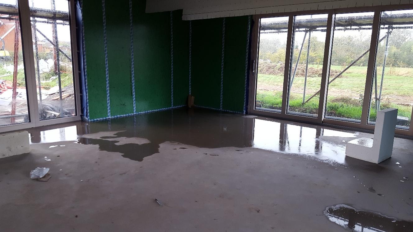

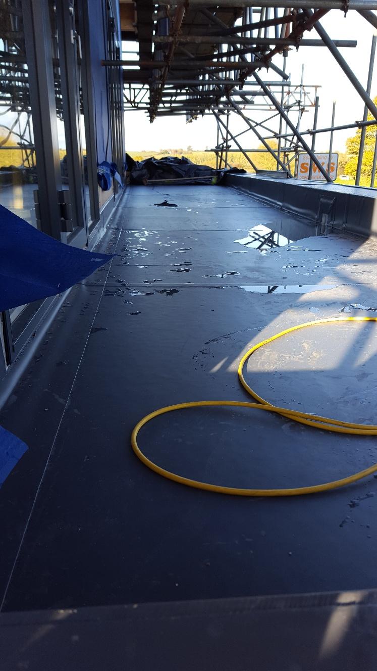

So, 2 weeks later and we seem to be settling down but not before more drama ensued.  In their efforts to shore things up during their day on site, the flat roof guys tanked my east facing balcony.  There were and are a couple of lovely big drainage holes through the parapet wall via which water can freely exit, but for some reason they thought it would be a good idea to put the membrane over these.  WTF!!!! Again!!!!  Thankfully, because MBC were on site, I went over to site on Saturday.  We'd had some major weather and storms the previous day and very heavy rain.  As a result, I had a paddling pool outside my bedroom window that was lapping in under the French doors.  For once, words fail me, they really do.  Armed with bare feet, rolled up trousers and a stanley knife, I negotiated the scaffolding beams and re-opened the exits and rammed a couple of drinks bottles with the ends cut off into the holes to keep them open and drain the water.  Ever seen Niagra Falls?  It was a fine impression.

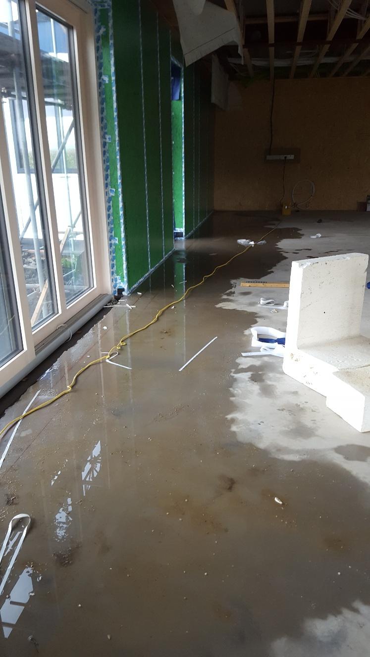

Here are a couple of photos of the water that came into the lounge area from the parapets.
Depressing.
I vacuumed up all the water from inside the house and put a couple of oil filled radiators in the place to get some sort of drying process started off and it did a bit of good.  Come Monday, words were had with the guys now back on site as it could have been disastrous if I hadn't been there at the weekend and the upstairs would have quickly flooded, and the downstairs more so than it had already.  They're now working on the last of the flat roofing and the gullies behind the parapets and the house is drying out.  MBC have been in and done what they can, which is most of it, but we need to let one side of the parapet dry out some more before they put the celotex up there - we should be good for Tuesday next week which is when Darren will be back and the airtest will be done that day, too.

This is the east balcony, with two bedrooms leading onto it.  The rumpled up stuff at the end is the polythene covering the garage roof.

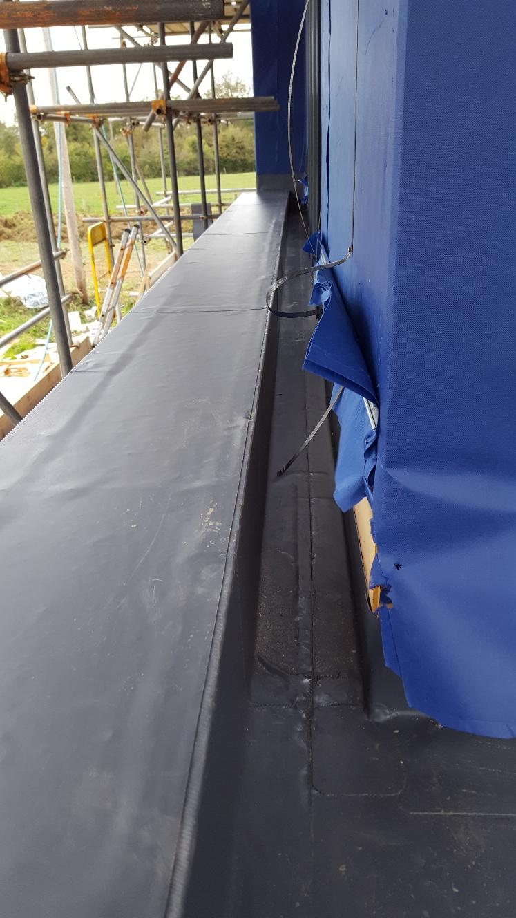

And here's the work in progress of the parapet gullies being lined with membrane.  The guys got on okay with this one but I gave some feedback to the architect about the same construction on the north face of the house.  This was because when the guys came to line it, they were significantly slowed up because the width of the gully was too narrow to get a fixing tool into to attach the OSB upstands to.  Looking pretty is all well and good, but only if you can actually build it.  They managed, but probably lost about half a day because of this.1971339901_Gullylining.thumb.jpg.df6b9d3f5b05f6daaf8b04a554fdfefb.jpg

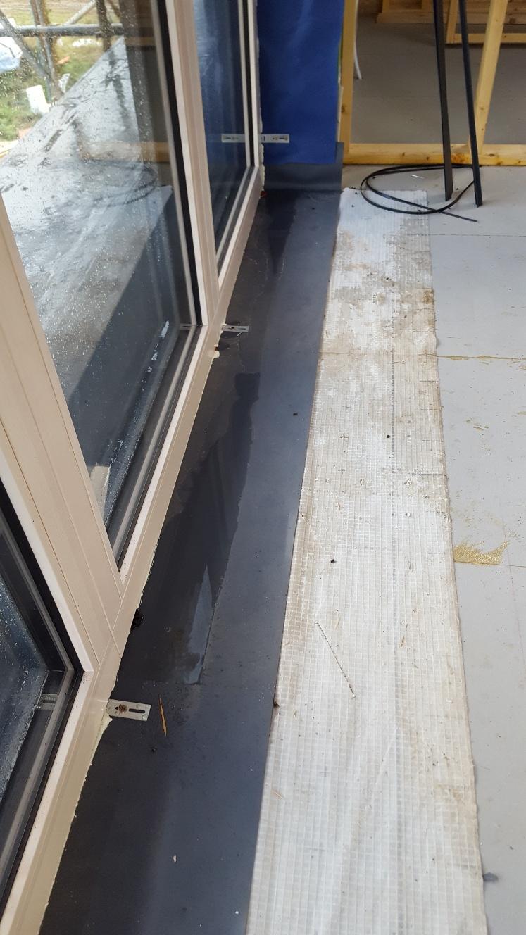

Moving on from the flat roof but still on the subject of water, I'm still getting water ingress from under my windows as well and, if anything, more than I previously thought as it's affecting 3 windows not just the original one.  For all that it's distressing seeing water coming in through the building because of my roofing difficulties, in many ways it's not all bad because it has highlighted the poor seals under the windows that I wouldn't have otherwise spotted and had the opportunity to get put right before the building is complete and kitted out.  That would have been a horror story.  I do realise that the building isn't going to be fully watertight until the cladding goes on, but the issue is that the water ingress of the windows is from underneath, not around the sides or top and so there is something defective about the way they have been sealed on their bases and this needs to be addressed.  I have a team due on Thursday so I shall be interested to see how they deal with this as it needs to be fixed before next Tuesday at the latest.

This is the south bedroom window, but the picture on all the other multiple pane windows upstairs is similar.
