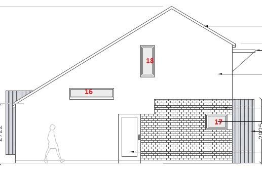

I'm currently awaiting the Architects tender documents for review. It's been a two month process and I've been making inquiries into specific heating, MVHR and window options. Budget as always is a worry. I've drawn up a list of timber frame companies and builders and met those on the short list face to face. The Architect will have other names to drop I'm sure but getting a feel of the building pulse and talking with the builders really helped me identify the risks as they see it. Masonry vs Cement Board was a concern, Architect said masonry is 1/2 the cost, builders has it's about the same. Shows what they know!

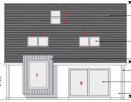

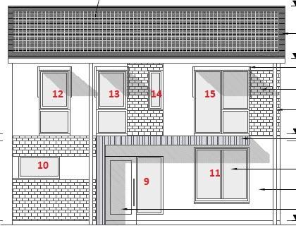

Previously I'd thought Rationel would be an easy win but the G values are fixed and I need higher ones for my house. I'm hoping for top hung, outward opening alu-clad. The Architect gave the following guidance for the specification they require:
Glass Technical Information
•         Ug according to ISO EN 673
•         G Value according to ISO EN 410
•         Psi Glass Edge according to ISO EN 10077-2
Window Frame Technical Information
•         Uf  according to ISO EN 10077-2
•         Psi Install according to ISO EN 10211
•         Widths of Frames for Top, Bottom and Sides
Then this follow up:
“The ideal window would be the one with a low Uf value around 0.8 w/m2k, with a low spacer thermal bridge around 0.02 to 0.03 w/mk, thin frames. The glass is also very important component and ideally the g value is as high as 65% to 67% and the Ug value as low as 0.5 w/m2k.”

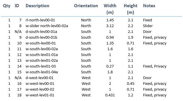

I'm getting good at taking a quote and pulling out the Uw and other values into a spreadsheet for analysis. Most only give the Uw however, not Uf, g, PSI glass edge etc that's needed. I've two good window quotes in but while Rationel were €14K, these two are €28K and a third €40K! I've prices @ €20K from a few but either their performance doesn't match or they can't provide sufficient information. Velfac come in at €14K but just as I was about to breathe a sigh of relief, I visited their showroom and let's just say I won't be buying if I can help it....
