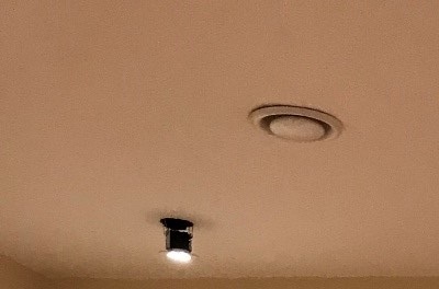

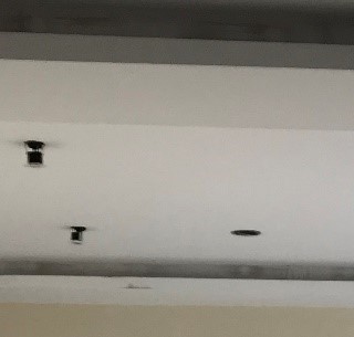

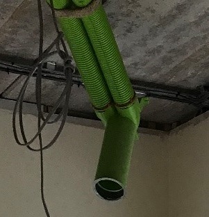

5a969cd98c08a_Pic2.jpg.40941071bfbef41b70862ac2f1146c4a.jpg                      5a969c672b9a9_PIc3.jpg.e1e3a2a170a5f2d0daea092073785d9b.jpg                                  5a969cd9f3e97_Pic4.jpg.705756c53f0cec9b5f6c395014d04c4e.jpg    Installed extract valve.                                                                                                                Valve removed leaving housing                                                                              Housing on adaptor.
The first picture shows an installed extract terminal in the Airing Cupboard.
The second one the metal connector plate (in the Dining Room) with the valve removed.
The third one an adaptor plate attached to the duct terminal in a room that will have a suspended ceiling (tiles) so to be finished after all messy work, the duct terminal will be adjusted as required.

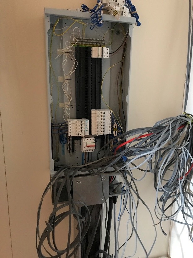

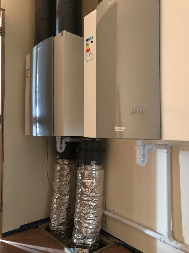

Next, I fired up the FF unit and set the speed to 275m3/h, this was a challenge as the electrician had to make certain circuits live.
5a969cdaab79f_Pic5.thumb.jpg.0774c2d6febd9009bdcbe21fa965daee.jpg                       5a969cdb4e5e0_Pic6.thumb.jpg.ffb3ae6b44f954f1f8b1a5ae14790581.jpg
In the CU the top Right is the lift (3-Phase) required for install T&C, the bottom 5 (left) are the MVHR and others on the circuit, 2 x downstairs power circuits and 2 others I don’t know and didn’t dig into.  A lot of work still to be done there, but I had my power.
The two MVHR units connected up (though the drains weren’t connected until Friday).
