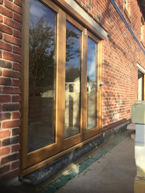

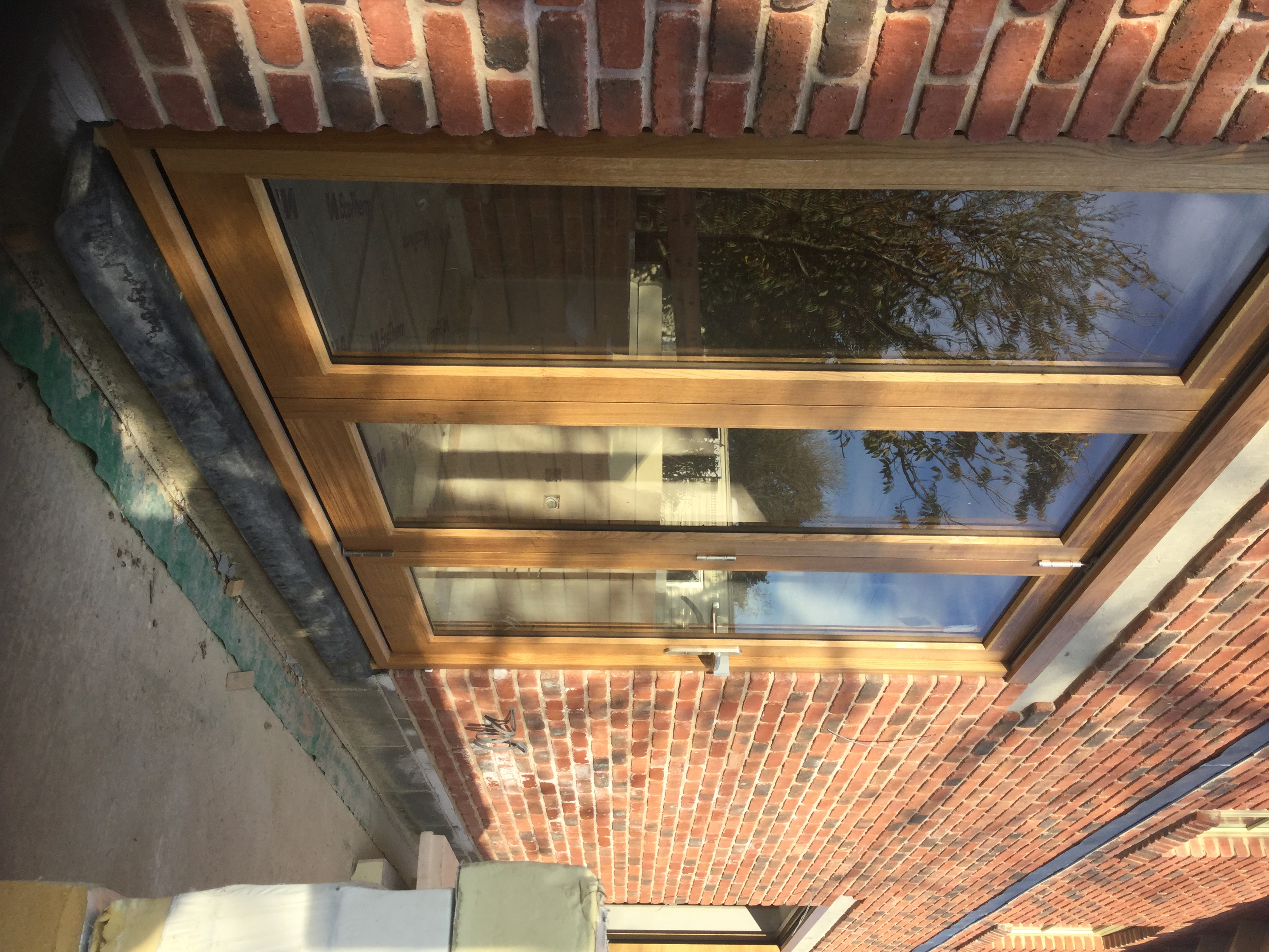

Hi, I have just installed two bi fold doors from kitchen and lounge but they open into a large conservatory ( un heated) across the back of our new build, well they will next year when I get time to build the conservatory ?. I had mine made from oak and specified double compression seals not brushes as they quickly start leaking from my reading. The conservatory will also have two sets of double doors opening to the garden so should give us lots of flexibility on the use of the space. Ours is a cottage type of construction but everyone thinks ours is in keeping with the whole build.
