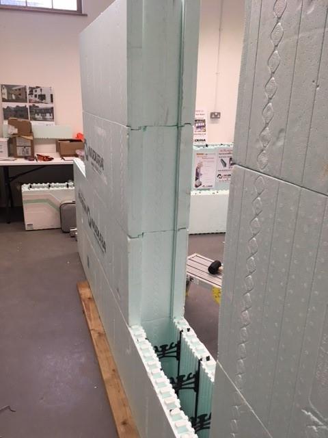

Russell griffiths Posted June 4, 2019 Posted June 4, 2019 The only membrane I will be using is on my ceiling internally, it will cover the entire ceiling and be taped to the walls at wall plate level. Obviously all windows will be taped to the window jambs. I have used nudura i know it can be a very different situation with other manufacturers. No external membrane needed either. 1
bissoejosh Posted June 4, 2019 Author Posted June 4, 2019 7 minutes ago, Russell griffiths said: The only membrane I will be using is on my ceiling internally, it will cover the entire ceiling and be taped to the walls at wall plate level. Obviously all windows will be taped to the window jambs. I have used nudura i know it can be a very different situation with other manufacturers. No external membrane needed either. What forms the window opening within the ICF - timber? Presumably the concrete core is airtight enough by itself to not need any wall membranes then? It sounds ideal but as you mention I guess it depends on the chosen system.

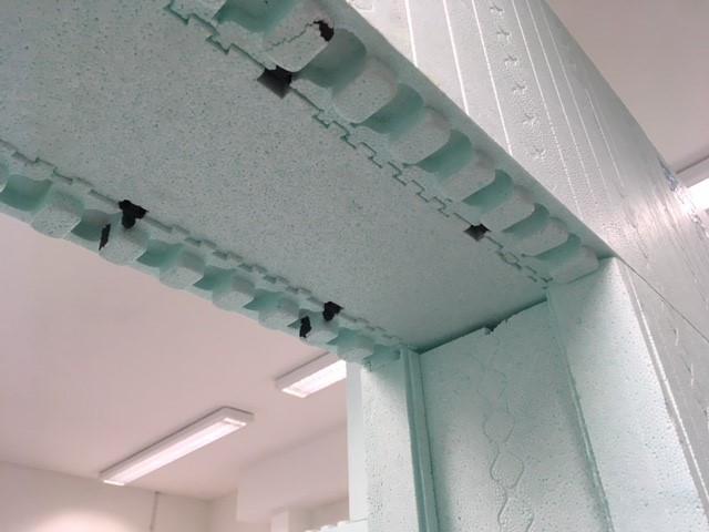

Russell griffiths Posted June 4, 2019 Posted June 4, 2019 48 minutes ago, bissoejosh said: What forms the window opening within the ICF - timber? Presumably the concrete core is airtight enough by itself to not need any wall membranes then? It sounds ideal but as you mention I guess it depends on the chosen system. This all depends on the make of icf, mine is all eps, including all cavity closers i know some other makes are as porous as a weetabix. You pay your money and take your choice. 1
Russell griffiths Posted June 5, 2019 Posted June 5, 2019 cavity closer system for nudura. Tape the inside and outside and I cannot see a lot getting through there. 2
bissoejosh Posted June 5, 2019 Author Posted June 5, 2019 5 hours ago, Russell griffiths said: cavity closer system for nudura. Tape the inside and outside and I cannot see a lot getting through there. Very neat - Nudura is definitely on the list for potential suppliers.
