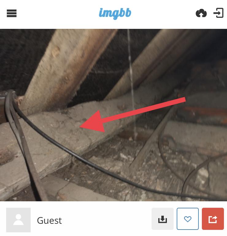

PeterW Posted June 3, 2019 Posted June 3, 2019 Is that a purlin on the left side resting on the brickwork ..?? Got a better image of the left (and right) just above the ceiling level..? 1

PeterW Posted June 3, 2019 Posted June 3, 2019 29 minutes ago, Teddysheart said: I think that is just a random piece of timber! The one with the red arrow ..?? Looks like a purlin 1

Teddysheart Posted June 3, 2019 Author Posted June 3, 2019 I'm not sure I have anything to add here except to say I wouldn't need to move that purlin with the red arrow and that I doubt the 2x2.5 inch batons would hold hold a medium sized dog so not sure how much they can be doing! ?
ProDave Posted June 3, 2019 Posted June 3, 2019 2 minutes ago, Teddysheart said: I'm not sure I have anything to add here except to say I wouldn't need to move that purlin with the red arrow and that I doubt the 2x2.5 inch batons would hold hold a medium sized dog so not sure how much they can be doing! ? If they are stopping the roof from spreading, they would be in tension, so could be doing quite a lot. How much are you hoping to raise the ceiling, or do you not want a ceiling just open right to the ridge? 1
Teddysheart Posted June 3, 2019 Author Posted June 3, 2019 I'd be happy just to raise the ceiling 6 inches tbh. Especially if it means less faffing and expense!
Jeremy Harris Posted June 3, 2019 Posted June 3, 2019 6 minutes ago, Teddysheart said: I'm not sure I have anything to add here except to say I wouldn't need to move that purlin with the red arrow and that I doubt the 2x2.5 inch batons would hold hold a medium sized dog so not sure how much they can be doing! ? The ceiling joists only need to be small, as most of the load in them will be tensile, holding the rafters together to prevent spreading, I think, as @ProDave has said above . It looks like there are purlins in place, one being the one that @PeterW has marked with a red arrow, and they will be helping to tie things together too. As for possibilities for raising the ceiling, based on the info in those photos I'd say that it may well be reasonably easy to do, but that I would guess that the new ceiling joists would need to be fitted before the old ones were removed, and an SE would need to advise as to what's needed. 1
PeterW Posted June 3, 2019 Posted June 3, 2019 (edited) There should be a purlin both sides. That takes the roof weight so nothing else needed (no ridge beam @ProDave) Those others are ceiling joists and I’d be inclined before you remove the old ones to use that as a platform to install some new ones higher up, then remove the old ceiling. Downside will be the whole lot will need to be brought up to building regs and you’ll possibly have to use PUR as the rafters aren’t that deep Edited June 3, 2019 by PeterW Crossed with @jsharris 1
