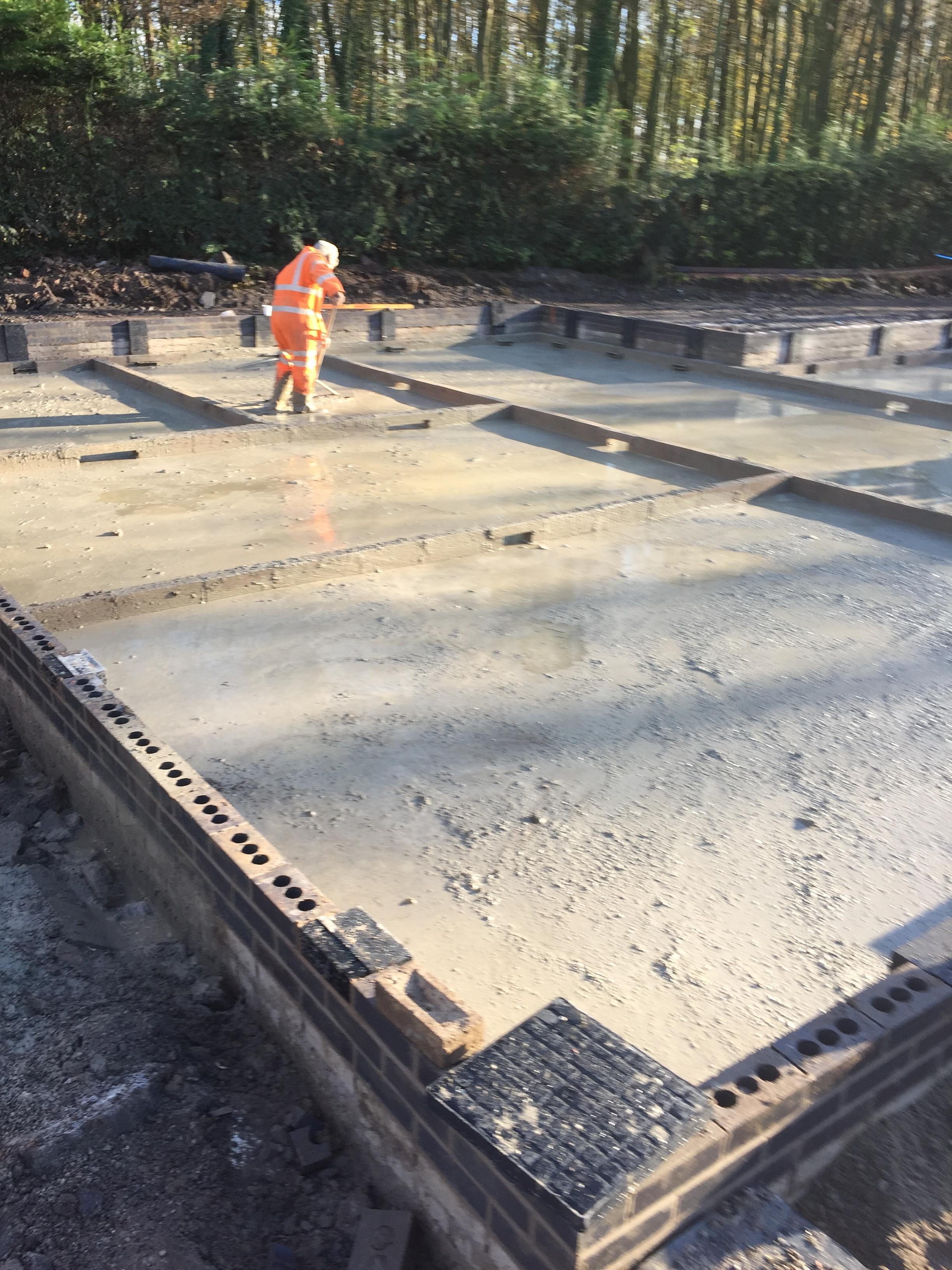

Normally you would have a hardcore raked out
Our engineer insisted we put six mtrs of concrete sloping to a drain with an anti flood valve
I was pretty pissed off at the time
having to do this
But I suppose it covers All basis
Pictured is ME You can’t see my face but I think I was sulking
well with a concrete blinding you won,t get mushrooms  or other fungi growing  in the bare soil
so seems a sensible idea to me .

His reasoning was If there is ever a flood the contents of your tank would finish up under your house
Plus he did say that anything growing under there can get a bit pongy
It is normally acceptable to have bare earth as long as it is weed free.
having to do this
Hi Nod. I'm in a similar situation and our BCO has requested a concrete oversite below B&B with a slight fall to drain. Plan is to lay a DPM then slurry above. I was just wondering, what mix did you use, and how deep? Just trying to decide if I mix on site or order premix - 80m2 to do soon on the garage (house will come later!). I already have the fall created by the soil so was hoping for a 20-30mm cap will suffice.
Thanks
Sean
Hi Sean
I didn’t use a membrane I laid a drain and sloped 5 cube of c3 premix in heavy rain I took me about 5 hours on my own to cover 153m2
