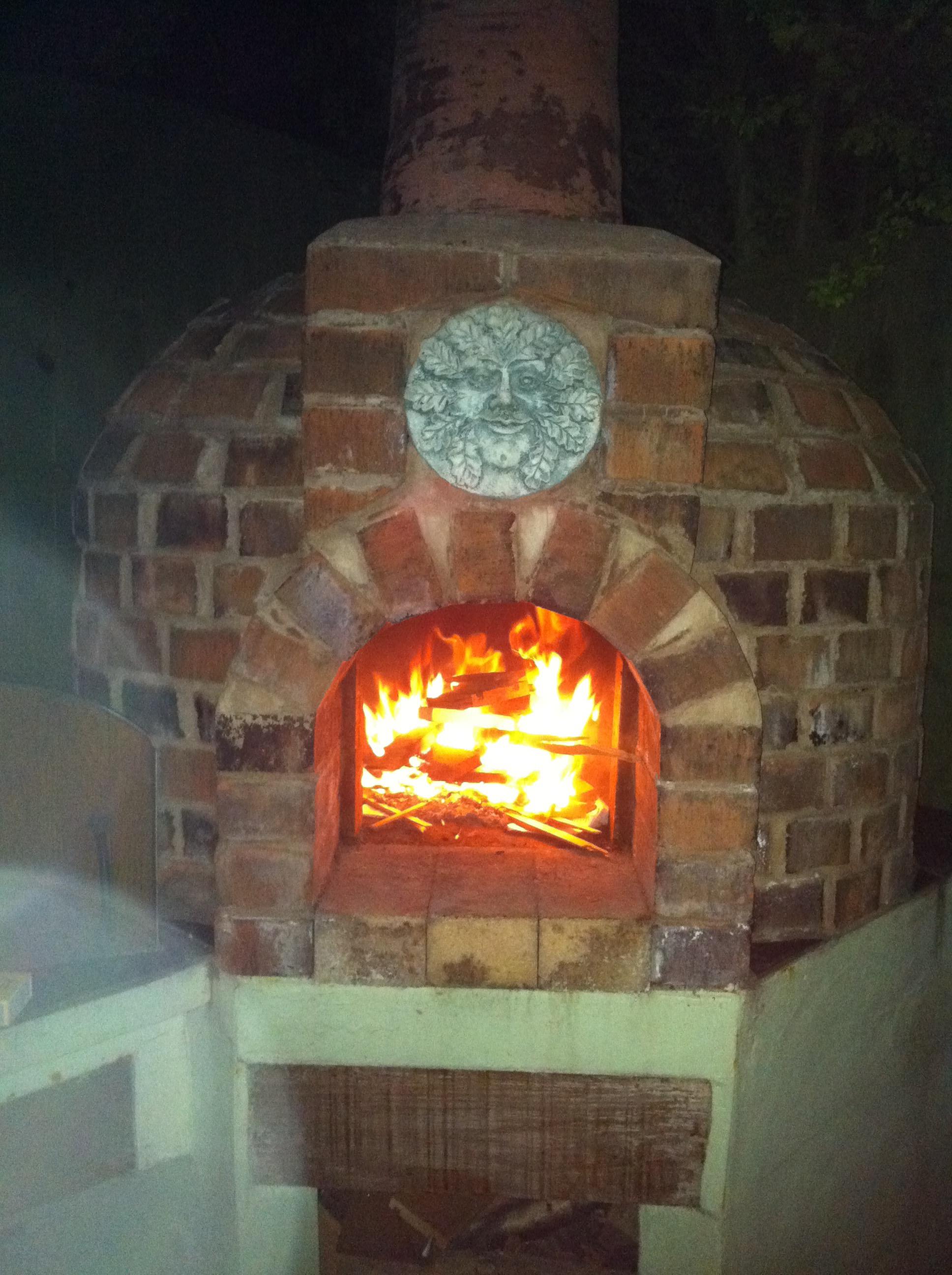

PeterW Posted September 5, 2016 Share Posted September 5, 2016 Got one, built from the Forno Bravo plans and I love it ..! Too dark for photos now but it was a few weekends work and worth every penny - ideal way to use up left over materials too ..! Link to comment Share on other sites More sharing options...

PeterW Posted September 6, 2016 Share Posted September 6, 2016 Mine has a chimney that is about 18" above the dome and once lit there is little smoke. I built it into the corner of the garden on a block work plinth and extended one side to put a BBQ on it as well - it's a kettle one that sits on the top. Underneath there are cupboarda and a wood store so plenty of storage too Link to comment Share on other sites More sharing options...
Tennentslager Posted September 6, 2016 Share Posted September 6, 2016 Let's see a pic then Peter... 1 Link to comment Share on other sites More sharing options...

PeterW Posted September 6, 2016 Share Posted September 6, 2016 12 minutes ago, Tennentslager said: Let's see a pic then Peter... Just looking for one now ! Link to comment Share on other sites More sharing options...
Onoff Posted September 6, 2016 Share Posted September 6, 2016 Some brilliant ones over on the mig welding forum made from old gas cylinders. I saw Jamie Oliver building / using this one. Would make a good cheap basis for a heat source: http://www.jamieoliver.com/jimmytandoori/to.pdf & http://www.channel4.com/programmes/jamie-and-jimmys-friday-night-feast/videos/all/s2-ep1-diy-pizza-oven/3977372594001 Link to comment Share on other sites More sharing options...
PeterW Posted September 6, 2016 Share Posted September 6, 2016 Not a great photo but only have what's on my phone bbq is to the left 1 Link to comment Share on other sites More sharing options...

daiking Posted September 6, 2016 Author Share Posted September 6, 2016 42 minutes ago, PeterW said: Not a great photo but only have what's on my phone bbq is to the left That's the badger Link to comment Share on other sites More sharing options...

PeterW Posted September 6, 2016 Share Posted September 6, 2016 (edited) That chimney is around 32" in total and is stood on the arch top - it was from a reclaim yard, is Victorian and as it had a crack at the bottom and a chip out of it he charged me £20 rather than £95 for a perfect one .! It does draw well ..... Inner some and baking floor are hard refractory bricks, first course of dome bricks are soldier course then they are shaped and cut into half. Mortar is a blend of fire clay and OPC. Outer bricks are half a pallet of furnace edge rejects that cost me 10p each..! Insulation is a mix - under the base is a layer of thermalite blocks, over the dome is a vermiculite fill plus foil and ceramic fibre wool. I put thermocouples in various places but they have long given up - more of a novelty tbh ..! Plans are here https://www.fornobravo.com/store/pompeii-oven-instruction-ebook-v2-0-pdf/ Edited September 6, 2016 by PeterW Added link Link to comment Share on other sites More sharing options...
