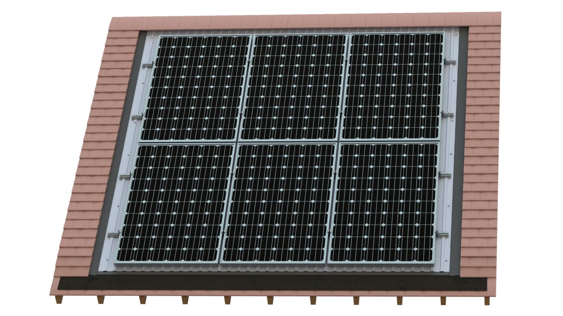

Triassic Posted May 19, 2019 Posted May 19, 2019 (edited) I’m looking to use the Sunfixings in-Roof solar PV mounting kit and wondered if anyone had used it on their roof and had any hints or tips they could share? https://sunfixings.co.uk/mounting-system/in-roof/ https://sunfixings.co.uk/case-study/poppintree/ Edited May 19, 2019 by Triassic
Jeremy Harris Posted May 19, 2019 Posted May 19, 2019 Where do the cables go? On the other in-roof systems there are large ventilation holes under the panels that also act as places for the cables to run, and also give space for microinverters/optimisers to be fitted if needed.
PeterW Posted May 19, 2019 Posted May 19, 2019 1 hour ago, Triassic said: I’m looking to use the Sunfixings in-Roof solar PV mounting kit and wondered if anyone had used it on their roof and had any hints or tips they could share? Never seen their in roof system but have seen their parking bay system and this looks like a modification of that - the sheet (or similar) was used below panels to keep the connections from damage. Not sure about the edge flashing design or whether it’s just poor instructions. And I would also want a section drawing as from what I can see, those panels will be sat ~80mm up from the battens..?? That’s more than the GSE/Easyroof systems by a long way.
scottishjohn Posted May 19, 2019 Posted May 19, 2019 a bit ugly if that finished picture of installation
Vijay Posted May 19, 2019 Posted May 19, 2019 1 hour ago, scottishjohn said: a bit ugly if that finished picture of installation kinda looks unfinished
Triassic Posted May 19, 2019 Author Posted May 19, 2019 (edited) Thankfully that’s a cut away image, it’s not the finished look, the slates are much closer to the edge of the panels in the finished article. Don't tell anyone but I’m doing a DIY install as my budget has taken a big hit because of 6 weeks of extra groundwork excavations and the Architect understating the floor area by a good few tens of m2 (when asked at the design stage he stated it to be 300m2, when measure on site it was closer to 370m2, he’d missed off the hall, 3 flight of stairs, landings and corridors. No wonder everyone says it looks big!). I’m not actually using any Sunfix gear, I’ve bought everything online separately, so as to keep costs down. I started by Purchased trapezoid tin sheets. As in the photo these are mounted directly onto the OSB, which itself is fixed over the rafters. I’ll then use low profile aluminium mounting rail, screwed to the crown of the trapezoid sheets, onto which sit the solar panels. This configuration leaves the top surface of the solar panels about 12mm above the slates. At the edges the slates will finish about 15mm from the panels. I’m hoping the finished mounting system for 14 panels will have cost no more than £500. Edited May 19, 2019 by Triassic
