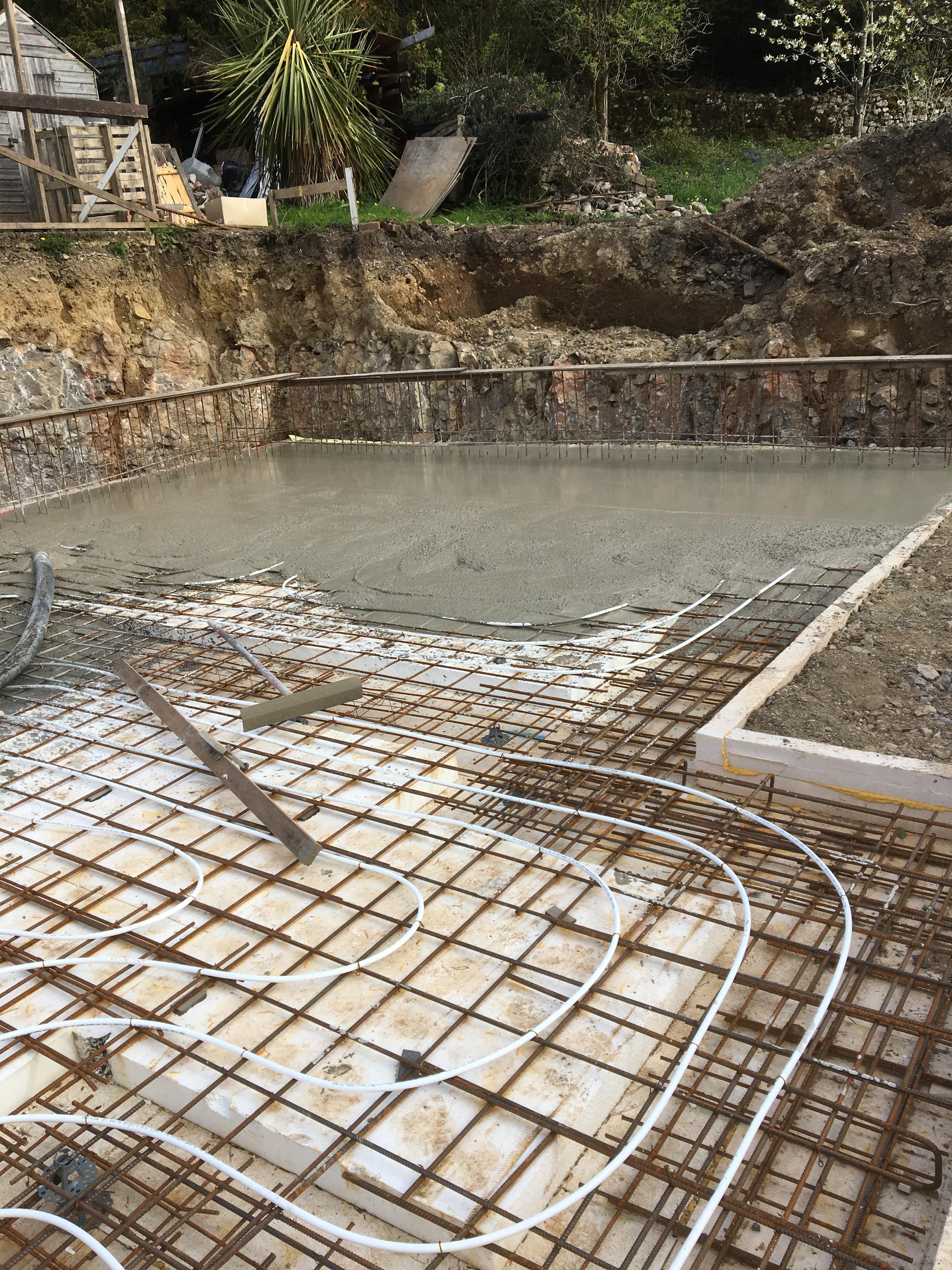

Triassic Posted May 19, 2019 Share Posted May 19, 2019 (edited) I constructed my own insulated slab, not too difficult at all. Mind you, the slab was designed by a well respected Structural Engineer with years if experience of designing insulated slabs. I made all the L shaped up stands out of flat sheets cut to size and glued using low expansion foam. The load bearing areas are EPS 300 and the ready ESP100, all bought in bulk via a local supplier, two wagon loads ! The steel bits (with the board fixed to the top of the ends) sticking up out of the wet concrete are for the basement walls, these were constructed out of ICF. 26 tonnes of concrete in the floor and the same in the ICF walls, all poured by myself and a local pump guy, power float finish to the floor. Edited May 19, 2019 by Triassic Link to comment Share on other sites More sharing options...
Bitpipe Posted May 19, 2019 Share Posted May 19, 2019 We also built our own for the basement, just a simple flat 120m2 slab of EPS 250 blocks (SE specced) with 150mm compacted crush and 50mm sand blinding below and membrane above upon which the 300mm basement slab and walls were cast using standard shuttering a Sika waterproofing rebar and admix. When walls were struck, I glued on 200mm thick sheets of EPS70 and left a profile at the top that dovetailed with the MBC frame (was about 80mm proud of the concrete wall itself. The basement lightwells from MEA came with their own 200m XPS insulation which is bonded to the concrete and to which the lightwell screwed into. I also cut formers for up-stands for the sliding doors, ground level windows and standard doors (about 100x100) in the vertical EPS and the concrete crew cast these seperately, drilling into the walls to resin in rebar. Didn't need to cut any of the EPS250 (thank god), lots of cuts to the EPS70 with an electric chainsaw - turned the basement into a big snowglobe. Pinned 3mm corex to the vertical EPS before backfill to minimise damage from stones etc and job was done. The basement contractor let me get on with those bits, they just wanted a flat solid surface to build the basement on Link to comment Share on other sites More sharing options...
