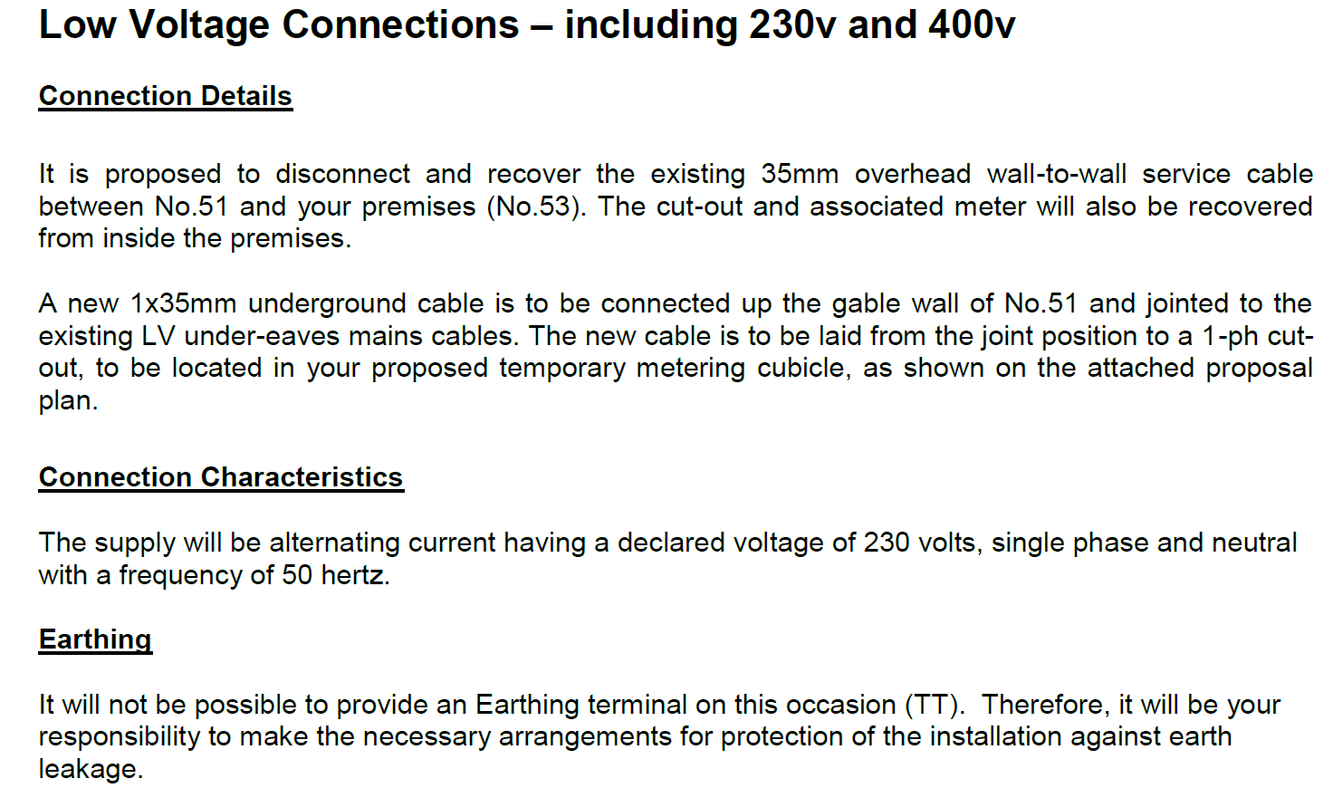

Conor Posted May 14, 2019 Posted May 14, 2019 We're demolishing an existing bungalow and replacing with our new build house (if you saw it, you'd know why!) There's an existing 35mm cable to the bungalow that comes overhead from an under-eaves service on our neighbour's house. I'd originally wanted a new connection coming from an NIE owned pole from across the road... but this is coming in at £3500. So I've a quote of £1500 to remove the existing over head service, and lay a new underground service to a temp kiosk at the site boundary. Happy days. Either way, we need the existing supply disconnected and removed before we can start demolition. Just checking, what kind of capacity/ loading would this kind of connection provide? I'd like to have option of installing a car charging port in the future. I've emailed NIE but no response yet.
Jeremy Harris Posted May 14, 2019 Posted May 14, 2019 Sounds like a standard single phase 100 A fused connection. An EV charge point will draw a maximum of 32 A, so, unless you have some massive loads planned for the house you should be fine. We're all-electric, with ASHP, etc, and the maximum load I've ever recorded was around 12 -13 kW, and that was with everything running on a cold night and my car on charge.
