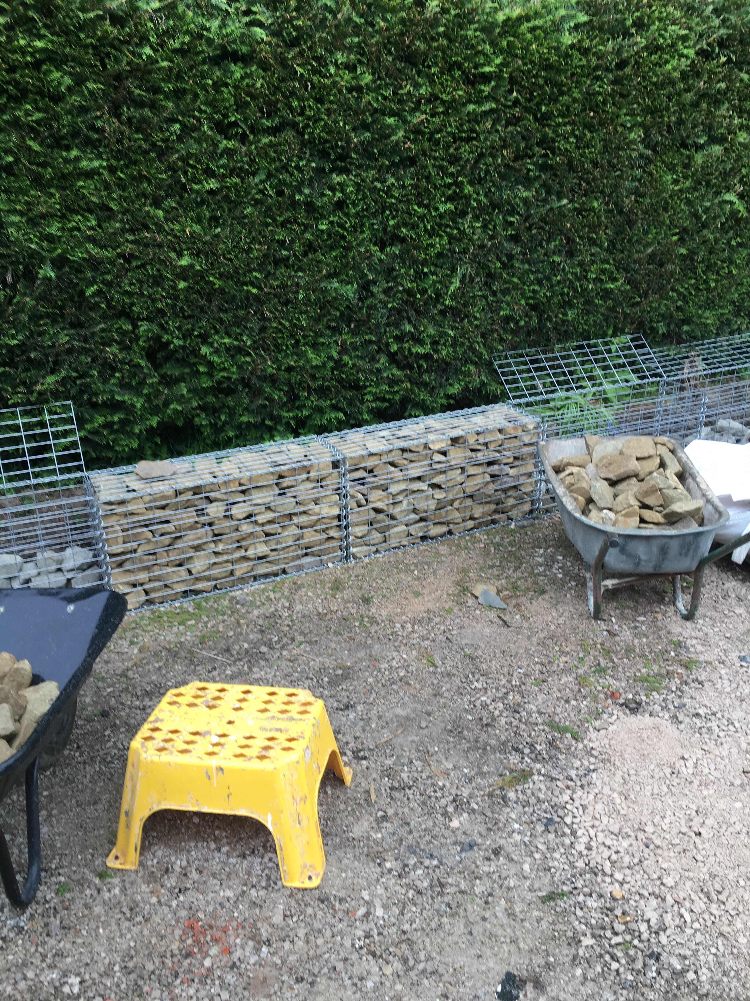

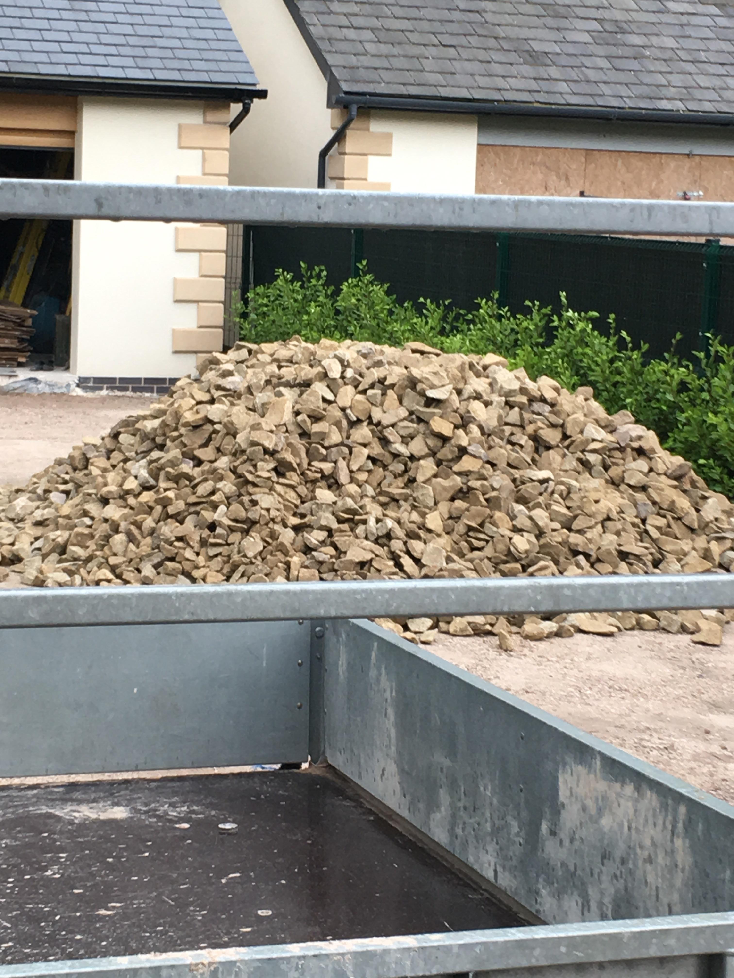

nod Posted May 10, 2019 Share Posted May 10, 2019 My wife s little project She has put twenty Gabion baskets together and taken delivery of some stone How the hell to you gauge how much stone you need 2 Link to comment Share on other sites More sharing options...
Triassic Posted May 10, 2019 Share Posted May 10, 2019 (edited) You use the good, nice looking stone on the outside and the top, the places that can not be seen, you use the cheapest stone you can buy to fill the rest of the void space! You know the cubic capacity of each gabion, and you can usually find the volume per tonne of stone online. Edited May 10, 2019 by Triassic Link to comment Share on other sites More sharing options...
nod Posted May 10, 2019 Author Share Posted May 10, 2019 I’ve got her Ten ton for starters Foind a good quarry that will deliver ten ton for £225 Link to comment Share on other sites More sharing options...
Ed Davies Posted May 10, 2019 Share Posted May 10, 2019 You could just ask them directly how much a cubic metre weighs, when I've had deliveries the drivers knew roughly. Trouble with guessing is they'd probably deliver 20 tonnes for £235 or not much more, delivery is a large part of the cost. Link to comment Share on other sites More sharing options...
jonM Posted May 10, 2019 Share Posted May 10, 2019 empty space was quoted at half the price of the stone when I ordered my stone. Link to comment Share on other sites More sharing options...

ToughButterCup Posted May 11, 2019 Share Posted May 11, 2019 13 hours ago, nod said: [...] How the hell do you gauge how much stone you need ? [...] https://www.robinsonquarry.co.uk/tonnage-calculator.php?product=150-200mm Gabion Stone Link to comment Share on other sites More sharing options...

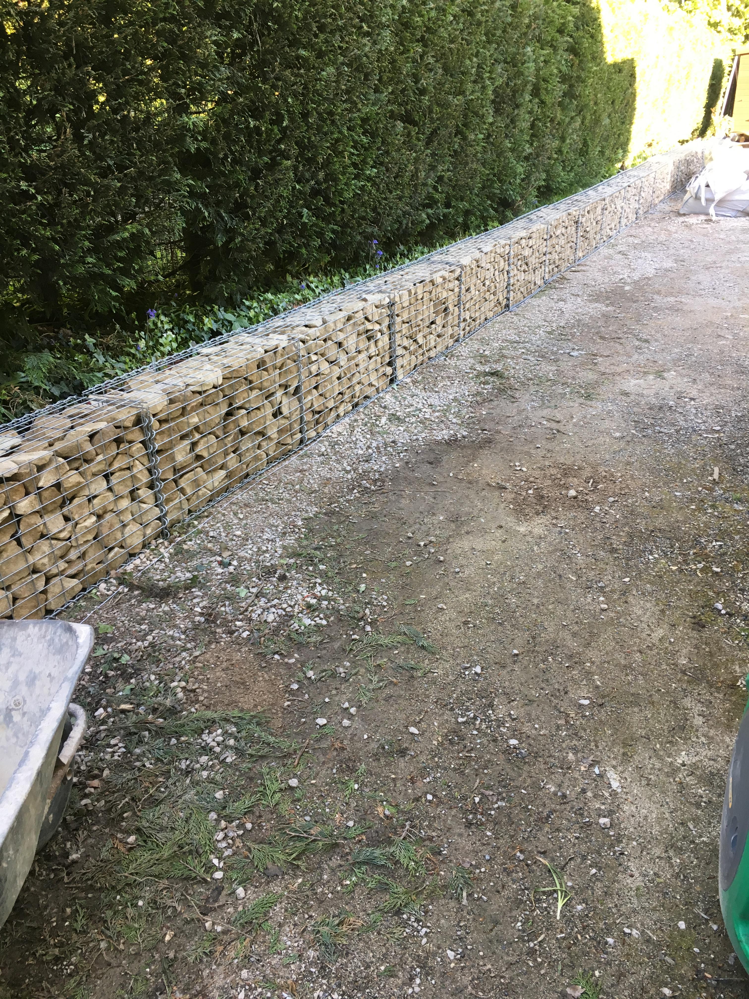

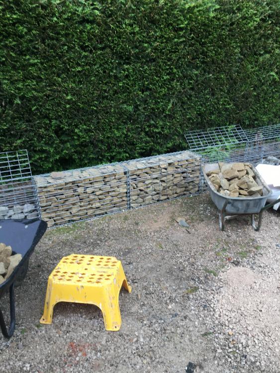

nod Posted May 11, 2019 Author Share Posted May 11, 2019 My wife has made good progress 17 filled 2 Link to comment Share on other sites More sharing options...
