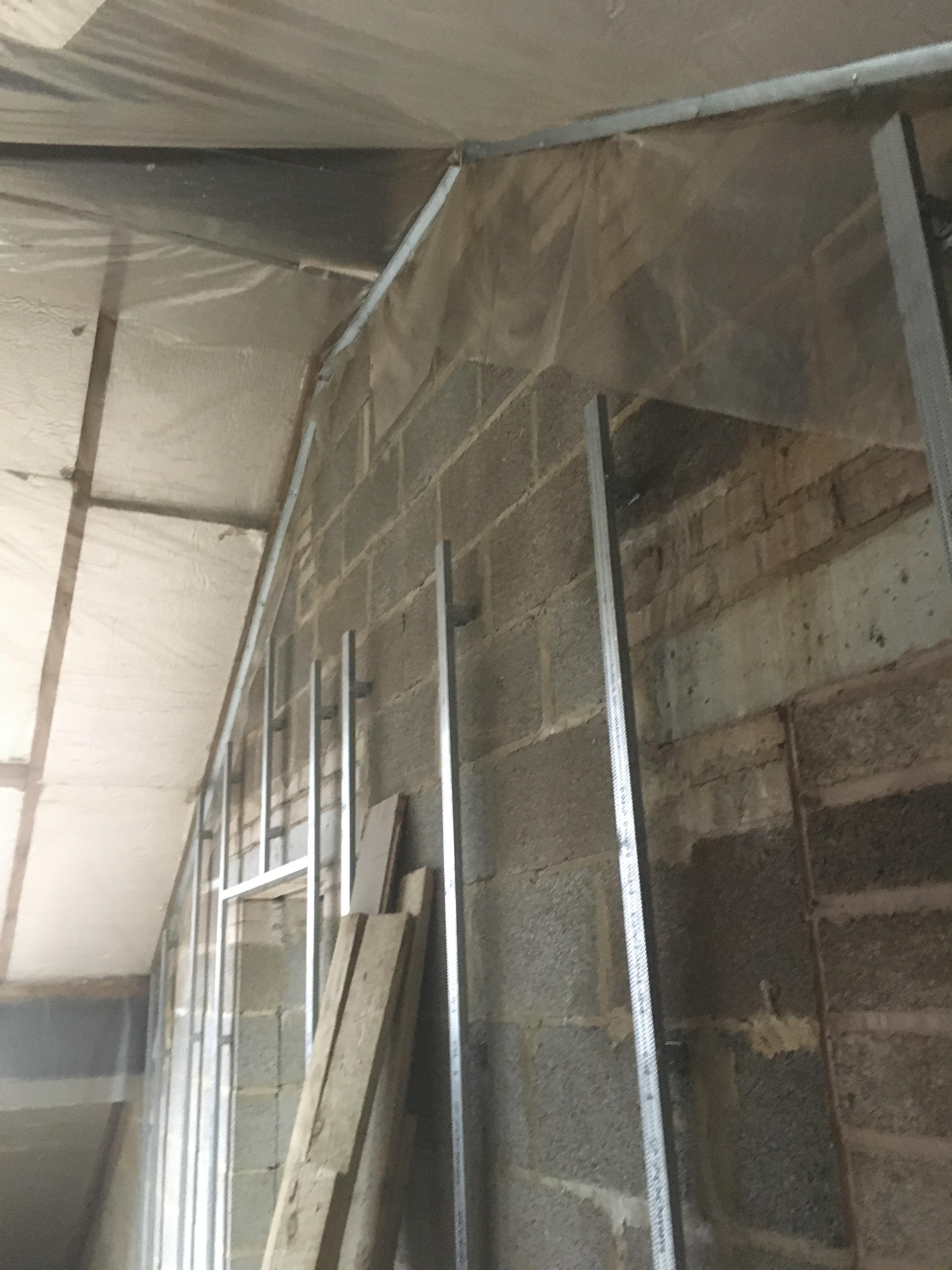

scottishjohn Posted May 8, 2019 Posted May 8, 2019 (edited) OK maybe me being thick to be clear the membrane is fixed directly to the wall all other studs etc which support the OSb wall are on the dry side of the membrane maybe the picture but is there a gap between the studs and membrane or not could touching the steel studs cause condensation to form ? every time i,ve seen these sort of barriers they do not touch anything but have an air gap on the dry side of them,then the stud wall . please correct me if i,m wrong Edited May 8, 2019 by scottishjohn

Pocster Posted May 8, 2019 Author Posted May 8, 2019 15 minutes ago, scottishjohn said: OK maybe me being thick to be clear the membrane is fixed directly to the wall all other studs etc which support the OSb wall are on the dry side of the membrane maybe the picture but is there a gap between the studs and membrane or not could touching the steel studs cause condensation to form ? every time i,ve seen these sort of barriers they do not touch anything but have an air gap on the dry side of them,then the stud wall . please correct me if i,m wrong Yes there’s a gap . The membrane isn’t perfectly flat to the wall so you probably can’t see the gap . gaps about 1.5 -> 2cm Theoretically all moisture should be only behind the dimpled membrane- that’s its purpose .
Pocster Posted May 8, 2019 Author Posted May 8, 2019 Just now, pocster said: Here From this angle you can see the gap I guess you could argue that condensation could occur with the horizontal ceiling track against the concrete ! . There will be a suspended ceiling as well .
scottishjohn Posted May 8, 2019 Posted May 8, 2019 If the damp outside of wall is colder than inside and something is touching, like metal I think it could cause condensation on the metal ,like on inside of a single glazed window, that why you need a gap roomside of the barrier ,so any condensation on the barrier will hopefully be on the outside(damp ) where the drain channel is? 1

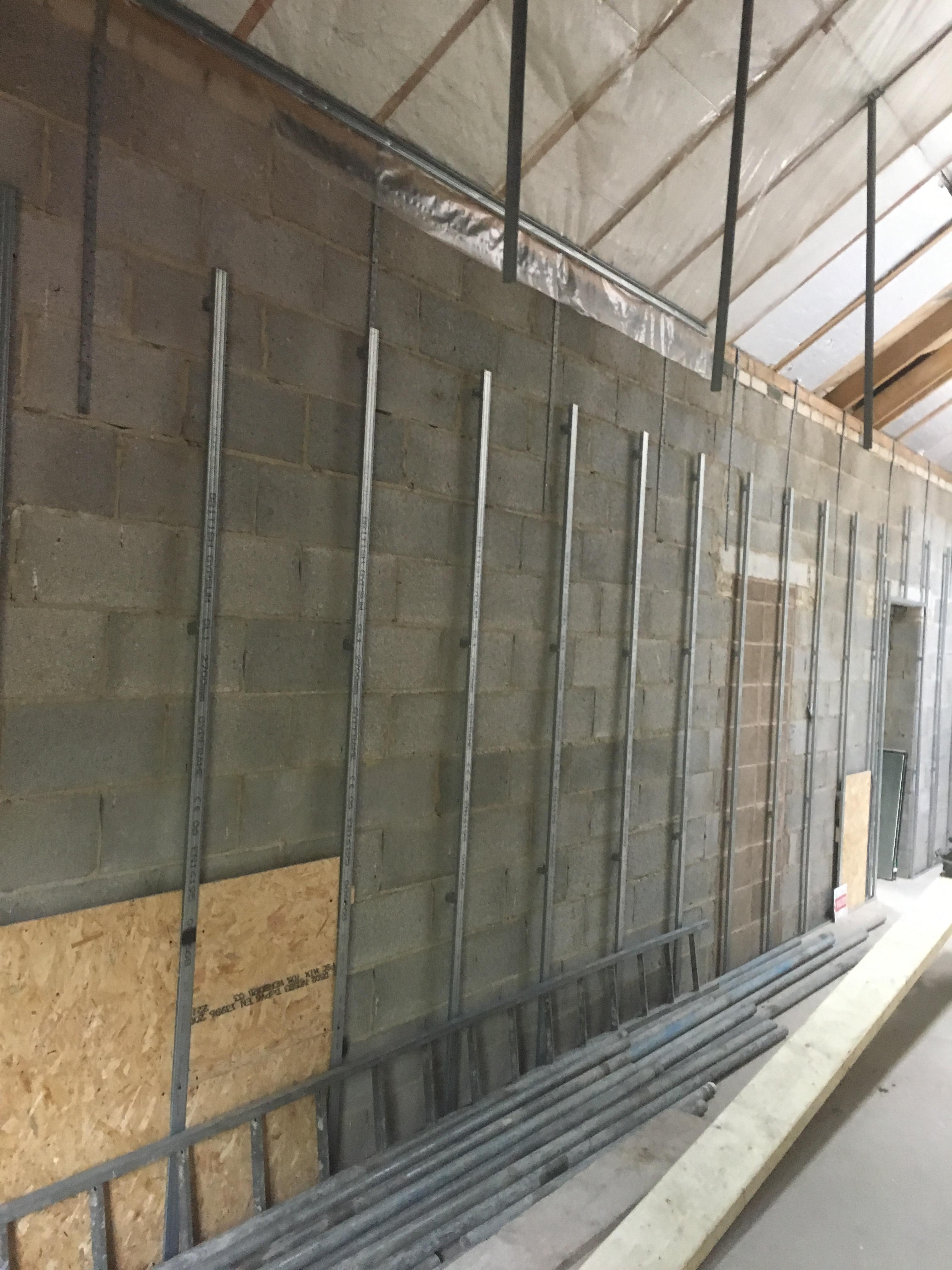

nod Posted May 8, 2019 Posted May 8, 2019 You can set your struts at 400 and the wall will be very rigid As John has pointed out if you choose to use a insulation board you will have a very solid wall Another option is a Sound moisture board Both options will be rock solid We normally site the brackets at 800 apart Closing this off to 600 again will make things more solid With this system you don’t have to use track On refurbs it’s not always possible to get a good fixing Quivk tip for fixing the brackets is to use point tip pan heads not self drillers as they work loose Most vids show the clips being bent back then fixed Ans easier way is set your laser and trim the brackets with your snid where the laser strikes That way when you are fixing you simply clamp to the edge of the strut 1
nod Posted May 9, 2019 Posted May 9, 2019 12 hours ago, nod said: You can set your struts at 400 and the wall will be very rigid As John has pointed out if you choose to use a insulation board you will have a very solid wall Another option is a Sound moisture board Both options will be rock solid We normally site the brackets at 800 apart Closing this off to 600 again will make things more solid With this system you don’t have to use track On refurbs it’s not always possible to get a good fixing Quivk tip for fixing the brackets is to use point tip pan heads not self drillers as they work loose Most vids show the clips being bent back then fixed Ans easier way is set your laser and trim the brackets with your snid where the laser strikes That way when you are fixing you simply clamp to the edge of the strut These are what I’ve been doing this morning A real simple system when space is tight 3

Pocster Posted May 9, 2019 Author Posted May 9, 2019 4 minutes ago, nod said: These are what I’ve been doing this morning A real simple system when space is tight Real neat ! i think you’ve done this before a few times ?

nod Posted May 9, 2019 Posted May 9, 2019 Thanks This site has been stood foe 10 years All the pb and wiring has been rip out to reveal no fire protectection Poor airtightness So we are having to seal everything 1
