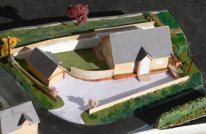

We had a privacy issue raised by one neighbour.  It turned out that a large part of the problem was that they couldn't visualise the true sight lines from the plans, and were assuming that there would be a direct line of sight from their bedroom windows to ours.  For other reasons (all associated with the inability of people to interpret plans) I chose to make a scale model, which worked really well in damping down possible objections.  Being able to see on the model that our detached garage effectively screened the view caused the privacy objection to be withdrawn.
This is the model I made:
