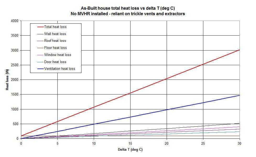

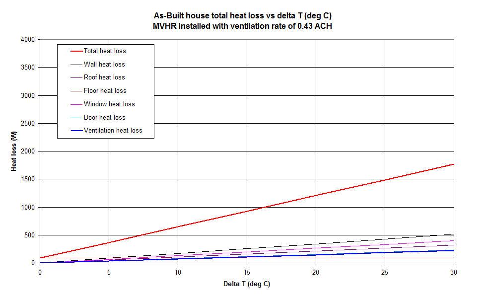

Jeremy Harris Posted April 18, 2019 Posted April 18, 2019 There's no way that you can just make an assumption that a house of a given date and size will have any particular energy usage; the whole concept of trying to use just those two parameters alone is deeply flawed, for several reasons. Heat loss doesn't vary linearly with house size, as there there is a surface area to volume ratio effect that creates non-linearity (the elephant versus mouse effect). One of the most significant causes of heat loss in houses is airtightness, or lack of. A house with open fireplaces and sash windows will lose a lot more heat than the same size house with no fireplaces and casement windows, for example. Shape and number of storeys has a significant impact on heat loss. Long, thin houses lose more heat than square houses. Single storey houses lose more heat than multiple storey houses. Detached houses tend to lose more heat than semi-detached or terraced houses. Window size dominates fabric heat loss, so a house with large areas of glazing may lose many times more heat than the same size of house with smaller areas of glazing. There are many other variables, too, but the above alone will cause very large errors if only trying to use age and floor area to predict heat loss. 1

Jeremy Harris Posted April 18, 2019 Posted April 18, 2019 10 minutes ago, epsilonGreedy said: @jsharris Those are all factors but at the end of the day it is odd that a 1970's house with some unspecified improvements requires 30% less heating than a 2013 standard house that is 30% smaller and also an efficient rectangular box. A 2013 house is 2.7 times more thermally efficient than an unimproved 1975 house The explanation is most likely an arithmetic error by the OP or some human factor such as the OP being happy living in a house at 16 degrees or the upgrades to the house were more like a complete renovation and insulation upgrade. I think that your source is flawed, I'm afraid. The very broad assumptions you've quoted from it leads me to doubt it's accuracy, so any broad statement, like "A 2013 house is 2.7 times more thermally efficient than an unimproved 1975 house" is probably way off the mark, and at best a very broad average across a large number of widely different houses. I gradually improved our last house (a block and brick bungalow built in 1982) and by tripling the thickness of loft insulation, having CWI installed, installing reasonable uPVC double glazing and spending some time going around sealing up air leaks, managed to just about halve the heating requirement. The biggest single improvement was from improving the airtightness, which comes as no surprise, given the high heat losses associated with air movement and ventilation. As an illustration of the proportion of heat loss from ventilation, the plots below are for our current house, with and without MVHR (MVHR recovers around 80 to 85% of the heat that would otherwise be lost from ventilation):

Jeremy Harris Posted April 18, 2019 Posted April 18, 2019 18 minutes ago, epsilonGreedy said: @jsharris your post and graphs offer nothing to disprove the assertion that a 2013 standard house is 2.7 times more thermally efficient than a 1975 house. My "flawed" source is the House Builder's Bible with a table of detailed thermal calcs that show a more detailed assessment than your spreadsheet offers. The relative difference of typical U-values between 1975 and 2013 for roof, walls and floors were x4.4, x6.8 and x3.8. Given the massive relative improvements in standard insulation practices I am not sure what prompts you to deride my 2.7 times improvement that I lifted from the book? Assuming that a very broad generalisation from a book, derived from averaged data for a wide range of houses, will apply as a definite ration to a house built in 1975 to a house built in 2013, is deeply flawed. It's extrapolating from an averaged data set for a wide range of different houses and assuming that it applies as a general concept to any house built in these two periods. It's very dodgy to assume that even the U values quoted are definitive for houses built in those years, for a host of reasons, not least of which is that many mass housebuilders have been pretty openly flouting building regs requirements for many years now. Lifting an averaged figure from a book, then applying it as if it were a defined value, doesn't stand up to scrutiny. It may well be useful in the very broadest sense, to get a very rough idea of the sort of average performance of houses built in those periods, but will not apply to any specific house with any degree of accuracy, for reasons that are obvious when you look at the distribution of the source data, and in particular, the wide variation between the best and the worst houses for any given period.
