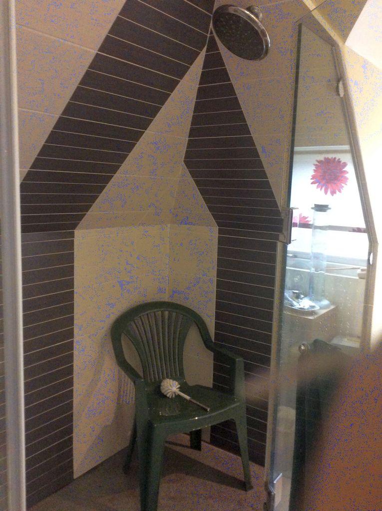

Ferdinand Posted April 14, 2019 Share Posted April 14, 2019 (edited) I have been talking about refurbishing my upstairs bathroom. I also need to do the downstairs for when my elderly mum needs it. I have a couple of some specific questions, and I do not think we have a thread. She also likes sitting in the shower for a rest or a sit-down shower. Currently we have a plastic garden chair for that in a wetroom alcove upstairs. The biggest shower tray I can get in will be 1400 x 800mm (the 800mm is a bit tight, but more would be a pain), as it is under the stairs where there is currently a bath. There will be a fixed screen as many others do , plus a hinged end panel. I'll post a design etc on a blog-post. I need a walk-in shower which is as-good-as-possible rather than "acceptable", without sinking the bank. Questions: 1 - Does a non-slip shower tray offer major benefits? Is there a downside in attraction of muck or cleaning etc? 2 - In looking for a shower screen, are they available with pre-attached grab rails? In practice a pre-attached towel rail may do it, which is what we currently have. But does gonig for one with a rail on make it niche and pricey? How pricey? 3 - Are there glue-on varieties of grab rail, and other help-equipment? Are there versions available which do not look like a clinic? (Shower screens are inexpensive, so it may be the best option to replace the whole thing when the grab rail is no longer needed). 4 - Can anyone point me to a type of fold down shower chair which is more comfortable that the normal institutional-looking ones? 5 - Potentially I *may* be able to fit in a 900mm shower tray, though it would involve moving a towel rad by about 80mm. Since we are now retiling the whole thing, that be worth it. Question for any wise-owl members: is there a major benefit for less mobile people in a 900mm wide shower over an 800mm wide? I have a gut feel it could give a lot more benefit that the small change implies. Cheers Ferdinand Edited April 14, 2019 by Ferdinand Link to comment Share on other sites More sharing options...

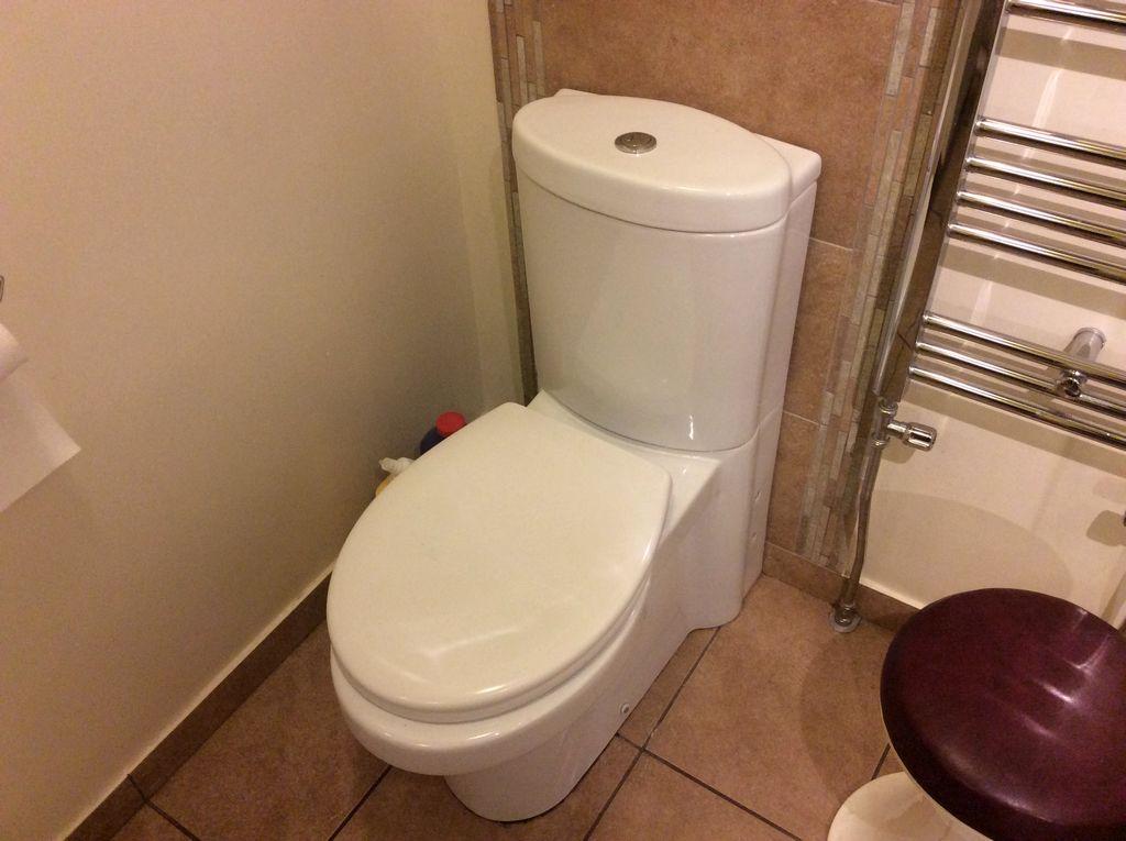

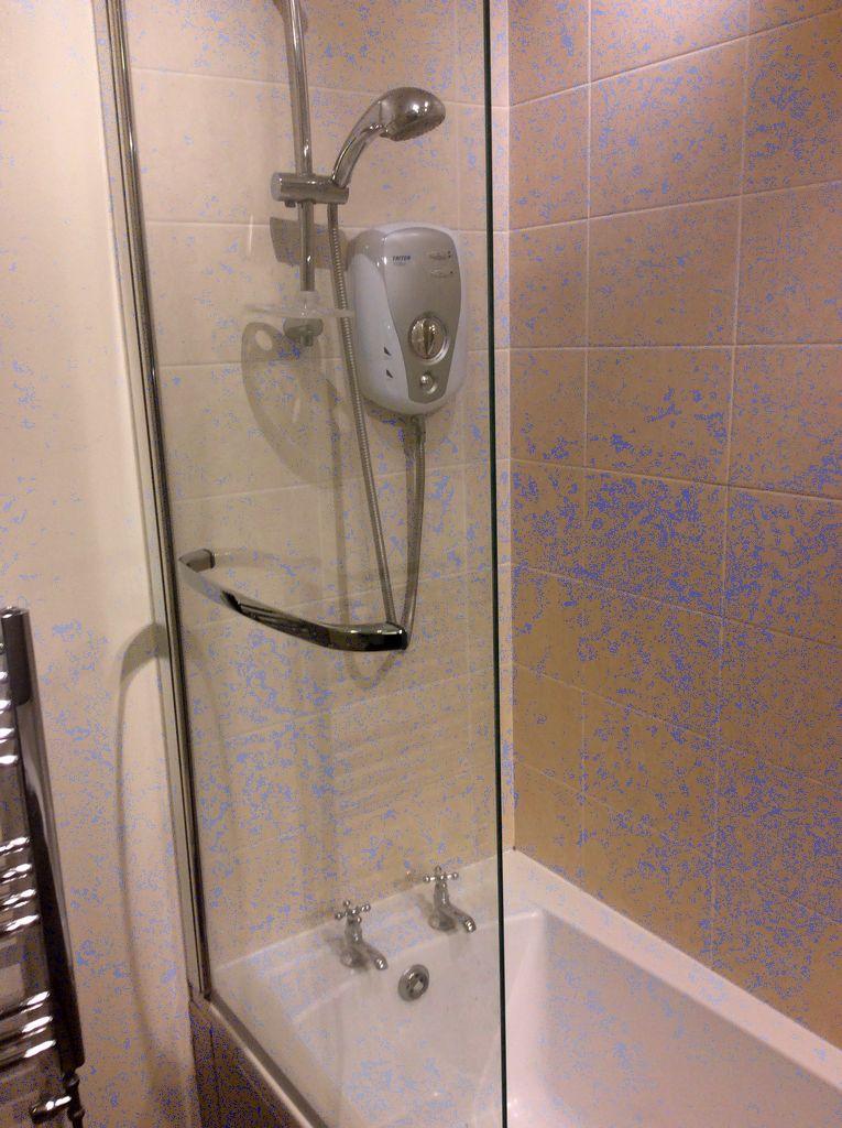

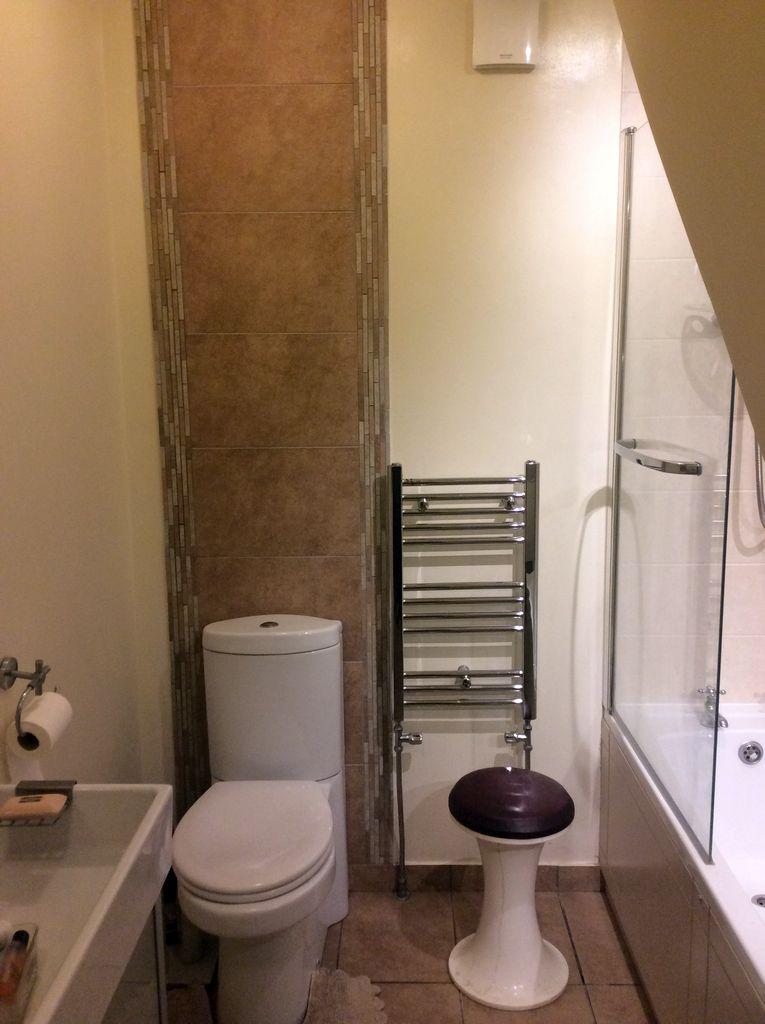

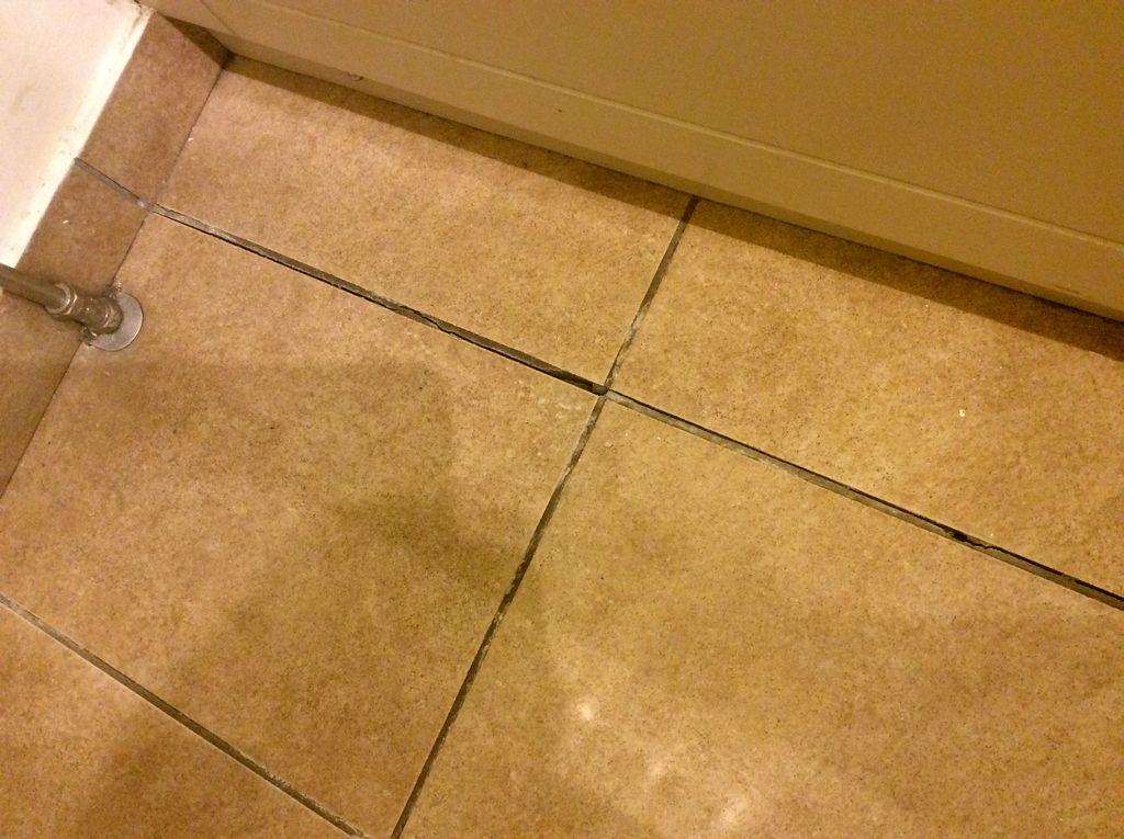

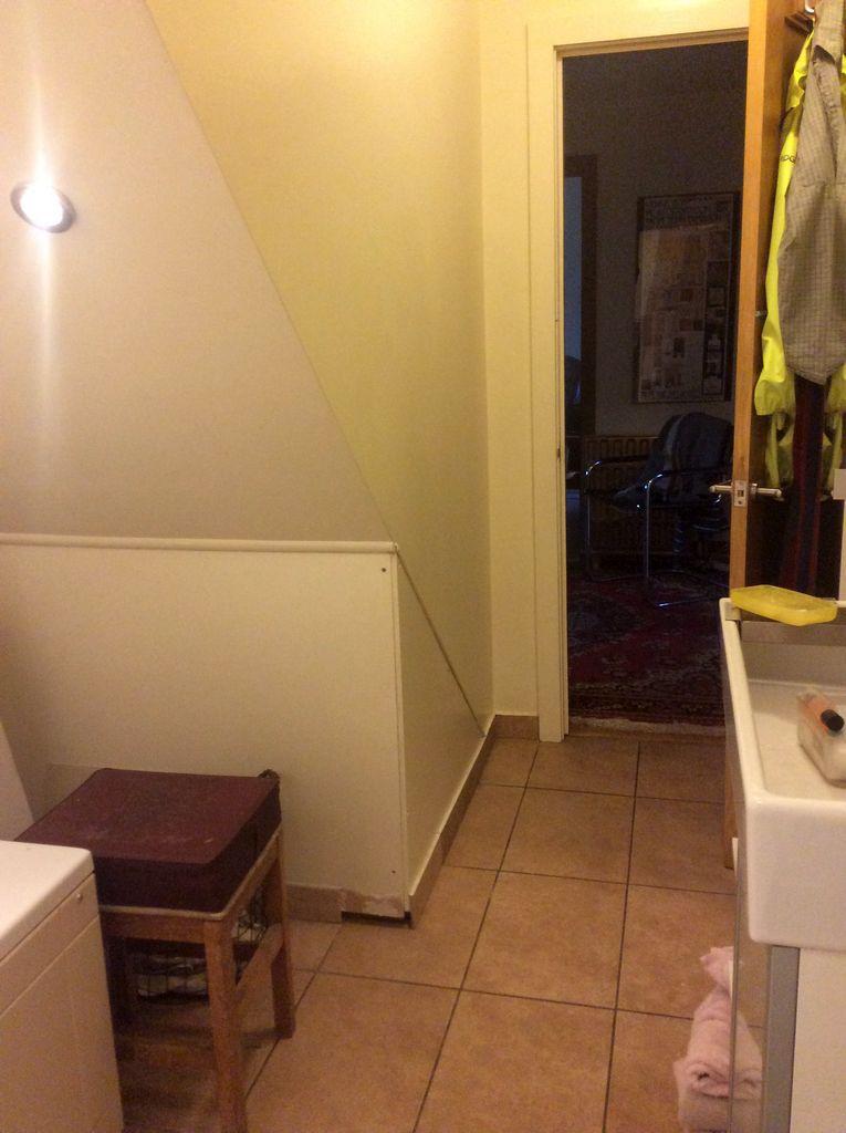

Ferdinand Posted April 14, 2019 Author Share Posted April 14, 2019 Here are a few pictures of the downstairs bathroom as is, and the current Shower Chair. Link to comment Share on other sites More sharing options...
