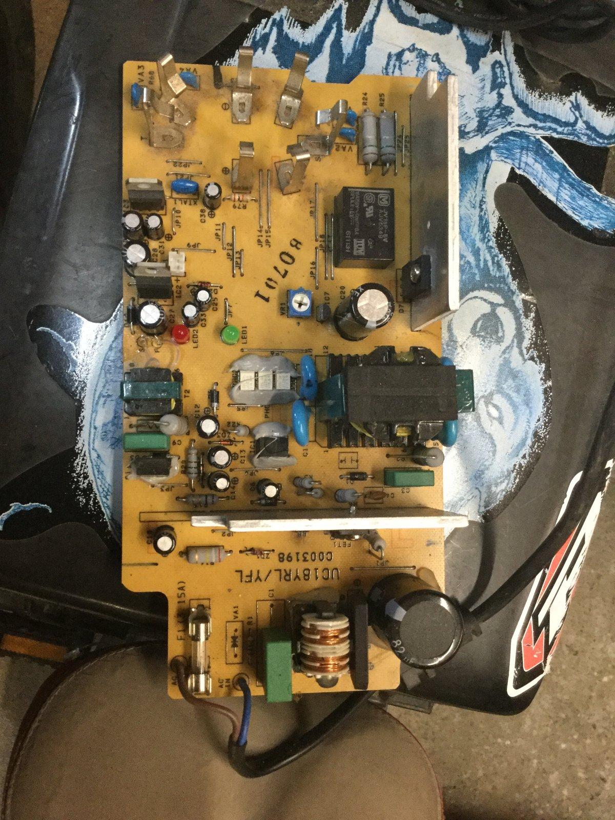

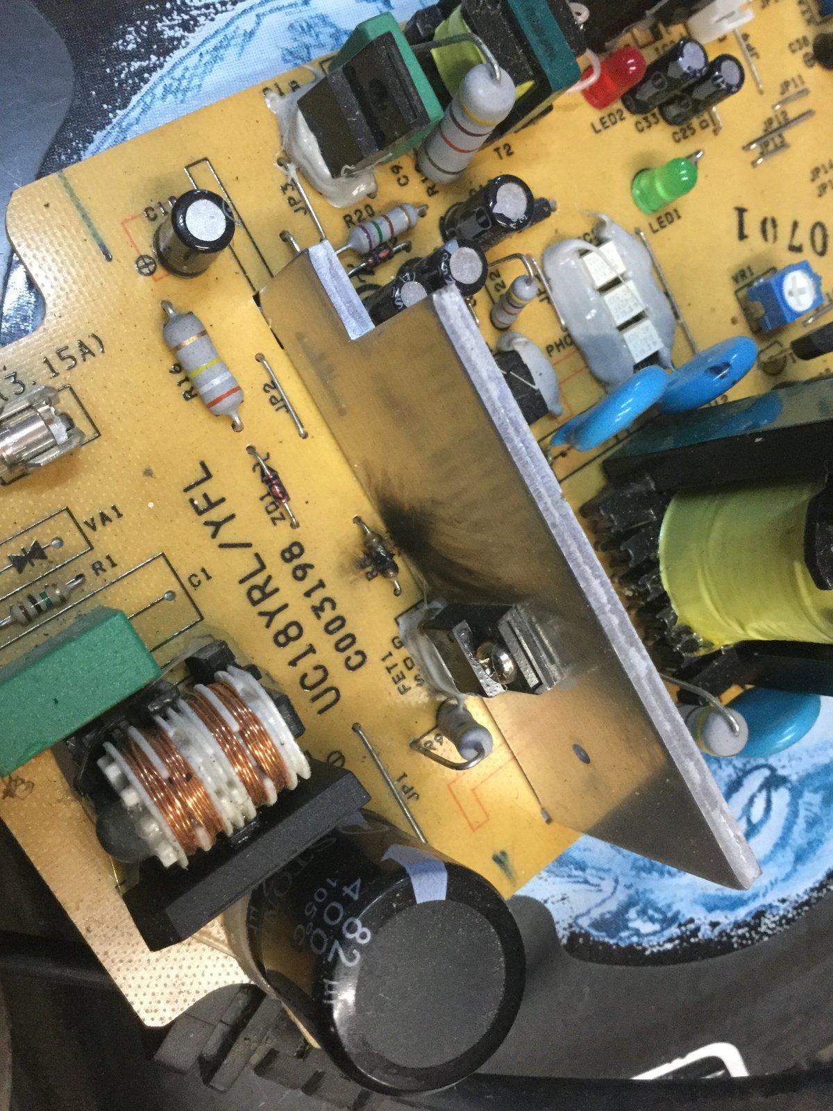

Anyone got a Hitachi  drill charger model UC18YRL/YFL? Resistor on board fried beyond recognition/testing. Only 4 screws on the back to take a look for me.
Cheers

So close but no banana! Almost certainly different. Here's the complete board:

= 10K ohm (10,000 ohms)
If it has burnt out, it almost certainly means something else has gone. but worth a try. I would not be at all surprise if FET1 was dead.

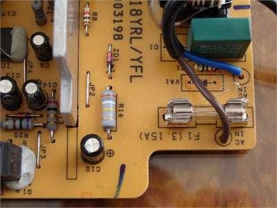

Thanks all! Looks like @dpmiller found the same link. But is it brown/black/ORANGE?
Looks almost brown/black/brown...
Some confusion between 1k & 10K...
http://www.fixya.com/support/t8214626-resister_r8_hitachi_uc18yrl_charger
1st answer says:
"Hi Mark,
R8 Should be a 1000 Ohm 1/4Watt resistor
Rgds Ray"
A bit further down:
R8 looks like a 10K 1/4 watt resistor.
Then:
"The values that i read:
R3 = 4.7 ohm, savety 1/4 W
R4 = 47 ohm, savety 1/4 W
R8 = 1 k ohm, 1/8 W (seen on working PCB)
R9 = 0.47 ohm, savety 1/2 W
these resistors and Fet: 2SK2996 were defective"
Posted
1 hour ago, dpmiller said:
I'd be erring towards a new charger...
Me too but it's not mine and the owner's tight! :)
Posted
It needs someone with a working one to probe it with a multimeter.
some resistor colour bands can go odd colours if the resitor is routinely running hot.
