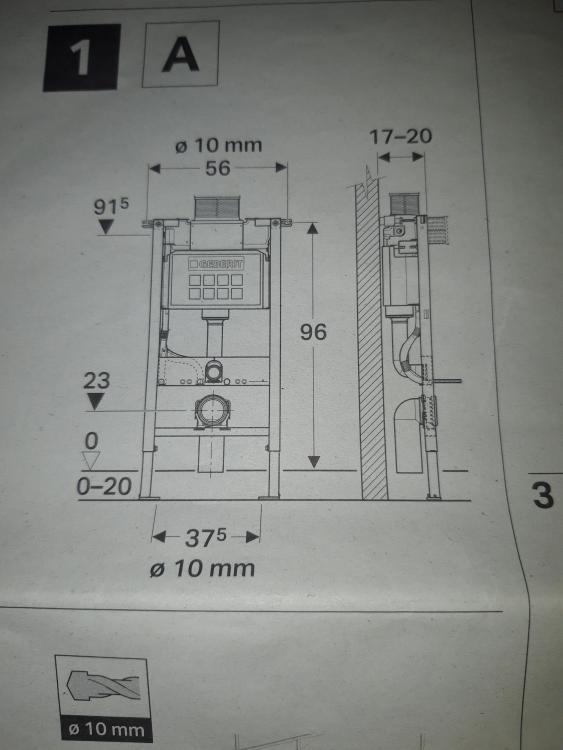

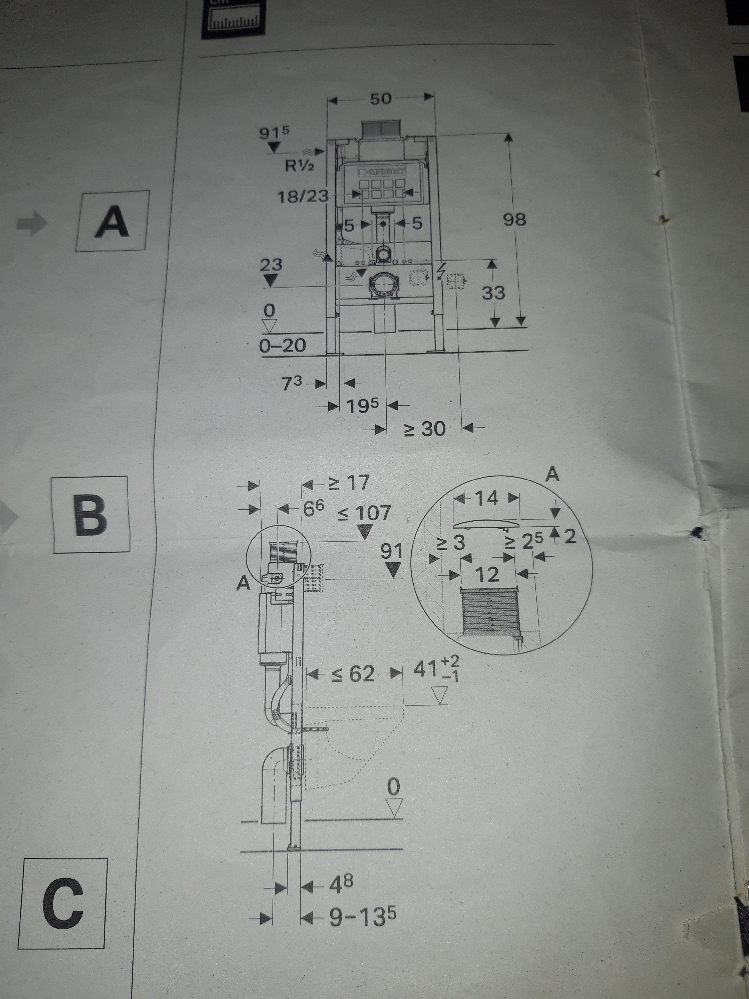

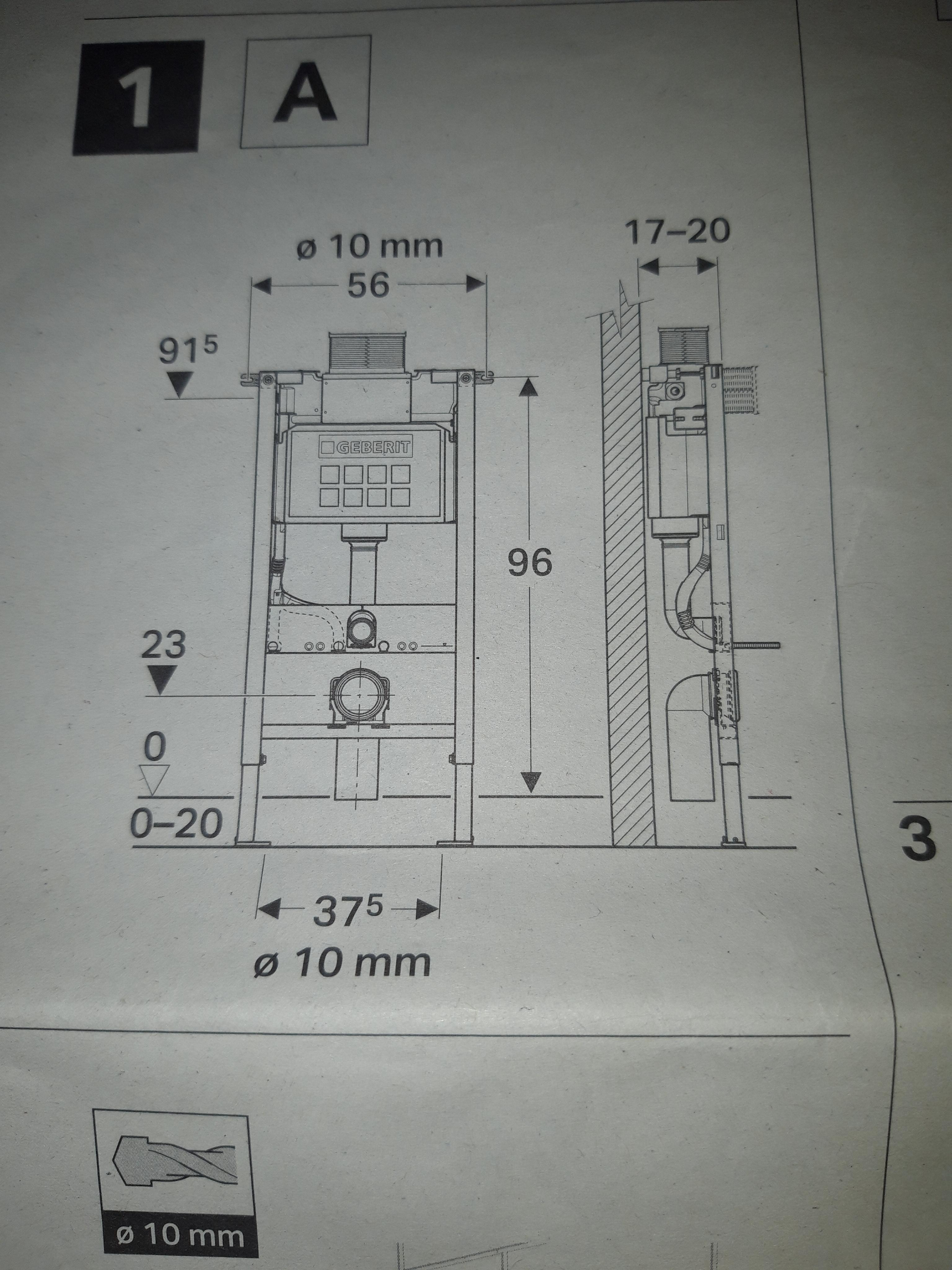

Onoff Posted April 10, 2019 Posted April 10, 2019 My two frames were a bargain £100 the pair. Older models so deeper but work a treat. Geberit instructions are good too. I was lucky in the frame was sited over the old blocked up doorway that ended up 2" lower anyway than the main wall. Over a 3m wide wall not one stud is the same depth range from 90mm to I think 145mm. In part to square the room off and also to allow depth for the pockets as well as wc frame. The studs are concrete screwed to the wall at 5 points minimum. The rears are packed with timber where the screws are then everything foam filled. Geberit instructions are good too. Typical drawings: There'll also likely be a video for whatever frame you get, e.g: 1

Onoff Posted April 23, 2019 Posted April 23, 2019 2 hours ago, pocster said: It’s ok ; watched video again - I guess that’s a “yes” The drawing extracts I posted above are for the older Geberit Kappa UP200 - the 3 frames I have. The video is for a Sigma. This should really help. Full instruction leaflets are here for the Sigma, Omega and Kappa cisterns (not my ones as older and although 15cm Kappa cisterns they're 98cm high frames): https://www.geberit.co.uk/products/installation-systems/geberit-duofix/ 1
Onoff Posted April 24, 2019 Posted April 24, 2019 Your cheapest route at the mo for a Geberit frame is to get a 111.292.00.1 like I have and as per the email but that calls for a stud depth of 170mm. (I'm lucky in that everywhere mine have gone/are planned I can make depth without too much detriment on room size. In the bathroom it went back into a deep studded wall & old, blocked up doorway. In the ensuite it'll go into a dormer cheek / the loft. The downstairs cloak is the only place I'll lose a bit of space but I can move a door frame to grab some back).
