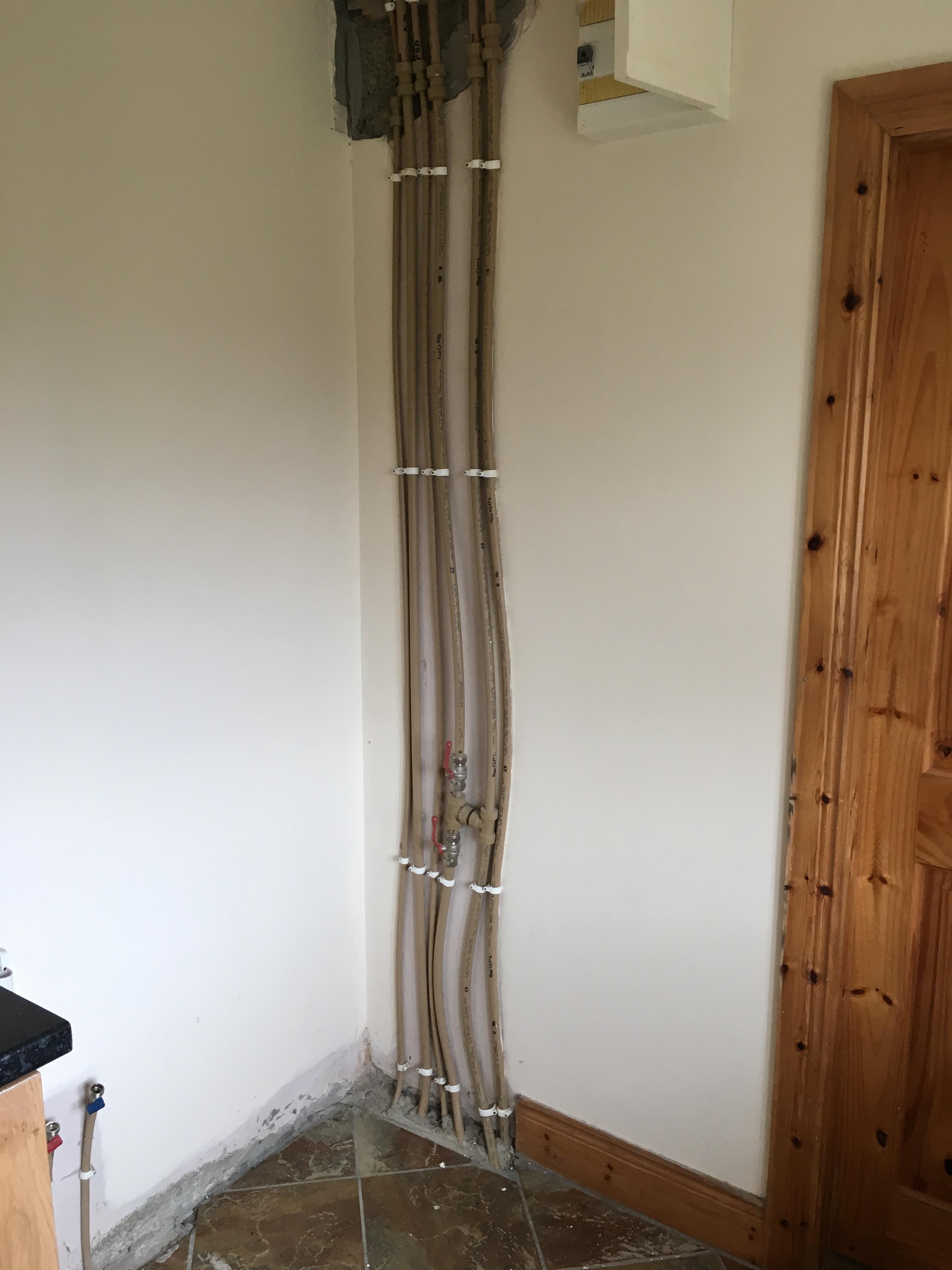

Lurkalot Posted April 9, 2019 Author Share Posted April 9, 2019 12 hours ago, ProDave said: Thermostatic Radiator Valves would help a lot allowing you to some extent set the temperature in each room. How easy is to to fit thermostatic valves, at the moment they just have manual ones? 10 hours ago, scottishjohn said: to make it better you need a bit of a plumbing alteration so you can have hot water +heating under separate control from the boiler . make a drawing the system and post it up and I,m sure NICK --will tell you want you need to change I wish I could, I don't understand it myself though, from the boiler two pipes go straight into the slab, then in the utility room there are a few pipes going from the floor to ceiling but I can't work out what each one does Link to comment Share on other sites More sharing options...
scottishjohn Posted April 10, 2019 Share Posted April 10, 2019 (edited) 9 hours ago, Lurkalot said: I wish I could, I don't understand it myself though, from the boiler two pipes go straight into the slab, then in the utility room there are a few pipes going from the floor to ceiling but I can't work out what each one does pipes go into slab from boiler ? so you have underfloor heating as well as radiators? and there will be 2 pipes going to dhw tank ? does the oil boiler heat the hot water -or is that just from the willis heater ? If you cannot work out the plumbing or draw a diagram of it no one on here will be able to help so you will need to get a plumber in to sort it out how old is the boiler --is it self condensing type? Edited April 10, 2019 by scottishjohn Link to comment Share on other sites More sharing options...
Ferdinand Posted April 10, 2019 Share Posted April 10, 2019 10 hours ago, Lurkalot said: How easy is to to fit thermostatic valves, at the moment they just have manual ones? I wish I could, I don't understand it myself though, from the boiler two pipes go straight into the slab, then in the utility room there are a few pipes going from the floor to ceiling but I can't work out what each one does TRVs are normally easy to fit, and only cost a couple of ££ each. However, some people like me have been known to make it more difficult by crossing threads etc. We probably want confirmation from a resident plumber. eg different types. The thing to remember with TRVs is that they only provide a limiting value on temperature, and no control of heat output, ie how fast it gets there, except to stop it at X degrees. F Link to comment Share on other sites More sharing options...
Lurkalot Posted April 11, 2019 Author Share Posted April 11, 2019 23 hours ago, scottishjohn said: pipes go into slab from boiler ? so you have underfloor heating as well as radiators? and there will be 2 pipes going to dhw tank ? does the oil boiler heat the hot water -or is that just from the willis heater ? If you cannot work out the plumbing or draw a diagram of it no one on here will be able to help so you will need to get a plumber in to sort it out how old is the boiler --is it self condensing type? No sorry maybe i described that wrong, there's no underfloor heating, just two pipes from the boiler that both are routed through the concrete floor of the boiler room. I can see where the pipes go up to the first floor in the utility room, but all the plumbing for the ground floor radiators is under the concrete floor. The boiler does heat the hot water as well as the radiators. The problem I have is working out where the pipes in this image go, there's 6 of them, one of them has the two taps on with a join to another pipe. Not sure why, anyone have any ideas? Boiler is a 2011 grant euroflame 50-70, doesn't say on the label if it is condensing or not and from what I can see online it was available in both types, is there a way to see if it is condensing or not? 22 hours ago, Ferdinand said: TRVs are normally easy to fit, and only cost a couple of ££ each. However, some people like me have been known to make it more difficult by crossing threads etc. We probably want confirmation from a resident plumber. eg different types. The thing to remember with TRVs is that they only provide a limiting value on temperature, and no control of heat output, ie how fast it gets there, except to stop it at X degrees. F Is there a better option than a TRV that does control heat output? Thanks all Link to comment Share on other sites More sharing options...
Ferdinand Posted April 11, 2019 Share Posted April 11, 2019 48 minutes ago, Lurkalot said: No sorry maybe i described that wrong, there's no underfloor heating, just two pipes from the boiler that both are routed through the concrete floor of the boiler room. I can see where the pipes go up to the first floor in the utility room, but all the plumbing for the ground floor radiators is under the concrete floor. The boiler does heat the hot water as well as the radiators. The problem I have is working out where the pipes in this image go, there's 6 of them, one of them has the two taps on with a join to another pipe. Not sure why, anyone have any ideas? Boiler is a 2011 grant euroflame 50-70, doesn't say on the label if it is condensing or not and from what I can see online it was available in both types, is there a way to see if it is condensing or not? Is there a better option than a TRV that does control heat output? Thanks all Probably not for £5 each. Others may have different suggestions. F Link to comment Share on other sites More sharing options...
scottishjohn Posted April 11, 2019 Share Posted April 11, 2019 certainly trv valves have been virtually std on all systems for years now ,so you can have rooms at different temps --so yes they should be fitted anyway and a good starting point.. I certainly do not like the idea of copper pipes buried in concrete --they could corrode with the lime in the concrete +you will be loosing lots of heat into the concrete sounds like a real FIY job all round . time to call in a REAL heating engineer and get some on site advice and i,m pretty sure what will say Link to comment Share on other sites More sharing options...

Lurkalot Posted April 18, 2019 Author Share Posted April 18, 2019 Thanks everone who helped, I now have a Salus wireless thermostat in our living room and the room is keeping to a better temperature and I can already tell the boiler is running less of the time. I'll have to keep an eye on how much oil is being used now. I spoke to a plumber who's had a look and it is not a condensing boiler, that will be something that we will have to change too. The plumber luckliy had done some work on one of the other houses in the same estate which was plumbed the same way and could tell us how it was done. The two manual valves on that pipe in the photo control the flow to the radiators, one for upstairs and one downstairs. This does allow us to have just the hot water on by manually closing both valves. He's going to give us a quote for upgrading to automatic valves connected to a controller that can assign seperate times for each zone. I have also noticed there a big difference in how hot the radiators get, I'm assuming this is down to needing to be balanced? Link to comment Share on other sites More sharing options...
