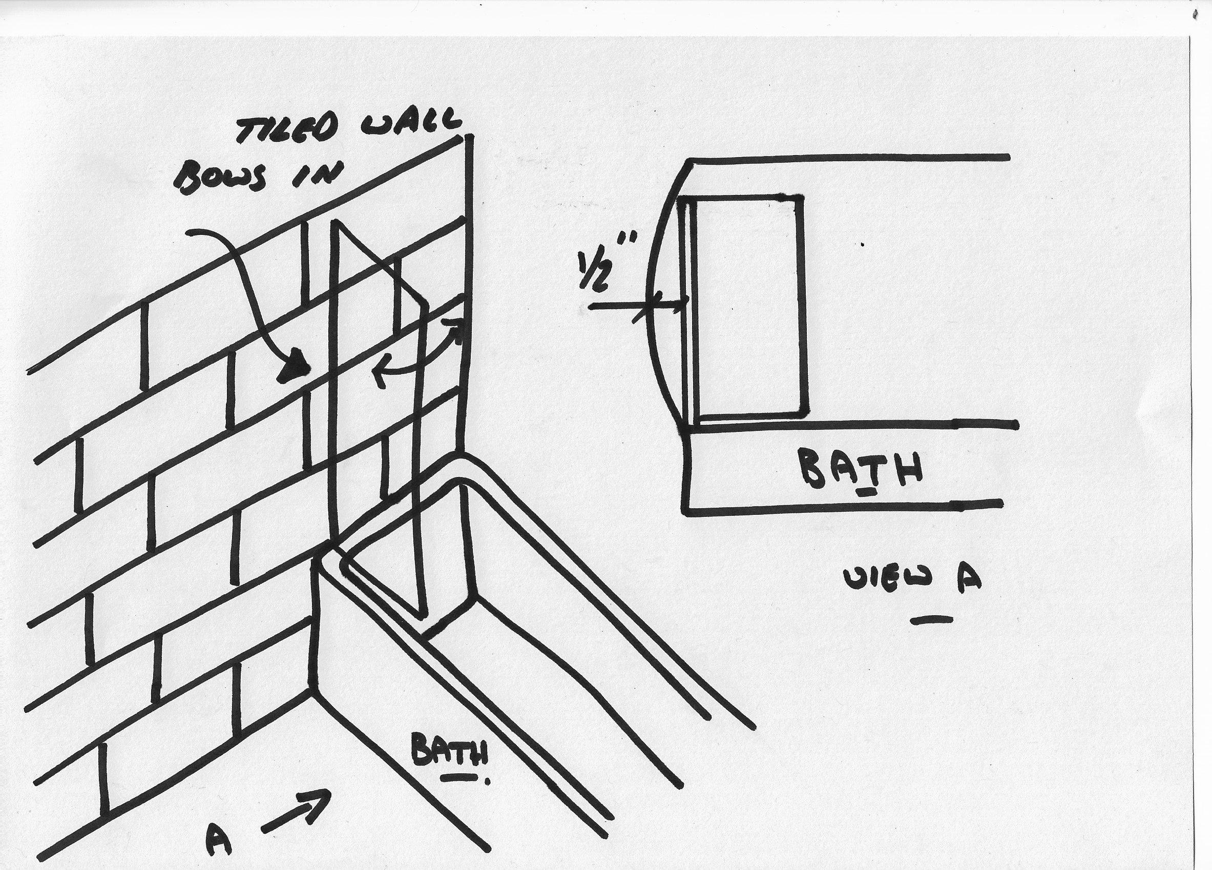

Onoff Posted June 4, 2019 Author Posted June 4, 2019 (edited) Right, mate's made a faux pas. (Yes, my mate, not me! ) When he's come to fit his shower screen he's tiled the wall and it bows inward roughly like the sketch below. He reckons it touches at the top and bottom but there's "a gap he can put his finger in" so guess about 1/2". Searched solutions suggest ripping tiles off and starting again or cutting a groove in the tiles for the shower screen channel to sit in neither of which he fancies doing. The frame I think allows for the wall to be 6mm out...he's way off! Any other suggestions? @Nickfromwales? Cheers Edited June 4, 2019 by Onoff
ProDave Posted June 4, 2019 Posted June 4, 2019 Usually there is a channel that screws to the wall into which the screen then fits. Can he not bend that channel to match the wall, or at least get close before the screen goes into the channel? I wonder if he just unscrewed the screen + channel complete and previously it bowed the other way?

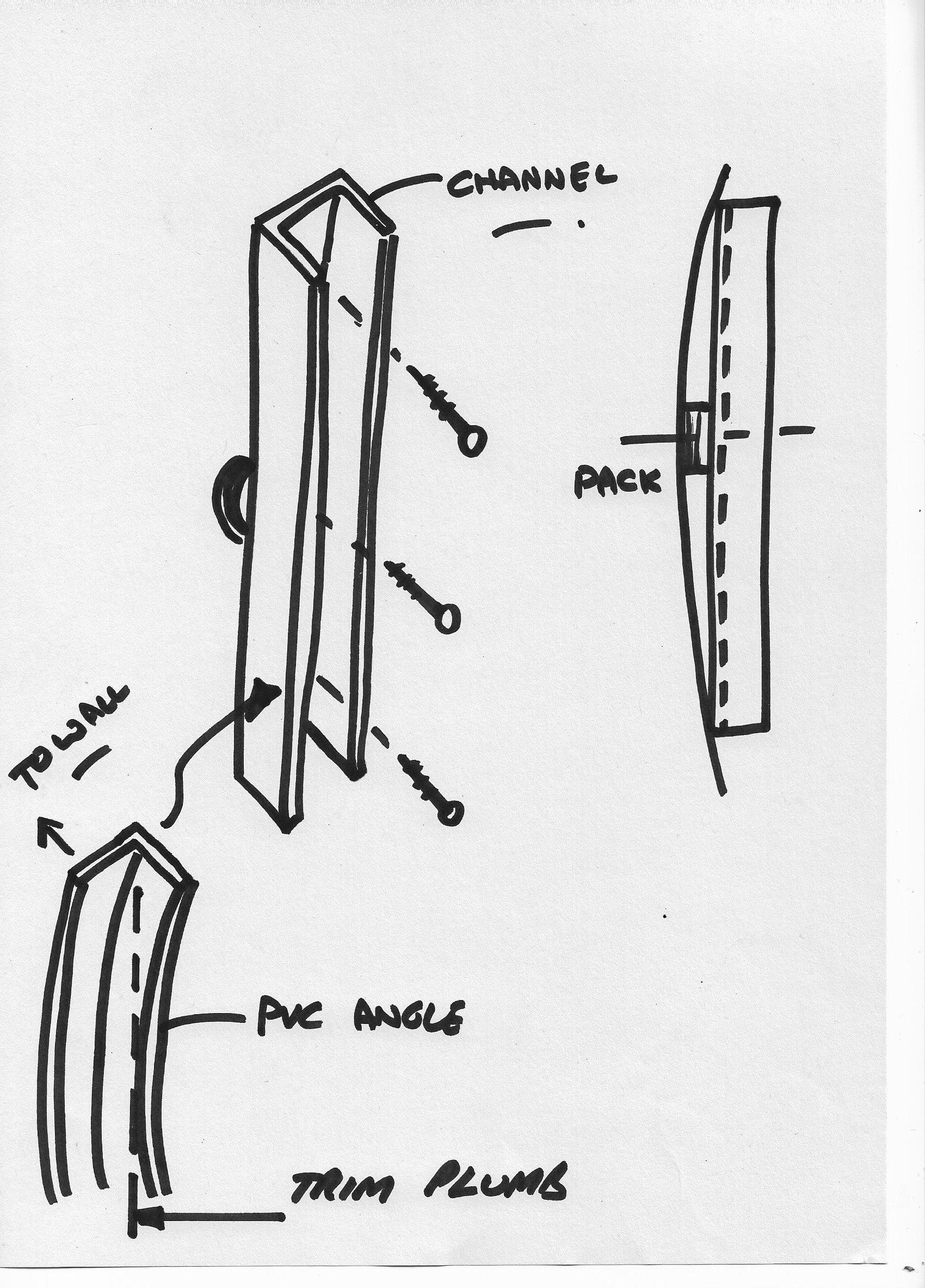

Onoff Posted June 4, 2019 Author Posted June 4, 2019 19 minutes ago, ProDave said: Usually there is a channel that screws to the wall into which the screen then fits. Can he not bend that channel to match the wall, or at least get close before the screen goes into the channel? I wonder if he just unscrewed the screen + channel complete and previously it bowed the other way? What he's saying is putting channel against the wall and it's 1/2" out in the centre. Almost needs a bow shaped, v.long packer. I'm thinking on the lines of screw the channel to the wall with the gap, packed out at the fixing points with st/st penny washers. Then affix some white pvc anlge either side stuck on with CT1. Trim the angle plumb to the channel.
ProDave Posted June 4, 2019 Posted June 4, 2019 The channel is there to allow for non plumb walls etc. There is usually a lot of tolerance in fitting the screen into the channel so then get the screen plumb, even if the channel is not. Are you saying the amnount of bend exceeds the depth of the channel so that won't work?
Onoff Posted June 4, 2019 Author Posted June 4, 2019 15 minutes ago, ProDave said: Are you saying the amnount of bend exceeds the depth of the channel so that won't work? Yes exactly that.
ProDave Posted June 4, 2019 Posted June 4, 2019 Since he is obviously happy with bodged, rubbish work, put some spacers under the screws in the middle and empty a tube of silocone sealant in the gap.
Nickfromwales Posted June 4, 2019 Posted June 4, 2019 4 hours ago, ProDave said: Since he is obviously happy with bodged, rubbish work, put some spacers under the screws in the middle and empty a tube of silocone sealant in the gap. A bit harsh ? 15 hours ago, Onoff said: Any other suggestions? @Nickfromwales As you said a bit further on, just pack the middle with something non-ferrous ( steel washers vs alu might have an electrolytic action? ), mask the wall and the channels, pump the void full of clear CT1, square off with a plastic scraper, de-mask and then pvc D-section both sides to suit. Not pretty, but 800 times better than whothefeckever suggested cutting a slot into the tiles ??????
Onoff Posted June 4, 2019 Author Posted June 4, 2019 (edited) I wish he'd given me a dimensioned drawing instead of these 4 video clips, can't really gauge the gap on my phone: Edited June 4, 2019 by Onoff
Onoff Posted June 4, 2019 Author Posted June 4, 2019 15 minutes ago, Nickfromwales said: steel washers vs alu might have an electrolytic action? St/st washers would be alright. Just duct tape between the last washer and the ali. 15 minutes ago, Nickfromwales said: pvc D-section both sides to suit. Do you mean quadrant? Where do you get it?
Nickfromwales Posted June 4, 2019 Posted June 4, 2019 D section. Smaller size if poss but ripped down to make long bow shaped infills.
Onoff Posted June 5, 2019 Author Posted June 5, 2019 5 hours ago, Nickfromwales said: D section. Smaller size if poss but ripped down to make long bow shaped infills. Cheers. And that'll bend the "wrong" way? With a couple of small clamps whilst it sets I suppose! I was thinking this:
ProDave Posted June 5, 2019 Posted June 5, 2019 That gap looks a small fraction of the channel thickness. Are you SURE the channel won't just pull in and flex enough to fill that gap?
Onoff Posted June 5, 2019 Author Posted June 5, 2019 39 minutes ago, ProDave said: That gap looks a small fraction of the channel thickness. Are you SURE the channel won't just pull in and flex enough to fill that gap? He's going to re-look at it. Seems there was anyway a bit missing from the fixed screen kit.
Nickfromwales Posted June 6, 2019 Posted June 6, 2019 I think I agree with @ProDave, in that it should just pull back. Even though it will distort slightly, you can simply feed the screen in at the top where it isn't distorted, and then push it in as you work downwards to get the whole screen into the profile.
