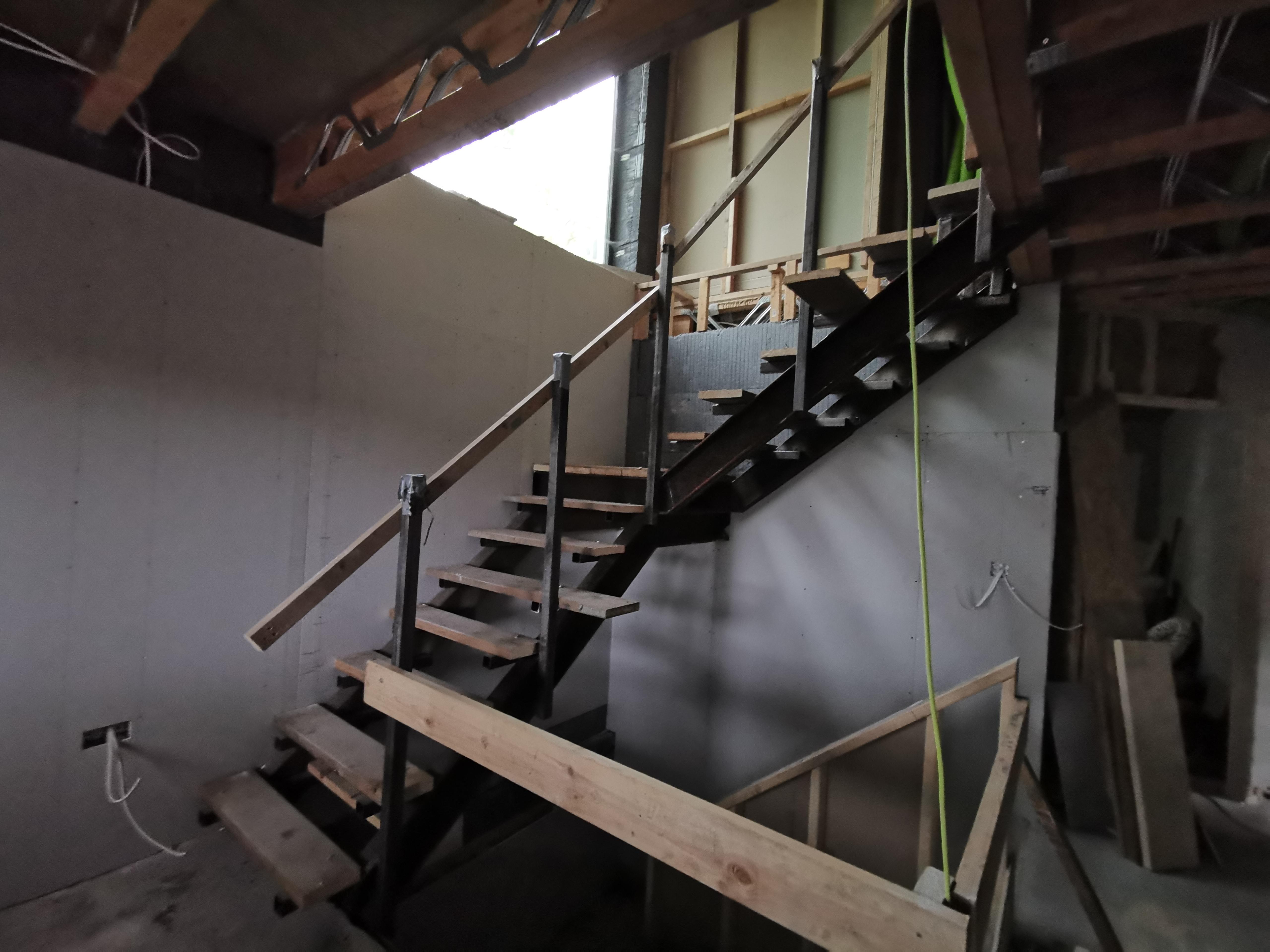

OK so a bit further forward today - handrail uprights are fully secured and a temporary handrail attached for safety...
Next up are the oak treads and risers, and the full plasterboard handrail / wall.

1. Remove the temp treads (they're just scaffold planks sawn down to fit)
2. Clean up the PFC by wire brushing it and then maybe a coat of red oxide
3. Build the handrail (4x2 timber screwed to the box section steel, plasterboarded on both faces)
4. Tek bolt timbers to the underside of the PFC
5. Fit oak treads and risers (fixed from behind /underneath)
6. Underboard the PFC with plasterboard, finishing flush with the bottom of the handrail
7. Sleep

Yep I think so... Unless you have a better idea? In you look back to the early pics, the steel isn't in great condition - grinding off rust for the welding revealed a few pockets of over 3mm depth - not great for steel advertised as "clean"!
You're going to be fighting mill scale where it's not rusted. I'd mechanically wire brush as best as and wipe down with panel wipe/thinners or white spirit  at a push & let dry.
Tbh hammer finish would be my choice. Not necessarily Hammerite, imo it's gone right downhill. Flag brand hammer paint is pretty good. Best hammer finish I've ever used though Firwood 130 from a firm in Bolton.
