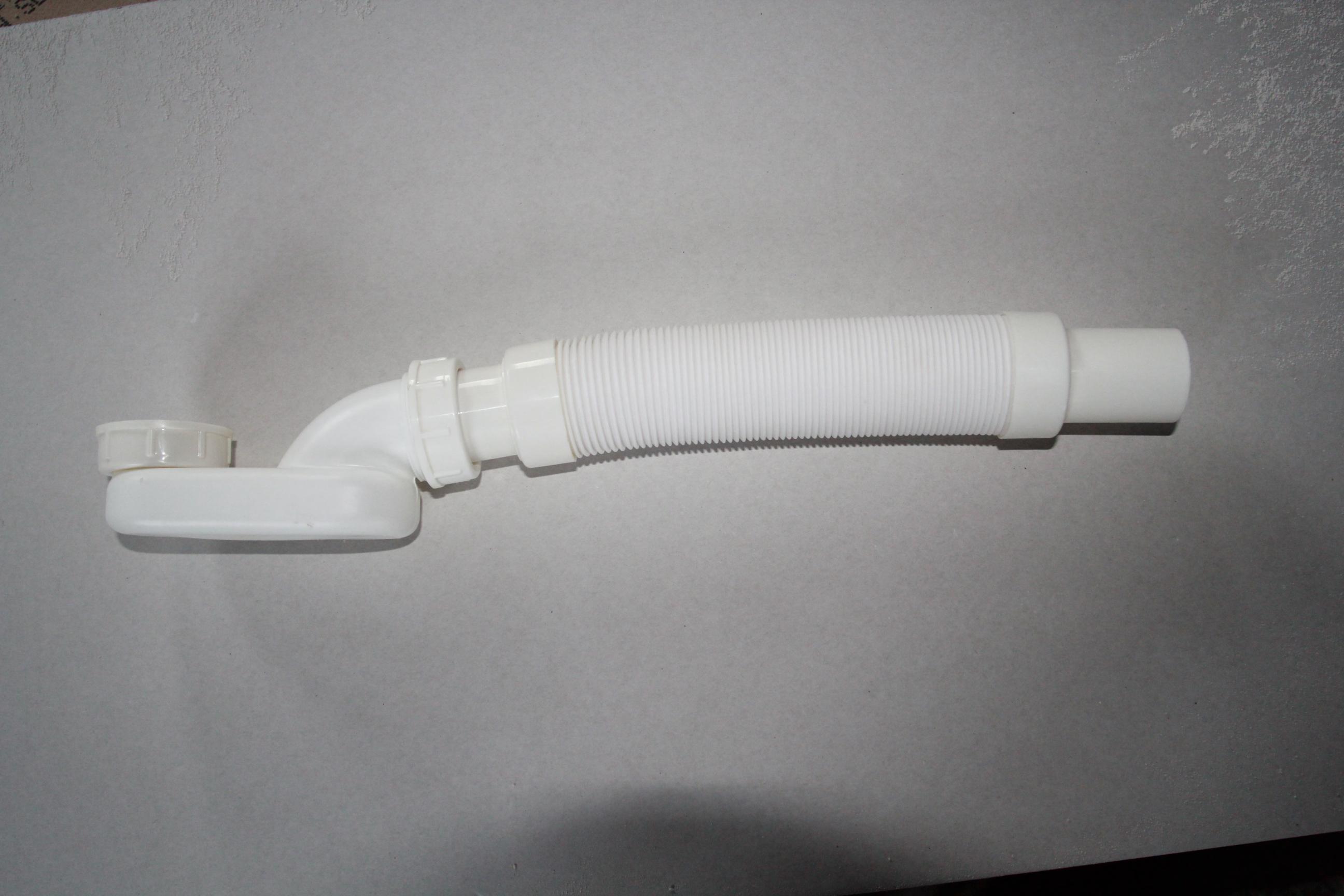

Just getting around to fitting our free standing bath and just battling with the waste.   The next job is to connect it up to the waste pipe under the floor - but I'm not sure of the coupling.
The waste pipe that came with the bath looks like this
The end that needs to go into the waste has an external diameter of 39mm - in fact it seems to be tapered slightly from just below 39mm up to just over 39mm - does this get glued into a  solvent welded pipe? or do I need to find a connector?
Does anyone know?
Cheers
TBH that looks like cheap blown polyethylene and I wouldn’t want that under my bath... you need a low profile bath trap - McAlpine make one, as do others. Then you can build up using standard bits.
OK Peter, so something like this then
https://www.screwfix.com/p/mcalpine-bath-trap-white-40mm/84362
into a short piece of 40mm pushfit pipe and then connected to
https://www.screwfix.com/p/mcalpine-flexicon4-flexible-connector-white-40-x-157-242mm/86386
This then onto the 40mm pipe work under the floor.
Shame I can't get a one piece bit.

Okay, so this is a free standing bath, presumably one that fits into a surround (otherwise if the waste was on show it would be a nice looking one)
If it is like mine you are supposed to fit the bath into it's surround with this flexi waste. Then stand the complete bath up on blocks, connect this flexi waste, and remove the blocks and lower the bath into position.
I thought the whole arrangement was total and utter carp.
Instead my bath was mounted on the floor and I connected it from below using a conventional rigid waste and rigid pipe before the ceiling in the room below was fitted.
IF I ever need to remove the bath again, I will cut a small trap in the ceiling below (utility room) to uncouple the rigid waste and trap.
To mitigate the chance of ever needing to remove the bath from it's surround, I used a pop up waste with top entry cleaning, so no mechanics of say the type of waste where you rotate the waste fitting to pop it up for example to go wrong.  And I used a floor standing bath filler, so no tap or flexi hoses within the bath surround to ever go wrong or need replacing.
@ProDave has got it - sorry Nick et al.  No ceiling on below the bath yet so it could all be done from below but would like to maintain top access - if it goes wrong it could be accessed from the floor - lift and disconnect the bath & its surround + bit of buggeration = jobs done.
