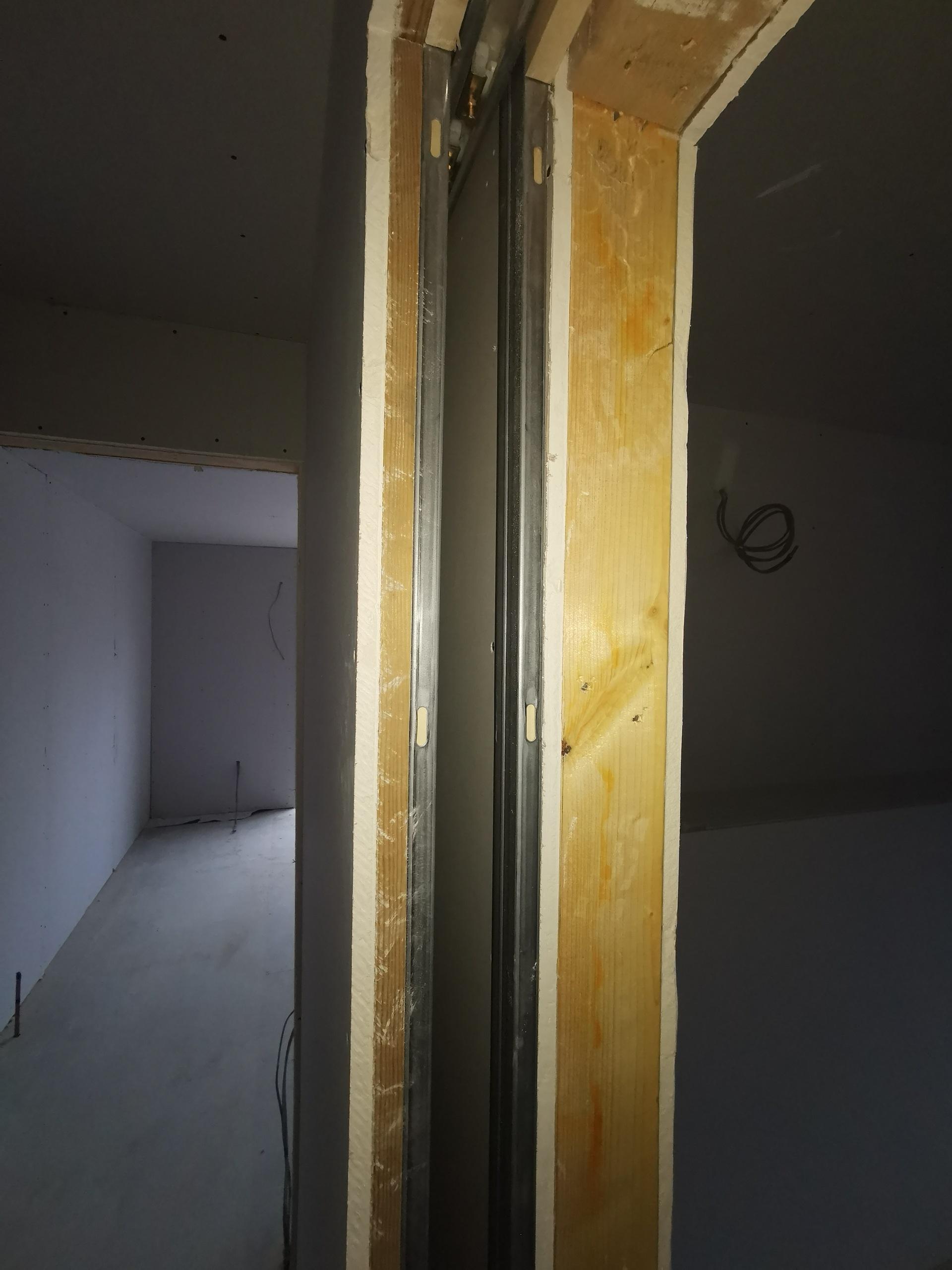

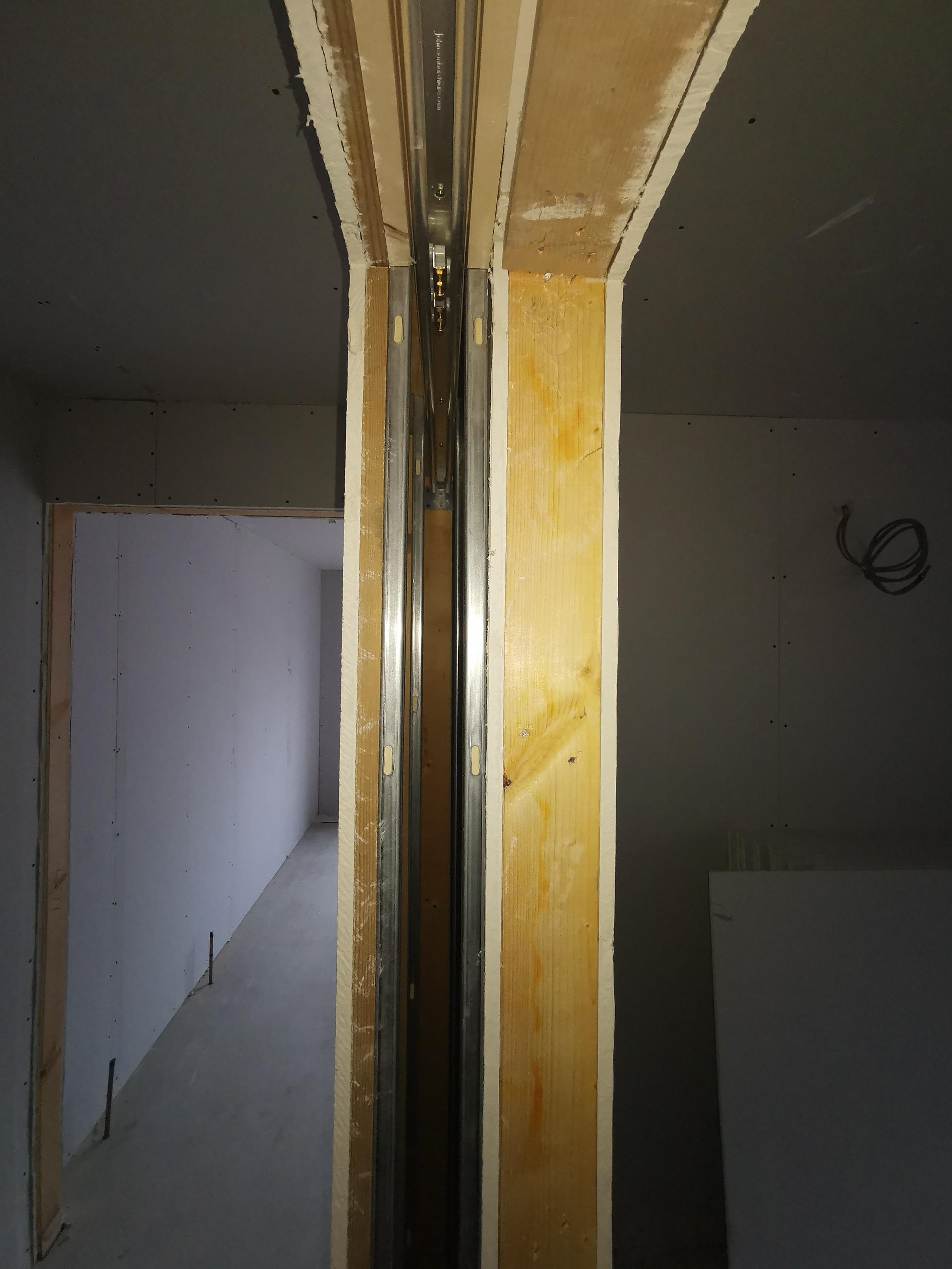

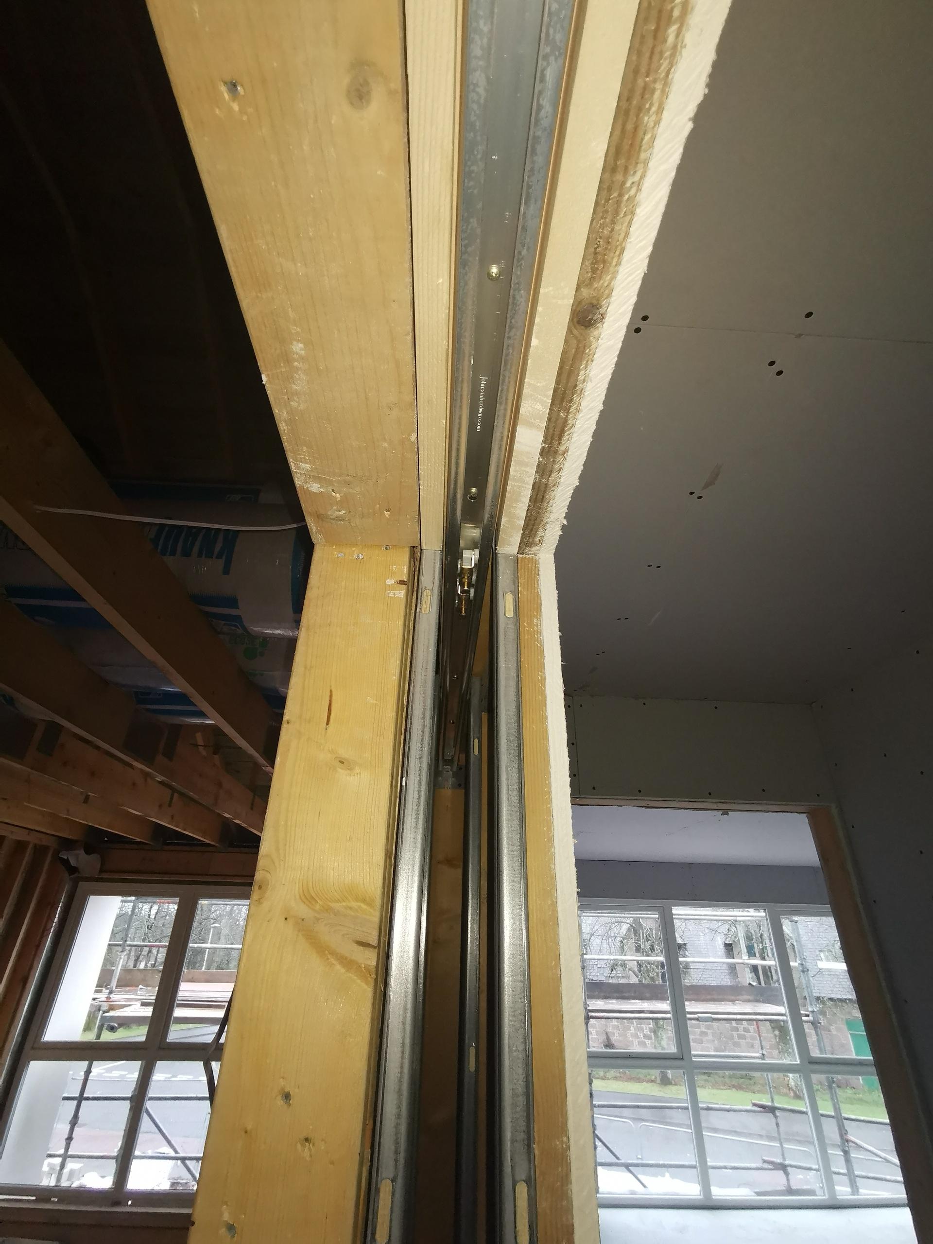

mvincentd Posted April 2, 2019 Share Posted April 2, 2019 I've just plasterboarded my Eclisse sliding door frame and the result is pretty flimsy. I'm considering taking it all off and starting again with ply instead but i'm not convinced the same thickness of ply will make a load of difference. Also the minimal depth of grab the supplied screws achieve into the steel frame (to avoid intruding into the pocket) make me unsure about choosing a much chunkier heavier ply thickness (...and thicker material will necessitate more mitigation when it comes to the supplied lining kit too). Interested in others experiences and solutions, thanks? Link to comment Share on other sites More sharing options...

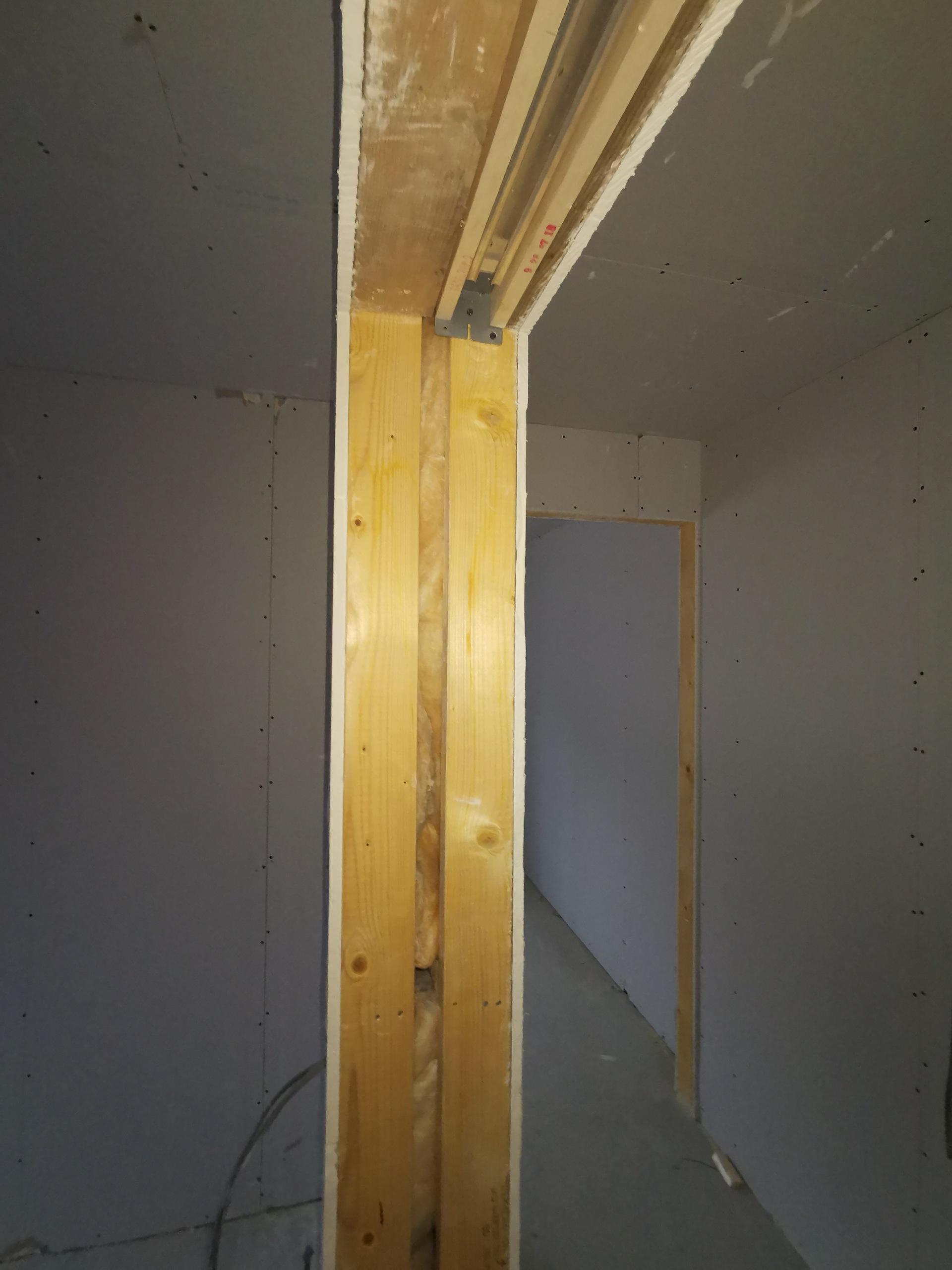

ultramods Posted April 2, 2019 Share Posted April 2, 2019 (edited) I have just had two of these fitted: https://www.coburn.co.uk/product/hideaway/ My joiner really doesn't like pocket doors and said this one is the best of a bad bunch (from his experience) The frame is encased in the middle of a 90mm partition and loos like 20mm. Obviously this approach takes up more space, however the wall is still fully insulated and feels very sturdy Edited April 2, 2019 by ultramods 2 Link to comment Share on other sites More sharing options...

Weebles Posted June 23, 2019 Share Posted June 23, 2019 Delayed reaction to this post. Been stupidly busy. We have Eclisse pockets. All have ply then plasterboard and feel very solid with the double layer and a skim. They are a bit hollow sounding but the space saving convenience is worth it. All on en-suite bathrooms so hopefully noise won’t be too much of an issue and will be personal to the occupants of the bedroom / bathroom. ? We were advised to put the ply layer on so that we could fix things to the wall. Its a bit stronger with the extra layer. 1 Link to comment Share on other sites More sharing options...
mvincentd Posted June 24, 2019 Author Share Posted June 24, 2019 I ended up taking the pb off and adding 12mm ply beneath......adequate, not good. If I ever encounter this again I will embed the pocket into a stud construction and accept the resultant thick wall. Link to comment Share on other sites More sharing options...
