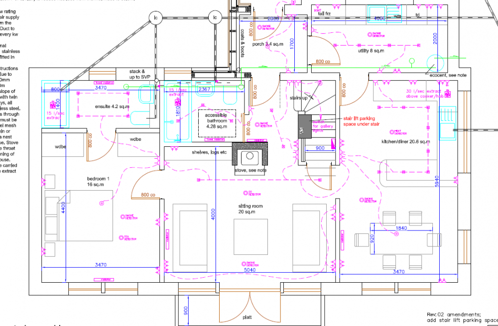

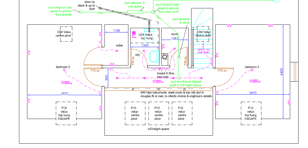

Doing that classic self building thing, changing plans.
Since we put up the chipboard flooring, we are rethinking about the use of the middle part of upstairs.
We are due to have a wardrobe, wc and store cupboard here, but now thinking of removing this and having a single small open living space.
What I'm unsure of is the regulations concerning a stove pipe running through a room, do you have to plasterboard around a pipe or can you leave this exposed? Here is the plan.

11 minutes ago, PeterW said:
What is the stove below ..? Is it just a straight double skin flue or some sort of masonry hearth ..? It may be easier to build up some sort of brick or masonry chimney through the building.
Yes, here is the ground floor plan. The ground floor is due to have blocks around the pipe to the ground floor ceiling and then it would have been in a plasterboard box, within the store cupboard. But if the store is gone the stove pipe will either need to be just visible or covered in some way.
