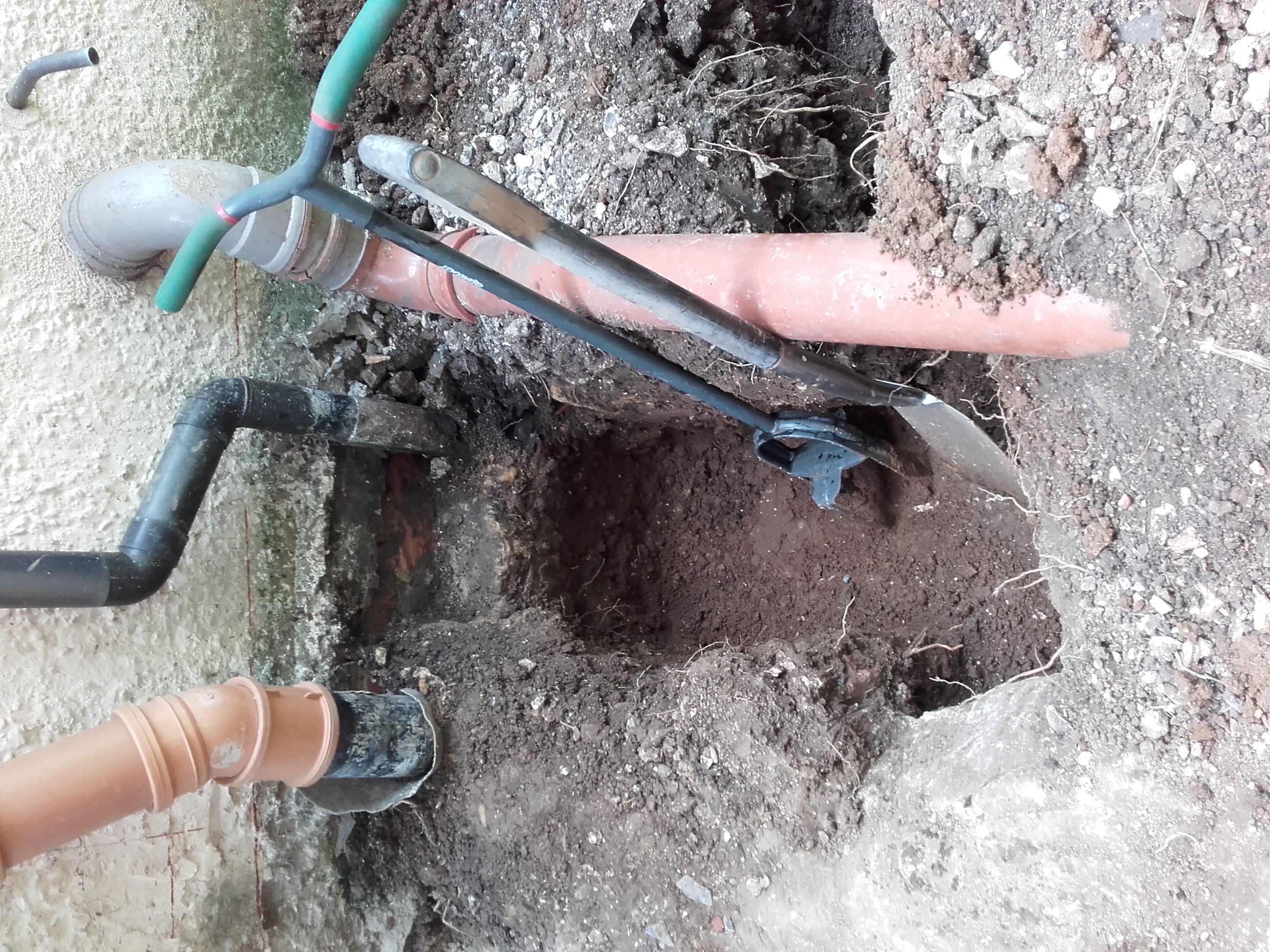

Onoff Posted August 24, 2016 Author Posted August 24, 2016 Well at least it's not about 30deg and I'm digging by hand..... That bits done at least. Off to find a route in for the MDPE now. I've a 1m SDS bit but it's only 24mm dia.
PeterW Posted August 24, 2016 Posted August 24, 2016 Wiggle the SDS about and you will have plenty for a 25mm MDPE
Onoff Posted August 24, 2016 Author Posted August 24, 2016 So..... 50mm Starrett hole in the corner of the wc: 12 then 16 then 25mm 1m SDS thru to until I hit "mud": No way, even with "wiggling" would the 25mm MDPE go through. So BiL's drill with a 32mm bit: A bit of thick wall, st/st, 50mm OD tube, cut at a slight angle, to guard against the tunnel bunnies under the floor: Where it comes in under the footings: And inside:

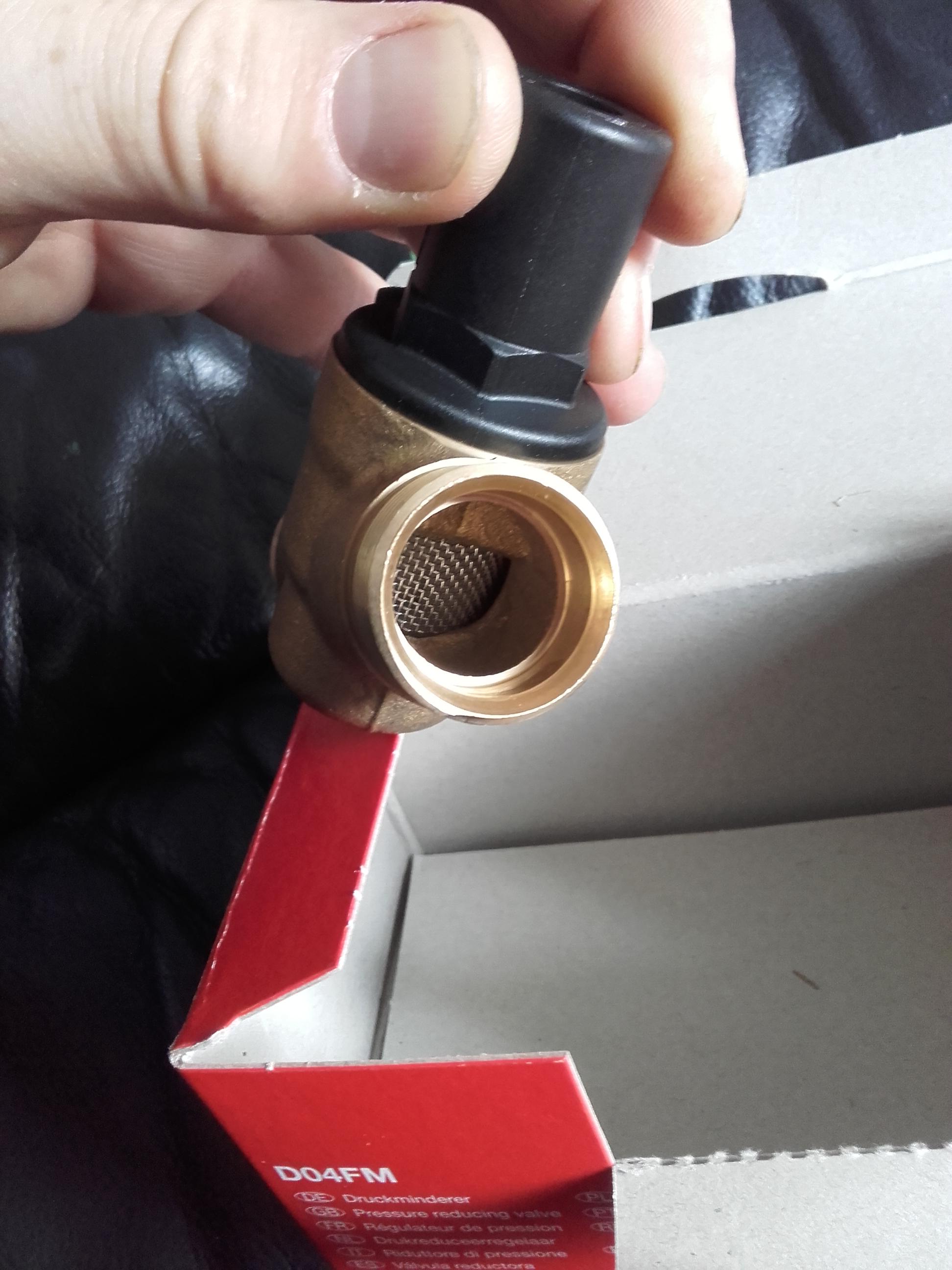

Onoff Posted August 27, 2016 Author Posted August 27, 2016 Reading the PRV instructions it says: "For residential applications where maximum protection against dirt is required, install a fine filter upstream of the pressure reducing valve". Is this really necessary? (In the words of Arthur Daley, "Stick it on the ta..." )
Nickfromwales Posted August 27, 2016 Posted August 27, 2016 10 hours ago, Onoff said: Just because there's no exposed pipework shouldn't you still cover the tap in winter with one of those insulated jacket things? I'd obviously sleeve the 15mm copper where it passes thru the wall. Would it be advantageous to run in an over size sleeve and insulate around the pipe? Drill an 18mm hole and just wrap it with insulation tape. If you make the hole too big you'll stuff yourself when you come to drill and fix it. The fixing holes are quite tight to the pipe so don't take away the brickwork that you'll need to drill, plug and screw into
Nickfromwales Posted August 27, 2016 Posted August 27, 2016 43 minutes ago, Onoff said: Reading the PRV instructions it says: "For residential applications where maximum protection against dirt is required, install a fine filter upstream of the pressure reducing valve". All the PRV's I've seen ( on the multiblocks ) have had an integral stainless gauze filter. I can't recall if a regular / stand alone PRV has one or not. Do you have the link to your one? If your reading the instructions I assume you've bought one already?
Onoff Posted August 27, 2016 Author Posted August 27, 2016 It's this one, already bought: http://www.screwfix.com/p/honeywell-pressure-reducing-valve-with-guage-22mm/4671j It does already have a st/st gauze in which is removable for servicing and cleaning according to the instructions. You can see it up the inlet:
