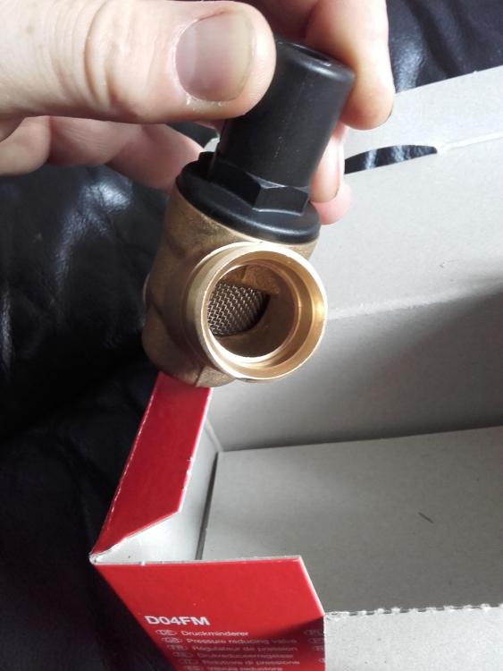

3 minutes ago, ProDave said:
Top tip. do NOT connect a PRV to newly installed plumbing.
I did that when our water to site was first installed and I wanted to reduce the pressure to the static 'van.
The PRV did not work. With no flow, the pressure slowly crept up.
I stripped it down and it was full of grit from the new, unpurged pipework. Cleaned it out, re assembled and it now works.
so I guess what I am saying is on a new install make provision to fit it but fit a bypass until everything has been purged and is nice and  clean.
Good point, a lot of failure is down to shite in the valve. The strange part is that the stainless gauze filter is on the incoming side normally so doesn't usually allow over pressure events, just poor flow / low pressure.
You really shouldn't fit any bypass as that will allow full range pressure to get to sensitive equipment. We all know that 'temporarily fitted measures' always end up never getting changed to the way they should so I'd advise against that tbh.
All relief valves will have installation practices clearly stated, as in "thoroughly purge all primary pipework prior to commissioning the valve" etc etc. That takes care of any lumps of solder, flux etc, and then the integral stainless gauze filter in the PRV takes care of any subsequent crap. Annual cleaning of the filter and checking of the set / operating / actual pressure is also paramount.
On the PRV's I always fit a primary and secondary pressure gauge so I can see the incoming and secondary pressure differences. If they both match, your in need of maintenance ( or your pressure is lower than the set value of the valve ).

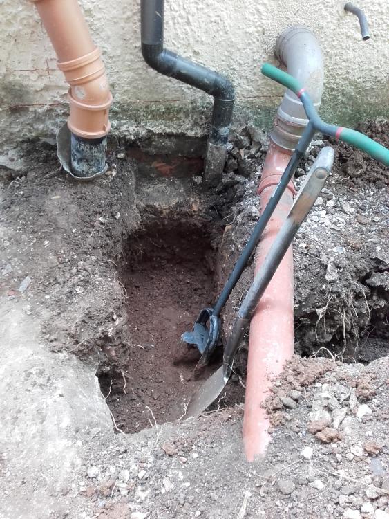

8 hours ago, Nickfromwales said:
Any chance to get it redirected so you can upsize the incoming cold mains to 22mm?
I will look at getting to 22mm after the 25mm MDPE so at least there's  some provision for later. It may be that for now it has to stay in 15mm thereafter via a reducer.
So I'm basically looking to change the position of the incoming mains more out of necessity than choice as to "where". What I have (luckily?) is a 15mm copper drop coming out of the loft to feed the antiquated downstairs wc cistern and cold for the basin. This wc is in fact at the end of a corridor hived off of the big downstairs bedroom. Wall to the left is a stud separating the bedroom, wall to the right is solid brick/block separating the totally gutted, being refurbished, downstairs bathroom (the saga of which can be found elsewhere xD).
So the old, downstairs wc, mains in 15mm copper coming down on the right:
20160824_065435
In the "corner": Mains 15mm coming down, teeing off to the wc and on round to the basin. The 22mm hugging the floor with the push fit elbow is the single pipe CH system that skirts the perimeter of the house. This was the (again temporary) "bypass" I did when I got rid of all the pipes in the adjacent gutted bathroom:
20160824_065505
The fact I've already had this wc out and floor up is filling me with joy.....not!
When I had the floor up before. Coming in from the right, thru the wall, is the old cold, cws feed to the basin now replaced by mains feed:
SAM_1374
The fact I've even got this pipe is a by product of when I gutted ALL the pipework in the main downstairs bathroom and ran it as a "temporary" thing.  The plan is for the new MDPE mains to come up thru the floor from outside and feed this pipe. And there lies more fun!
The 15mm drop is literally the other side of where the main drop of this black downpipe is:
20160824_065951
Bottom left, above, you can see the hole where the old iron mains went through the footings. And close up:
20160824_070023
Putting a PRV there in terms of accessibility isn't maybe the best location but get ho!
As for make of PRV, well S,fix is closest (and cheapest maybe)

A little boxing in at the side of that cloak wc and IMO that's a great place for the stopcock and PRV to reside long term. ;).
Can you take the outside tap from there too? I'd recommend doing that even if it puts the OT in a less convenient position. Reason being is that the tap will have full bore mains BEFORE the PRV, and leave the shower etc less affected from the OT being used.
If possible.....
25mm mdpe to 22mm brass stopcock. ( if you use mdpe stopcock you'll need another fitting ( internal reducing set ) to get to copper and you'll not be able to solder right next to it as it's nylon / rubber etc ).
22x22x15mm ( centre ) tee picking up the loo and outside tap.
22mm PRV.
22x22x15 ( centre ) tee for 15mm Drain-off cock.
22x15mm reducer feeding into existing 15mm drop.
( don't forget to get a pressure gauge with the PRV so you can calibrate / reset at maintenance intervals / one-glance check for correct function ).
