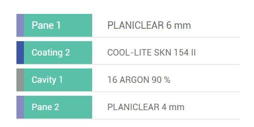

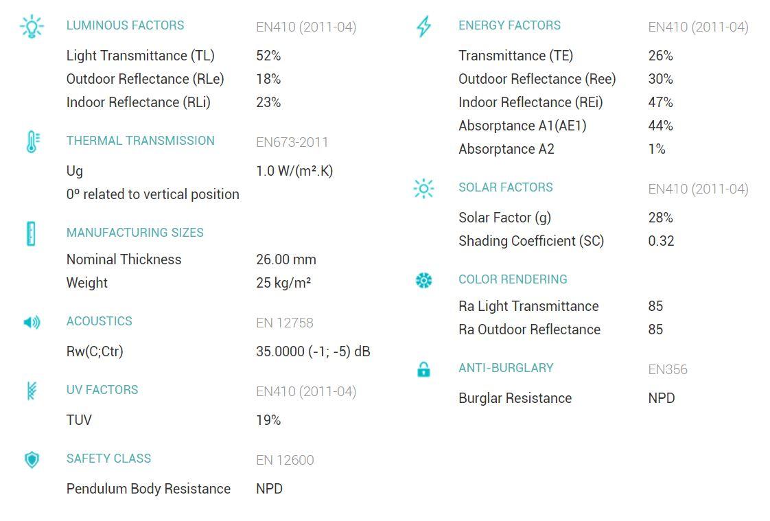

@Jenni there is a spec according to Calumen. Argon helps the thermal performance not the solar.
St Gobain have Cool-Lite, Pilkington have SunCool.
St Gobain spec is below.
