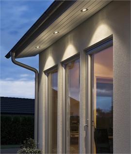

Triassic Posted February 26, 2019 Share Posted February 26, 2019 We’ve been looking a options for the barge boards and soffits and one option being considered is to fix the soffit board directly under the rafter, thus giving us a sloping soffit. Is there any reason why we shouldn’t go with this design? Link to comment Share on other sites More sharing options...
bassanclan Posted February 27, 2019 Share Posted February 27, 2019 Is this what you mean? Link to comment Share on other sites More sharing options...
Triassic Posted February 27, 2019 Author Share Posted February 27, 2019 (edited) I was thinking something more like this, where the soffit board is simple attached to the back of the rafter tails, thus reducing the boxyness of the soffit detail. Edited February 27, 2019 by Triassic Link to comment Share on other sites More sharing options...
Russell griffiths Posted February 27, 2019 Share Posted February 27, 2019 We are having sloping soffits, as it will follow the same lines as the soffit on the gables, personal choice I think. Link to comment Share on other sites More sharing options...
PeterW Posted February 27, 2019 Share Posted February 27, 2019 Only issue is if you use off the shelf components such as UPVC fascia is that they are designed for a 90 degree junction. Would any water or condensation also not run down to the soffit fascia junction and potentially cause issues ..?? Link to comment Share on other sites More sharing options...
makie Posted February 27, 2019 Share Posted February 27, 2019 16 hours ago, PeterW said: Only issue is if you use off the shelf components such as UPVC fascia is that they are designed for a 90 degree junction. Would any water or condensation also not run down to the soffit fascia junction and potentially cause issues ..?? You can get some UPVC that has an angle return made for this type of build. Eurocell used to sell it Link to comment Share on other sites More sharing options...
