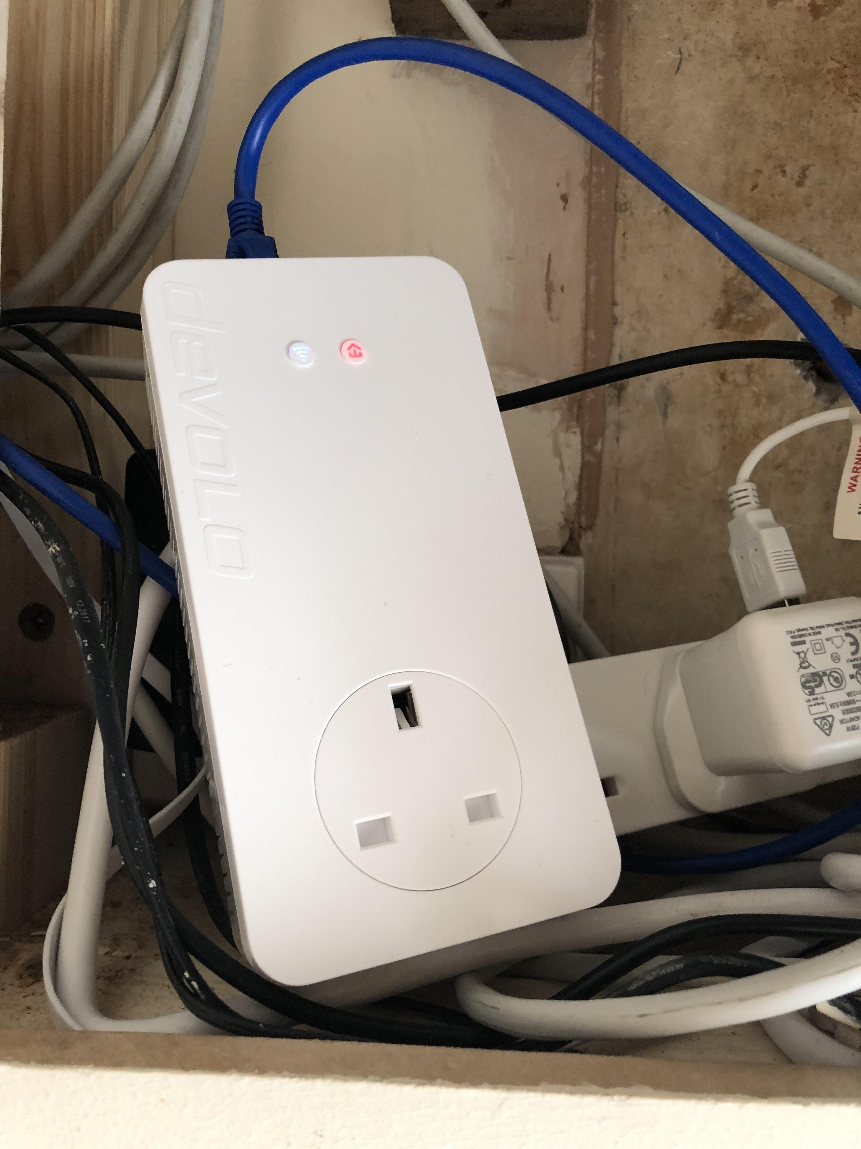

Pocster Posted February 23, 2019 Posted February 23, 2019 Hey So I got rid of my AP units and installed devolo plugs so WiFi is great and a wired connection is available. Today no joy ( been working flawlessly for a month now ) . Main devolo plug wired direct to router always goes to a red ‘home’ light . Suggesting I think low bandwidth. Electrical interference ???? Not sure what the issue suddenly is !!
PeterW Posted February 23, 2019 Posted February 23, 2019 All plugged into an extension lead ..? Could be the problem as I’ve had it happen to me.

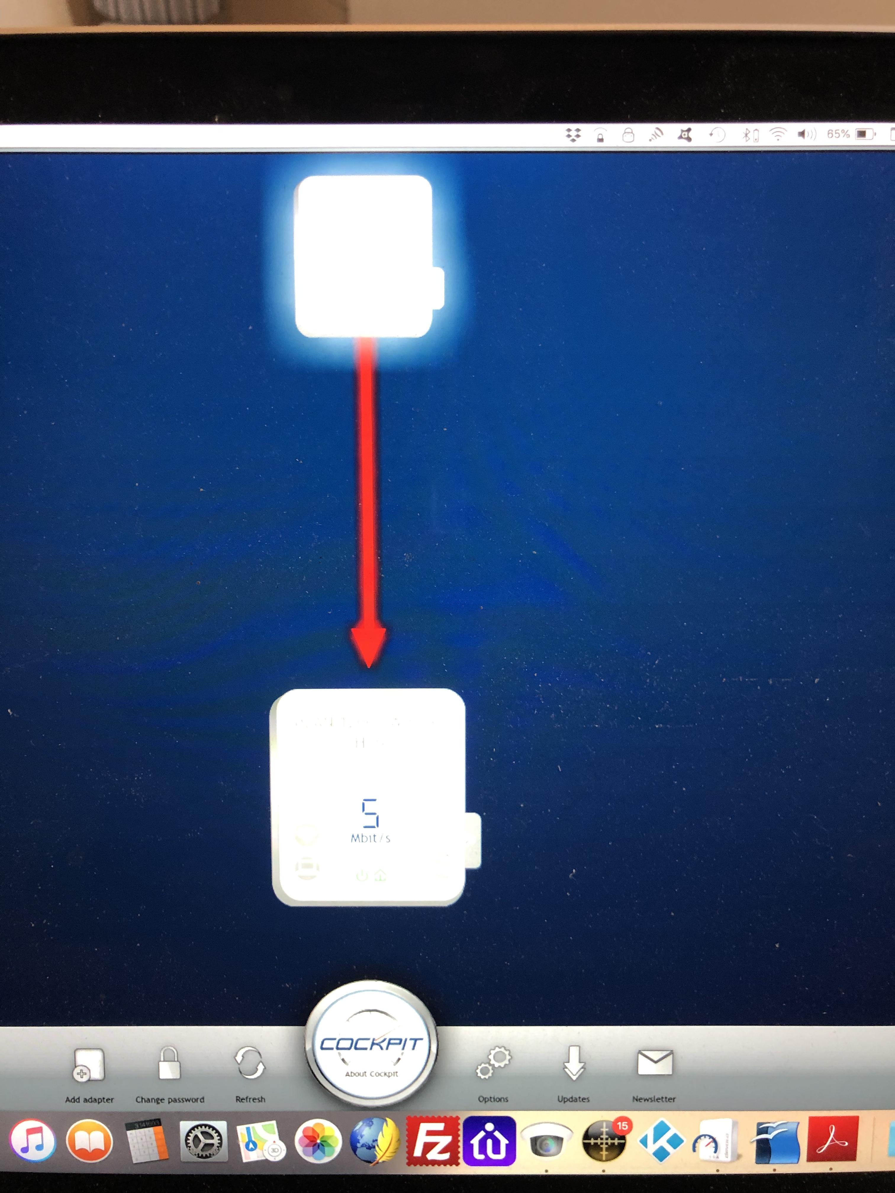

Pocster Posted February 23, 2019 Author Posted February 23, 2019 With just the main plug and one other get poor speed one way . Main plug still flashing red home . Even tried another one there - did the same
Pocster Posted February 23, 2019 Author Posted February 23, 2019 55 minutes ago, PeterW said: All plugged into an extension lead ..? Could be the problem as I’ve had it happen to me. Yeah . I know that’s a ‘bad’ . But worked perfect before . Also the plug socket for reasons unknown upside down so I can’t plug the devolo direct into the socket . i think Monday I’ll plug the devolo direct into a wall socket ( no extension lead ) then run a long rj45 to it .

epsilonGreedy Posted February 23, 2019 Posted February 23, 2019 1 hour ago, PeterW said: All plugged into an extension lead ..? Could be the problem as I’ve had it happen to me. When installing a similar system to an outside garage office I did not believe the instructions that clearly advised against an extension lead, "how could a short extension make any difference I reasoned". The system refused to link via the extension socket whereas a weak link was established via the wall socket. Someone here mentioned additional electrical echos can become established at joints which can degrade signals.

Pocster Posted February 25, 2019 Author Posted February 25, 2019 Well! Got it working but not sure how/why. After messing around I finally removed the main devolo plug from the extension lead. As it can't be plugged directly into the socket (the socket is installed up side down) I plugged it into ANOTHER extension lead on it's own. WORKS! (I think ). 2
