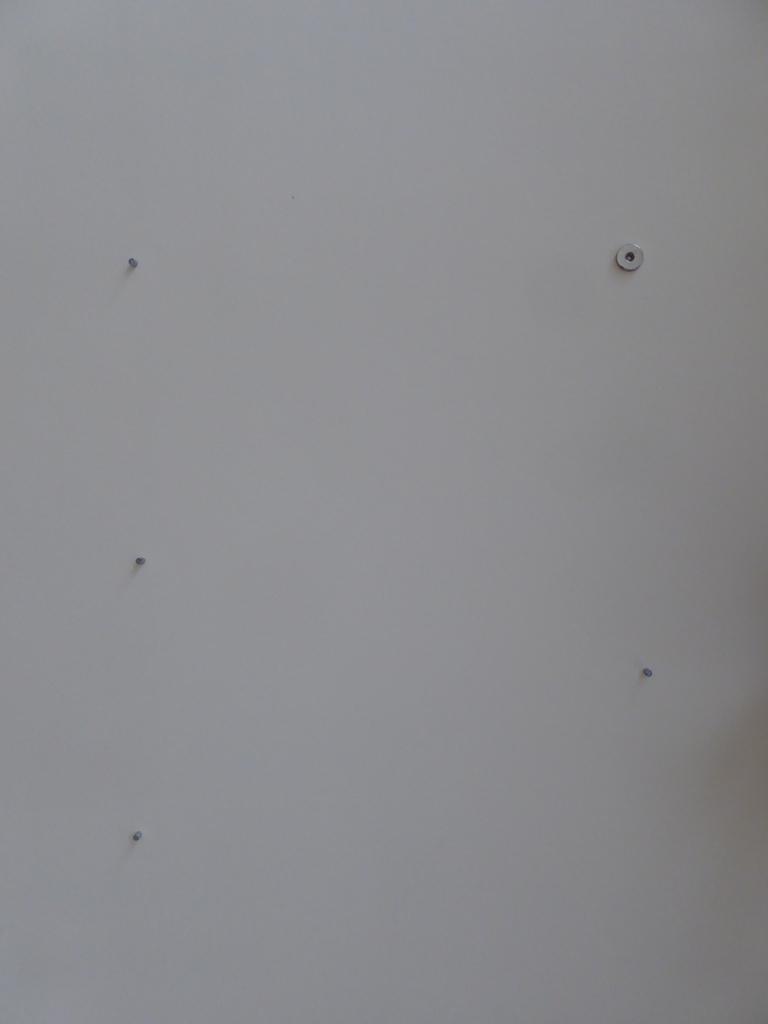

Jeremy Harris Posted February 28, 2019 Share Posted February 28, 2019 Hard to beat a nice strong magnet. I have a reasonably OK stud finder, but I don't wholly trust it, as it can struggle a bit at times. A really strong magnet will reliably find plasterboard screws, and once you have found one of those you can be pretty certain there's a stud or batten behind it. I then use lots of small (around 5mm diameter) magnets to mark the position of every screw head I find. The result is a map on the wall of where the studs/battens are, with no pencil marks anywhere. 3 Link to comment Share on other sites More sharing options...
Jeremy Harris Posted February 28, 2019 Share Posted February 28, 2019 Just stuck some magnets on a wall as an illustration. The big magnet has a hole in the centre, which is just the right size for a pencil (if you want to mark the wall). The smaller magnets are showing the heads of the screws found by the larger magnet. Took me maybe 30 seconds to do this, and most of that was spent finding the first stud (others are easier as you can guess roughly where they will be): 4 Link to comment Share on other sites More sharing options...
