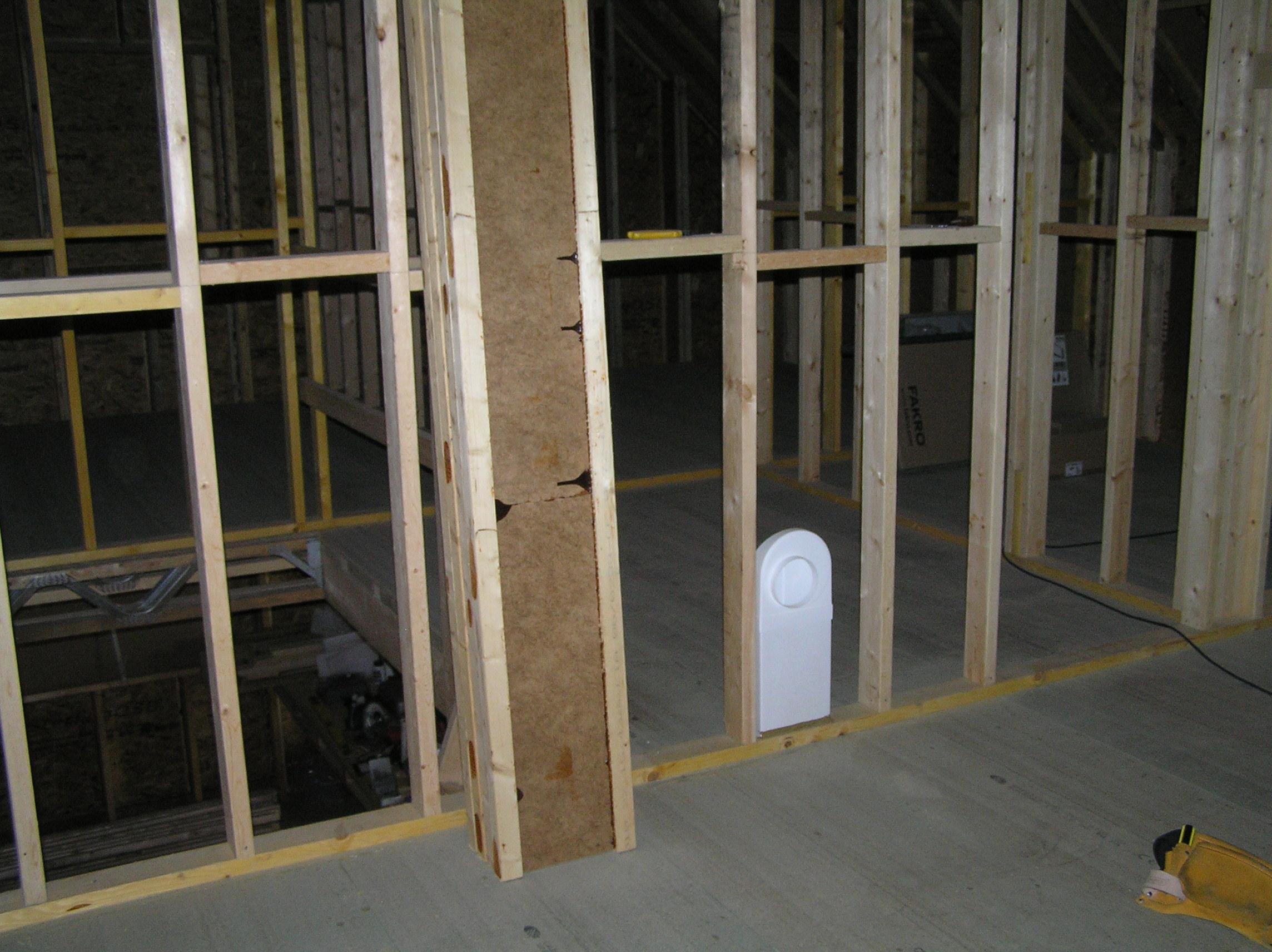

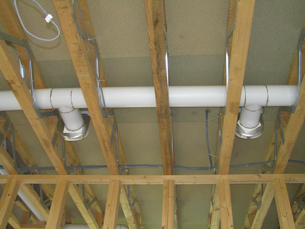

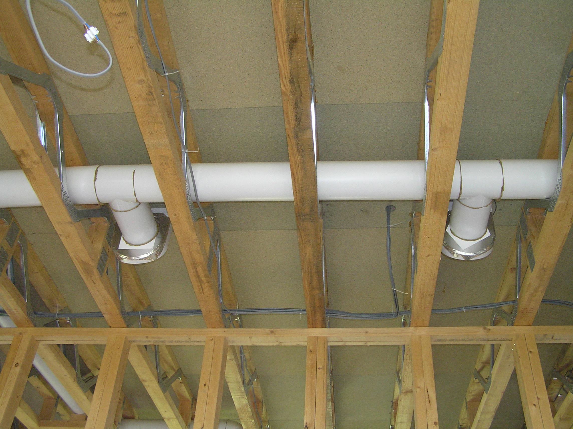

Andrew Posted February 12, 2019 Share Posted February 12, 2019 I'm trying to get my head around how the MVHR ducting should be routed. We're planning to have the MVHR in a downstairs plant room. Running the ducting into the first floor trusses (these are 253mm metal web joists) is straightforward and I guess the ground floor can be easily covered with ceiling terminals. Most of our upstairs rooms have fully vaulted ceilings and I'm struggling to work out how the ducting would make its way to the appropriate sloped ceiling. Do the terminals need to be in the ceiling? Is it possible to route the ducting up through stud walls and terminate in the stud wall? I'm really not a fan of boxing in, so would really like to find a way to route the cables through the fabric of the building. These are probably stupid questions and I confess I'm not fully up to speed with MVHR yet. I've asked for quotes from a couple of the MVHR suppliers which will hopefully give me a bit more to work with. Thanks. Link to comment Share on other sites More sharing options...
Jeremy Harris Posted February 12, 2019 Share Posted February 12, 2019 We have vaulted ceilings and I didn't bother to try and get the MVHR ducting up them at all. We have low walls either side of the upstairs rooms and I just ran the ducting up from the floor to wall mounted terminals in those low walls. This works fine, with the terminals around 4ft off the floor. In the bathrooms I fitted a small false ceiling in the highest corner and ran the MVHR extract ducting along that. 1 Link to comment Share on other sites More sharing options...
Andrew Posted February 12, 2019 Author Share Posted February 12, 2019 3 minutes ago, JSHarris said: We have vaulted ceilings and I didn't bother to try and get the MVHR ducting up them at all. We have low walls either side of the upstairs rooms and I just ran the ducting up from the floor to wall mounted terminals in those low walls. This works fine, with the terminals around 4ft off the floor. Thanks Jeremy - it's the getting up through the floor into the wall bit I can't visualise. Are those internal or external walls? Is it just a case of drilling through the centre of the stud attached to the floor and then taking the duct up through the internal wall? Link to comment Share on other sites More sharing options...
Big Neil Posted February 12, 2019 Share Posted February 12, 2019 If you didn't have Vaulted ceiling, i assume the easiest thing to do where it wouldn't 'look' like boxing in, would be to run them up the back to say the airing cupboard into the space above and then just board over so it is a false wall , such that it wasn't obvious? Link to comment Share on other sites More sharing options...
Jeremy Harris Posted February 12, 2019 Share Posted February 12, 2019 9 minutes ago, Andrew said: Thanks Jeremy - it's the getting up through the floor into the wall bit I can't visualise. Are those internal or external walls? Is it just a case of drilling through the centre of the stud attached to the floor and then taking the duct up through the internal wall? They are internal stud walls with just a storage area behind, so the ducts run up inside the storage area to the wall-mounted terminals. It would have been easy enough to just fit the slimline oval semi-rigid duct inside the stud walls though. Someone here has used that I seem to remember, and posted photos of the ducting inside the wall. The oval semi-rigid ducting is 51mm x 138mm, so will fit in spaces where the round stuff is just too big. IIRC there are adapters to allow conversion from the oval section to the round section stuff. Link to comment Share on other sites More sharing options...
Andrew Posted February 12, 2019 Author Share Posted February 12, 2019 1 hour ago, JSHarris said: They are internal stud walls with just a storage area behind, so the ducts run up inside the storage area to the wall-mounted terminals. It would have been easy enough to just fit the slimline oval semi-rigid duct inside the stud walls though. Someone here has used that I seem to remember, and posted photos of the ducting inside the wall. The oval semi-rigid ducting is 51mm x 138mm, so will fit in spaces where the round stuff is just too big. IIRC there are adapters to allow conversion from the oval section to the round section stuff. I did see the oval stuff and wondered if it would go through stud walls fairly easily. Thanks again - I can see how this could work now. Link to comment Share on other sites More sharing options...

Gone West Posted February 12, 2019 Share Posted February 12, 2019 4 hours ago, Andrew said: I'm trying to get my head around how the MVHR ducting should be routed. We're planning to have the MVHR in a downstairs plant room. Running the ducting into the first floor trusses (these are 253mm metal web joists) is straightforward and I guess the ground floor can be easily covered with ceiling terminals. Most of our upstairs rooms have fully vaulted ceilings and I'm struggling to work out how the ducting would make its way to the appropriate sloped ceiling. Do the terminals need to be in the ceiling? Is it possible to route the ducting up through stud walls and terminate in the stud wall? I'm really not a fan of boxing in, so would really like to find a way to route the cables through the fabric of the building. These are probably stupid questions and I confess I'm not fully up to speed with MVHR yet. I've asked for quotes from a couple of the MVHR suppliers which will hopefully give me a bit more to work with. Thanks. We have vaulted ceilings and took the ducting up through the stud walls upstairs. We also have 250mm metal web joists and used 125mm ducting rather than a manifold system. The rectangular ducting we used was 204mm x 60mm. 1 1 Link to comment Share on other sites More sharing options...
